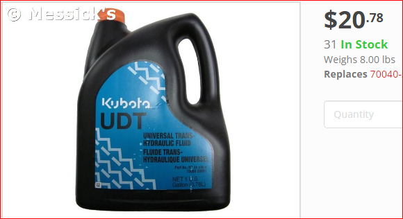

as others said - the UDT in the tranny/hydraulics....... and 80w90 in the front end.
you can still get the UDT from your dealer or online - about 5 bucks a quart.
