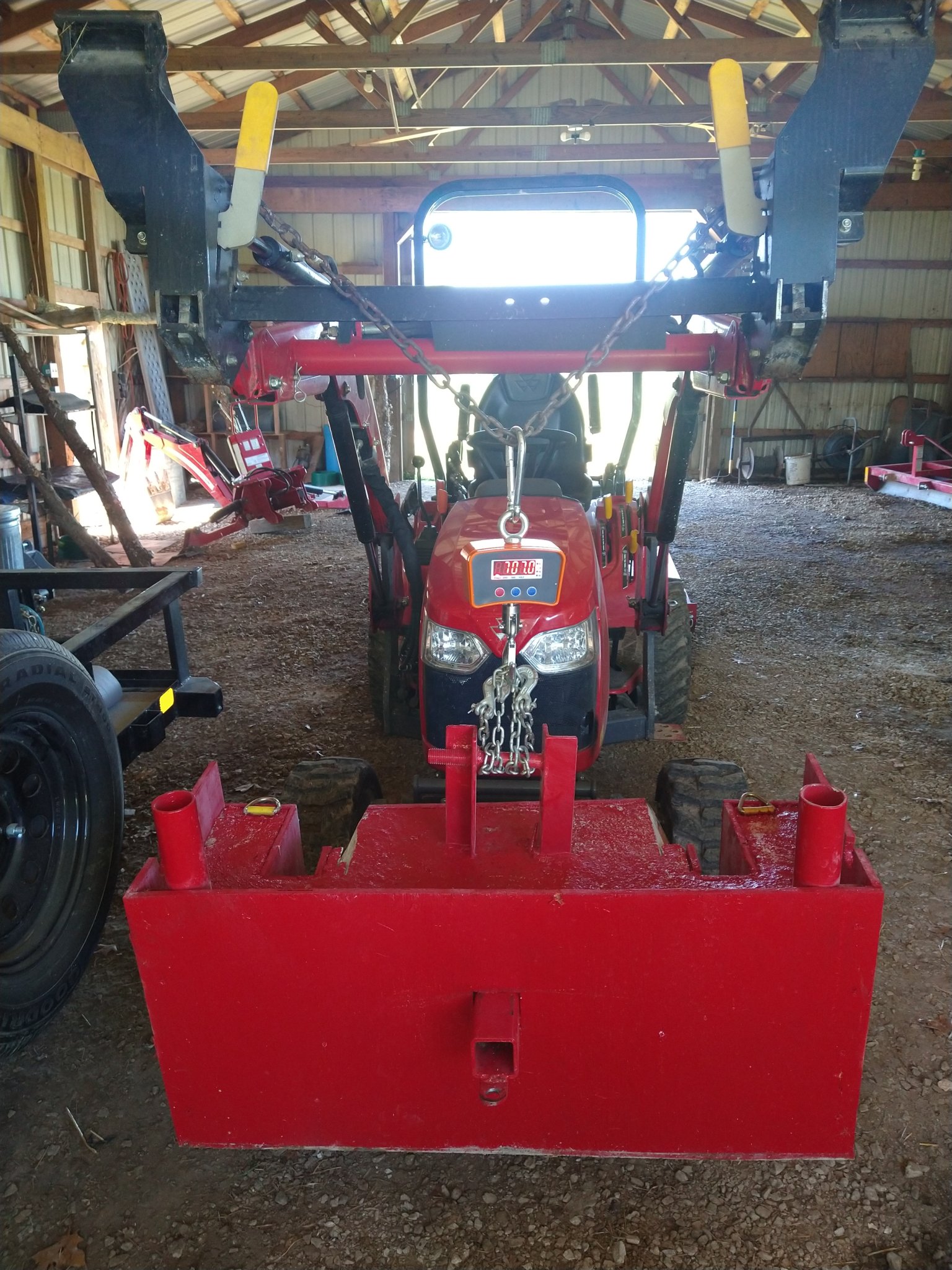

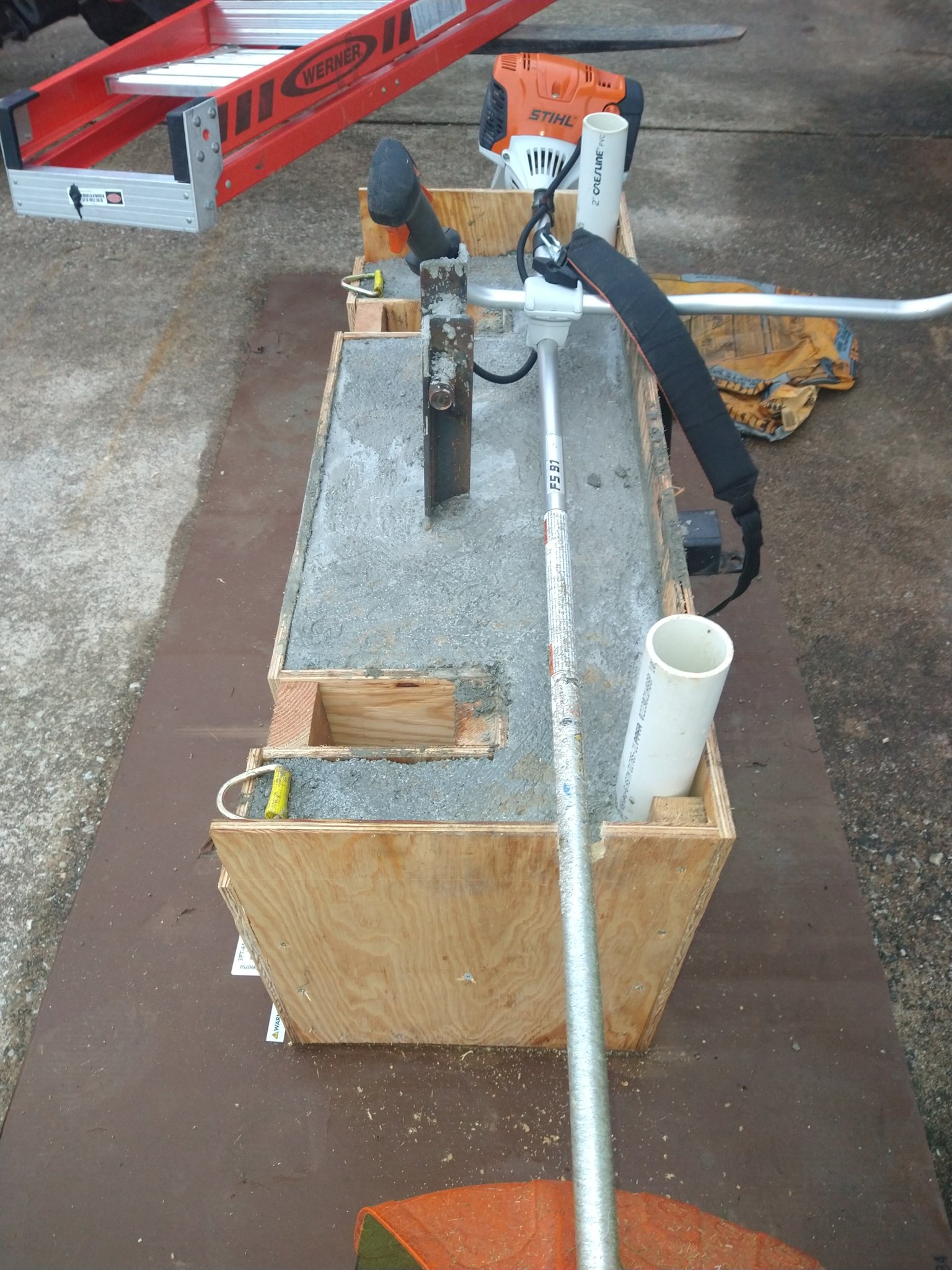

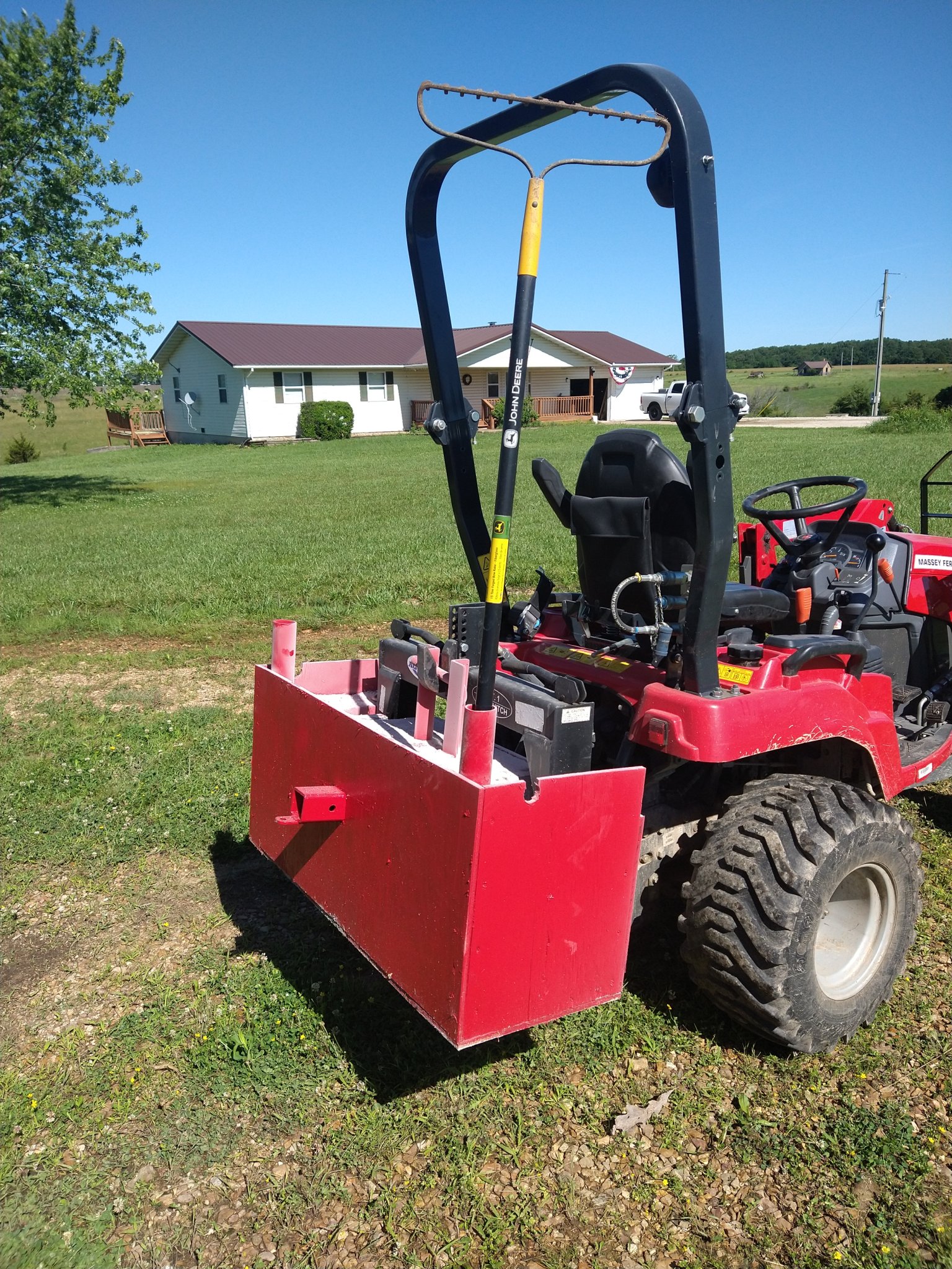

I built my own for my SCUT ... Sheet of plywood, 6 - 80 Lbs bags of concrete, quart of paint, scrap I had ...
I left the side and rear plywood "high" to make a box, and cutout the sides to drop my trimmer in ...
707.0 Lbs!
