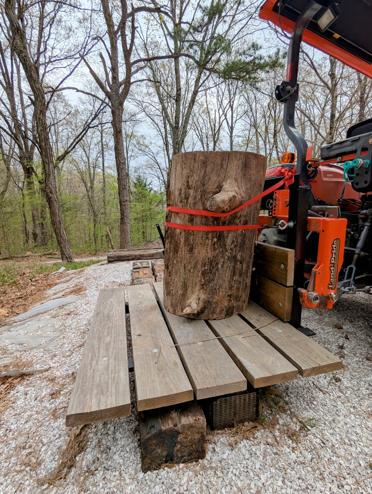

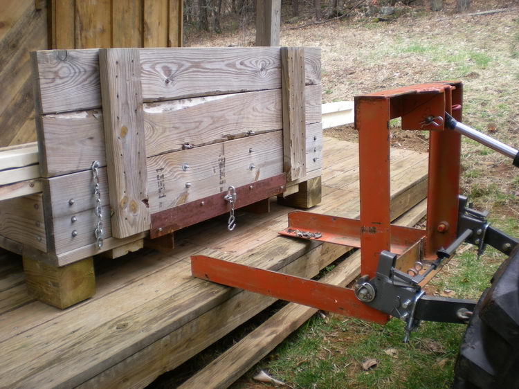

carryall and a skid with a box on it,you fill with 'ballast'. I have 2 skids, light and heavy. light for mulch/compost loads, heavy for dirt/gravel/patio stones.
install carrayall then slide up light or heavy as required

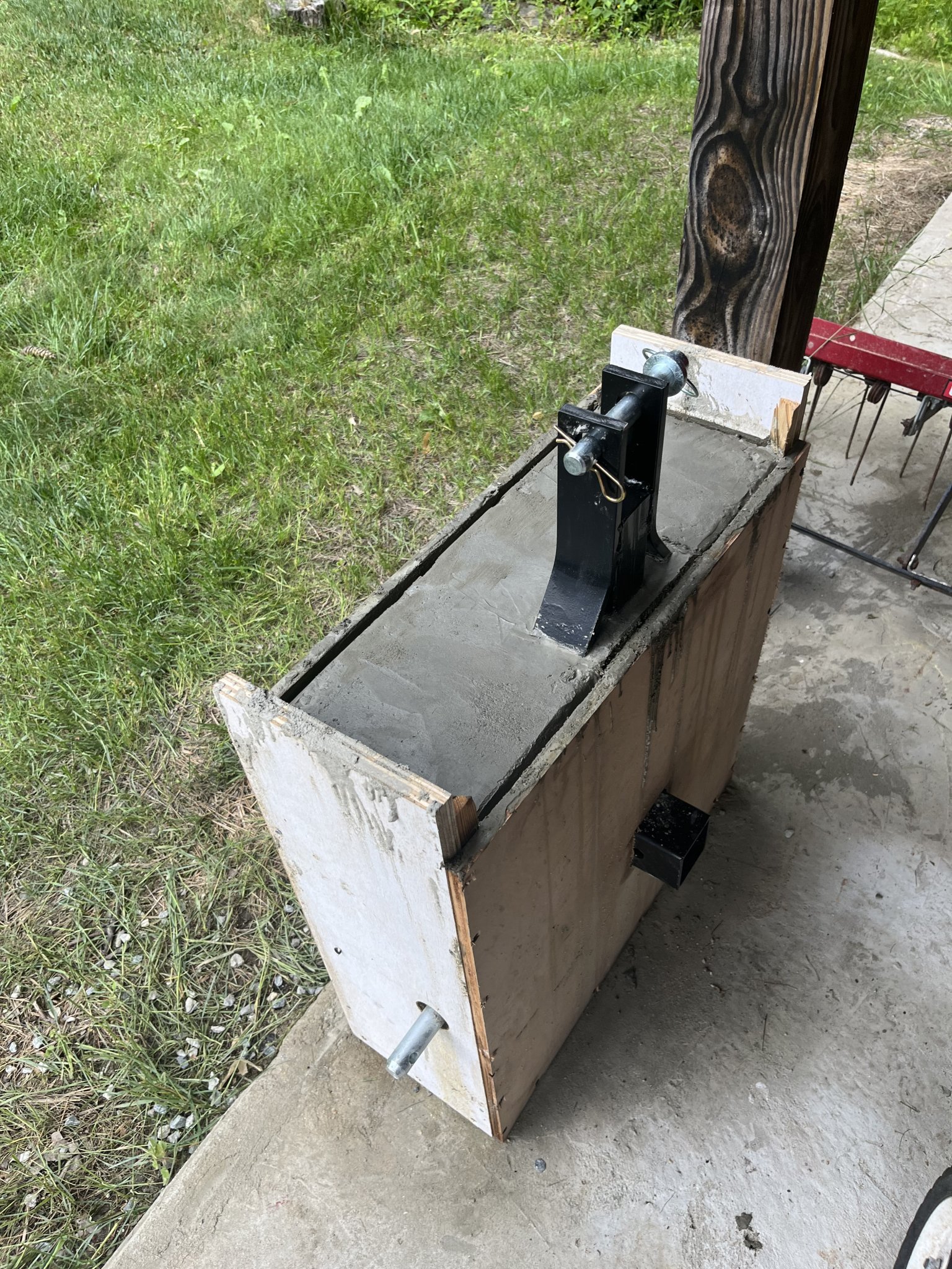

I welded up a 3 point "carry all". Great project to learn to weld, used scrape angle iron... Did not plan on it (basically a "Happy Accident") that a 55 gallon drum was a great fit!!! I first started out making a carry-all but I wanted to be able to drop my tools off and be able to drive the tractor.
I needed a counter weight and since the 55 gallon drum fits, I filled it with old, dried bags of concrete (neighbor wanted them gone!) One strap later, it's good to go!!! The drum now had the PVC pipes removed, filled the rest of the space to the top with rocks, and used a manhole cover on the very top (also prefect fit!!) No photo of the final drum :( may be one day.

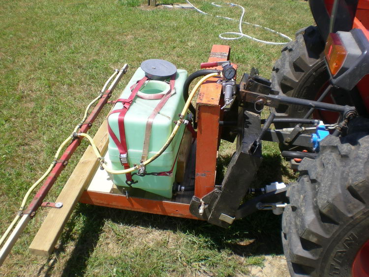

Like a sprayer? I mounted this sprayer to be in sections onto the carryall frame. It takes a little longer to assemble but it disassembles for easy cleaning and storage!!!
