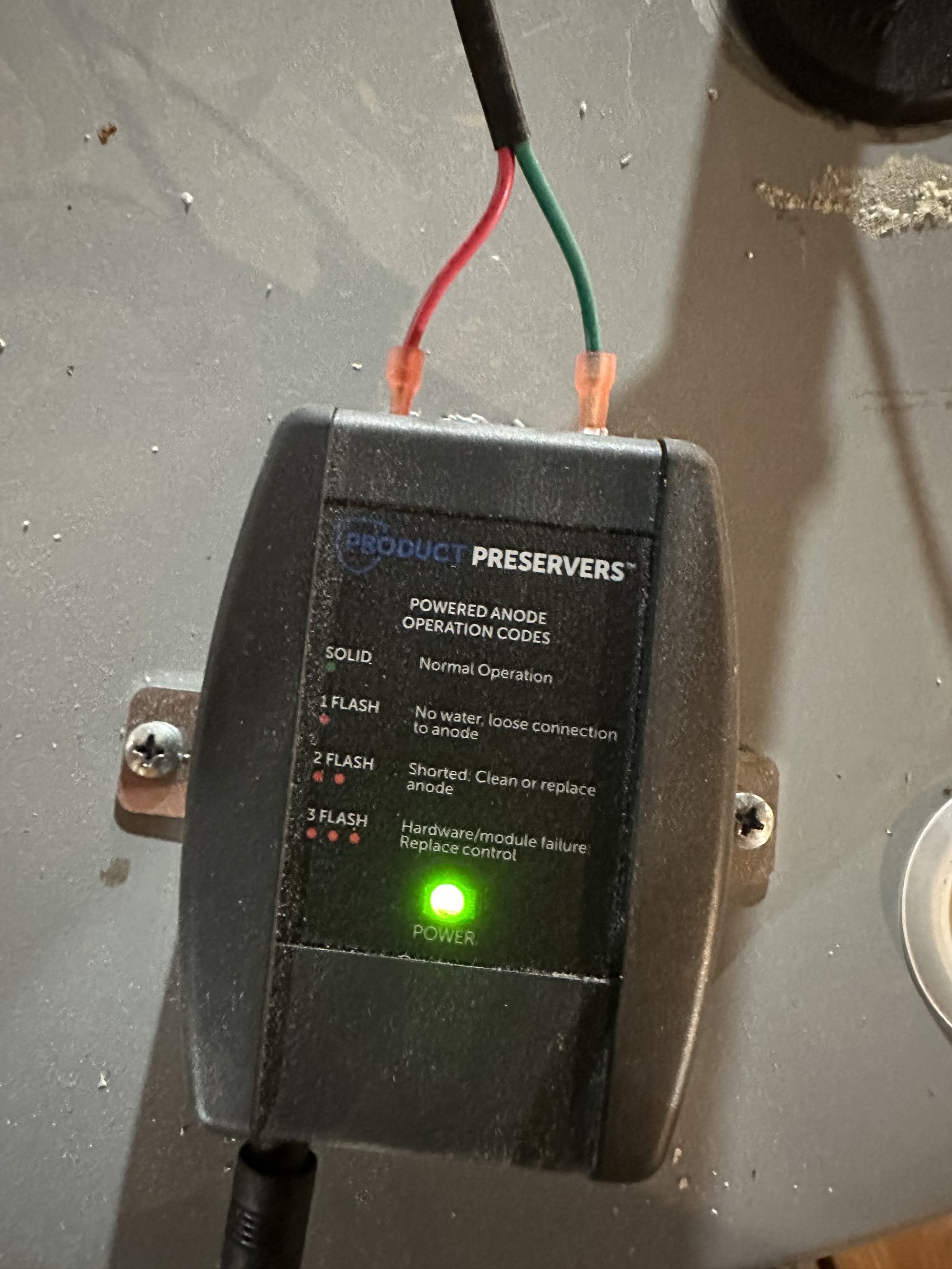

Yeah. It has me questioning a lot on this install. Tank is now 5 yrs old. The box up top is an electronic anode. With our well water the conventional anode does not stop the wonderful smell off the hot water. With the electronic unit, smell is gone. All my water lines are Pex so the copper does the Union to the Pex. I’m thinking they saved a couple bucks and skipped the dielectric unions. Interesting thing is the install manual for the unit says to use the Teflon tape to prevent the corrosion from happening and does not call out using the unions hence my title for this thread. As for tightness, on the original it was on that copper only around 1/16th of an inch. Not much of a seal. Had a good amount of rust built up between the top of the nipple and the copper. Need to source a dip tube for the cold side and then have more fun.

BTW, which powered anode did you go with? We have the well water potpourri during the rainy season. Only the hot side. Was thinking about getting one myself but sounds like witchcraft. Lol.

I’ve tried a couple with good results. I did lose my first when we got struck by lightening. The first one had a spring you had to stretch to fit the depth of the tank. Replacement I got wouldn’t calibrate so I went with this one from AO Smith and has set lengths. Worst part was digging out 3” of foam to get to the rod. No calibration required.

Thank you. I was looking at Corro-Pro-Tec. AO makes the water heater so maybe I'll go that route.
