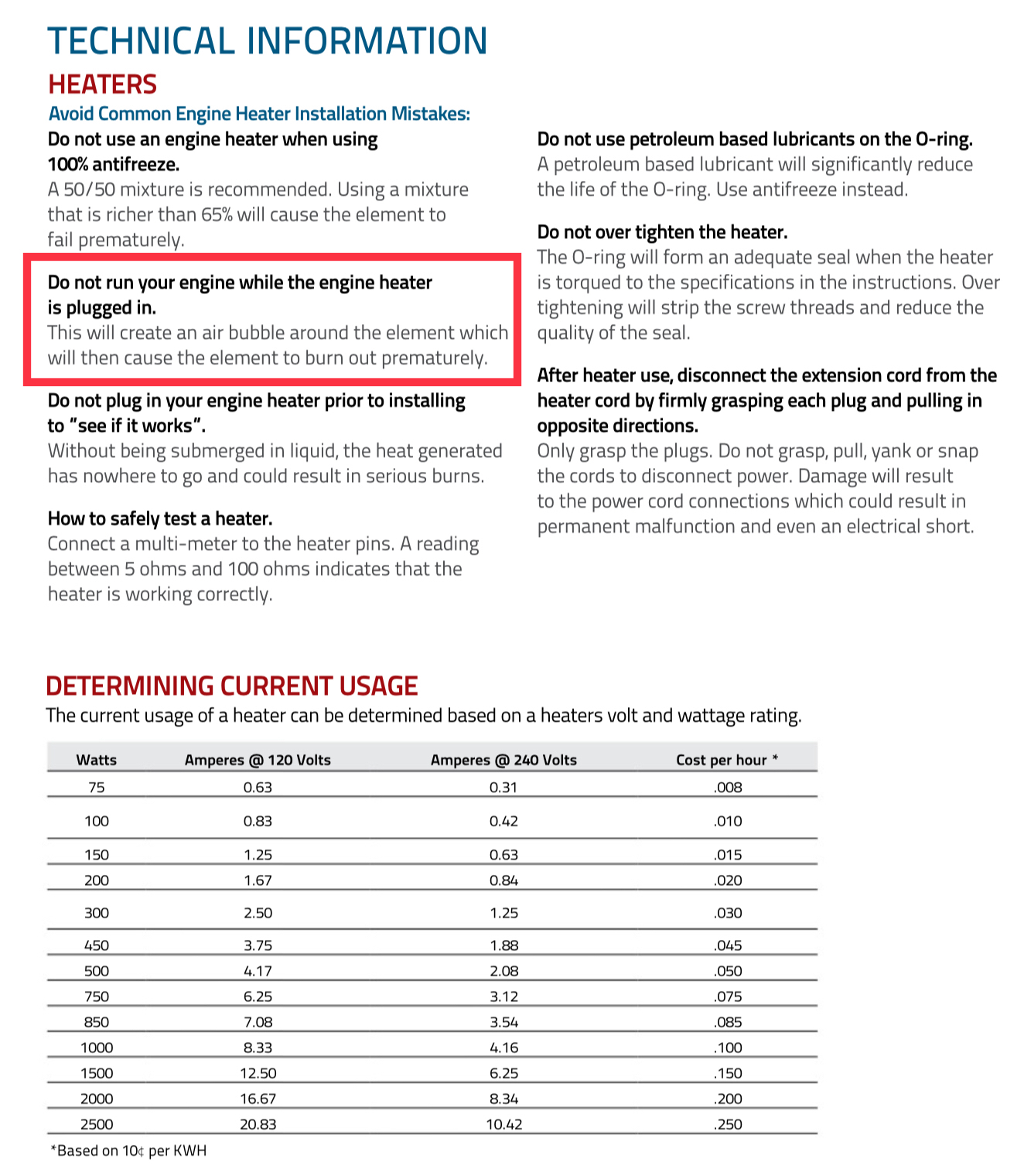

The image below is page 177 from Phillips Temro's Technical information book:
7,107
9,716
Seriously, the use of the term "air bubble" is questionable here and doesn't fill me with confidence. Notice also that their only concern about plugging a heater in that isn't submerged in a liquid is the risk of causing burns. Nothing about the likelihood of damaging the heater. The heater that's supposedly damaged while immersed in coolant with the engine running.
So is the theory that coolant flow causes a region of low pressure on the downstream side of the element which causes a water vapor bubble to form? If so, that's a plausible explanation but it's highly dependent on flow rate, heater geometry, cooling jacket geometry and coolant temperature, not to mention time.
The liners in diesel engines are subject to cavitation erosion due to water vapor bubbles forming in regions of low pressure and then collapsing. This is why diesel engine coolant is often specific or proprietary.
