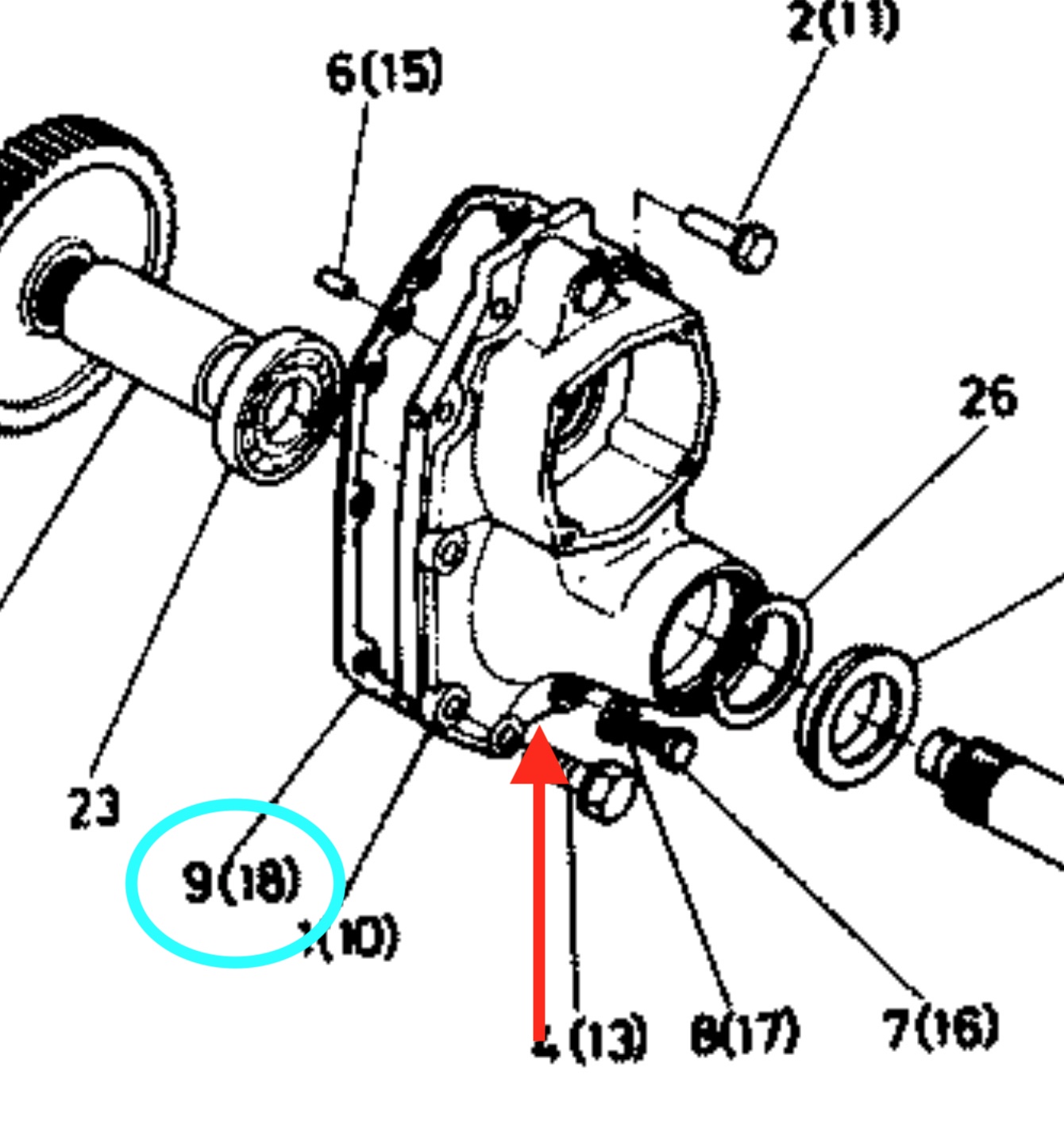

Noticed a pretty severe oil leak coming from the B7100 this past week.
It appears that a small piece of this gasket (lt blue oval) has dropped out in the area of the red arrow.
Leak is approximately one drop per sec cold, faster when hot.
Seems like a pretty easy fix, ONCE YOU REMOVE ENOUGH PARTS TO GET THERE.
It appears I will have to drain the oil, remove the backhoe, the backhoe subframe, the front loader, the front loader subframe, the rear wheels, rear wheel weights, the fenders, the seat, brake linkage, and I'm sure some other stuff too.
And, if I have it that far apart, I may as well split it & put in a clutch & related parts also. (clutch has been marginal since I bought it)
Maybe I should also look into that noisy transmission shaft bearing rattle also.
Crap.

Hate to hear that. Check that area real good. I've sold a few axle housings that were cracked in that area and were leaking.
Why would you sell a cracked axle housing? I believe that what you meant to say was that you have sold a few axle housings to replace ones that were cracked in that area. The real question is, why are they cracking in that area?
If the truth were known I'd wager wheel spacers account for some.
7,515
2,545
50% old age
50% water collects at the bottom of the case and then freezes and cracks the case.
Pretty sure it is not water freezing recently, as I am pretty fanatic about oil being clean, and the tractor lives indoors in Arizona.
But it is certainly possible from the PO, who left it outside all the time. When I got the tractor, I drained about a 1/2 cup of water from transmission drain under the shifter. (no shift boot)
Maybe it froze & cracked back then, and just got worse recently.
It has had a small leak there since I bought it.
I will keep hoping it isn't cracked.
