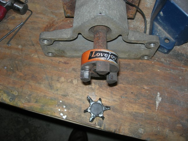

Rust Addict
B6000E
Jan 2, 2010
Sidney, Maine, USA
Not so sure you need OEM parts to get the front PTO. Find the electric clutch unit and work backward into the crank shaft or pulley. The lovejoy is a wear point, this is good, you don't eat up spline connections and provides a little dampening for the engine with your attachments stall out. Pics are from some maint. work last season. The B6000's run the belley mower and snowblowers using the front PTO.
