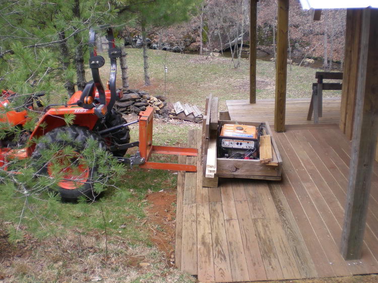

You could get a 3 pount "carry all" for fairly cheap and load cinder blocks. There are also 3 pount forks you can use in a similar manner. The forks can at least be used for more than just carrying weight.
But.....add up the $ of the attachment and cinder blocks, and you might be close to a 1260 BB
old and tired
L2800 HST; 2005; R4
That was how mine started out, a carry-all, welded some "forks" together, which was the platform for a carry-all; weight box and a sprayer as well...
Got tired of switching things around... The carry-all, I can drop it off at a work location and still have my tractor free to use...

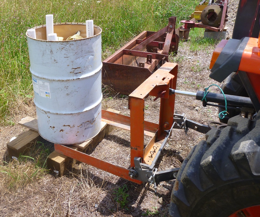

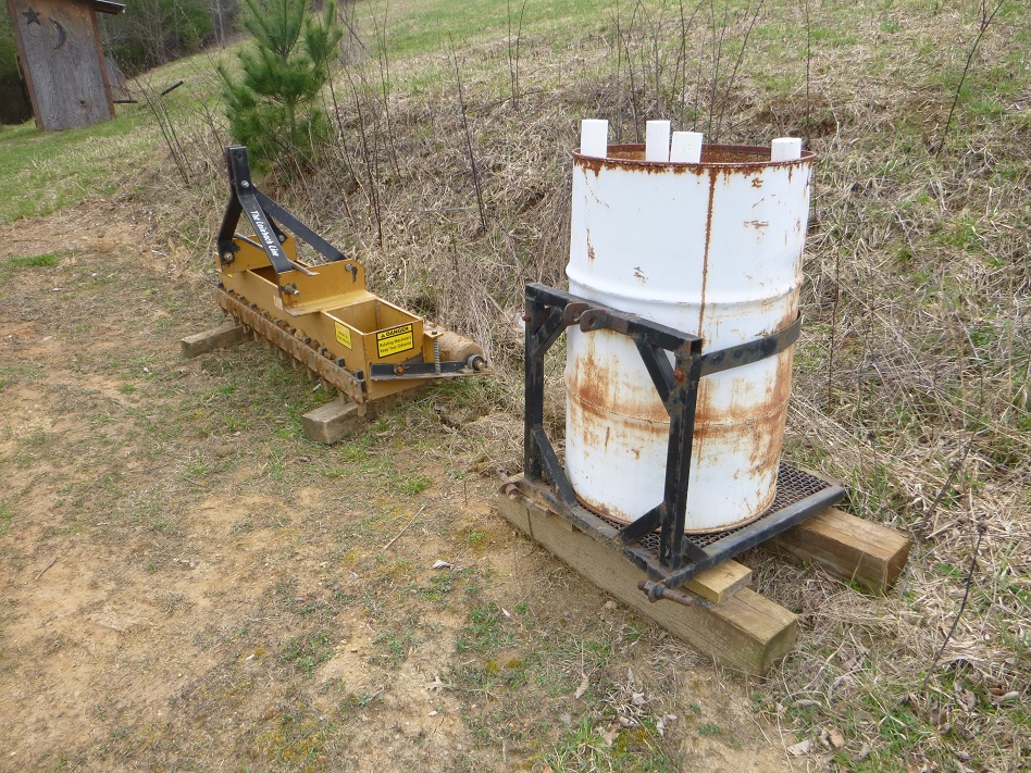

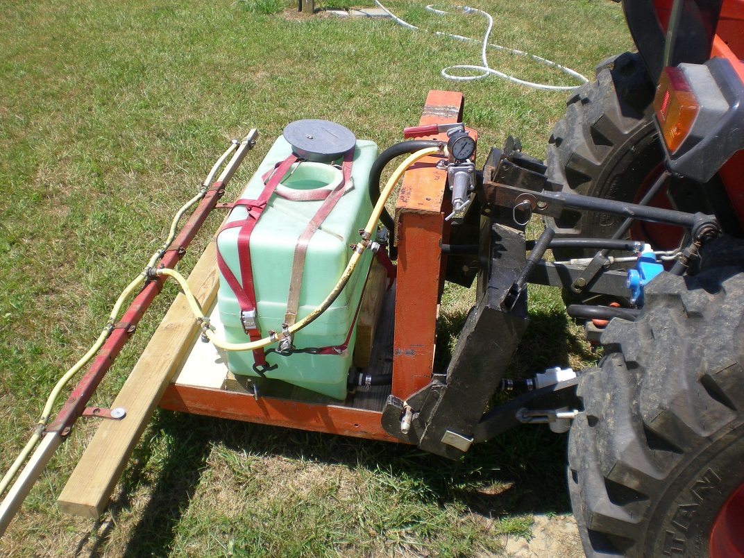

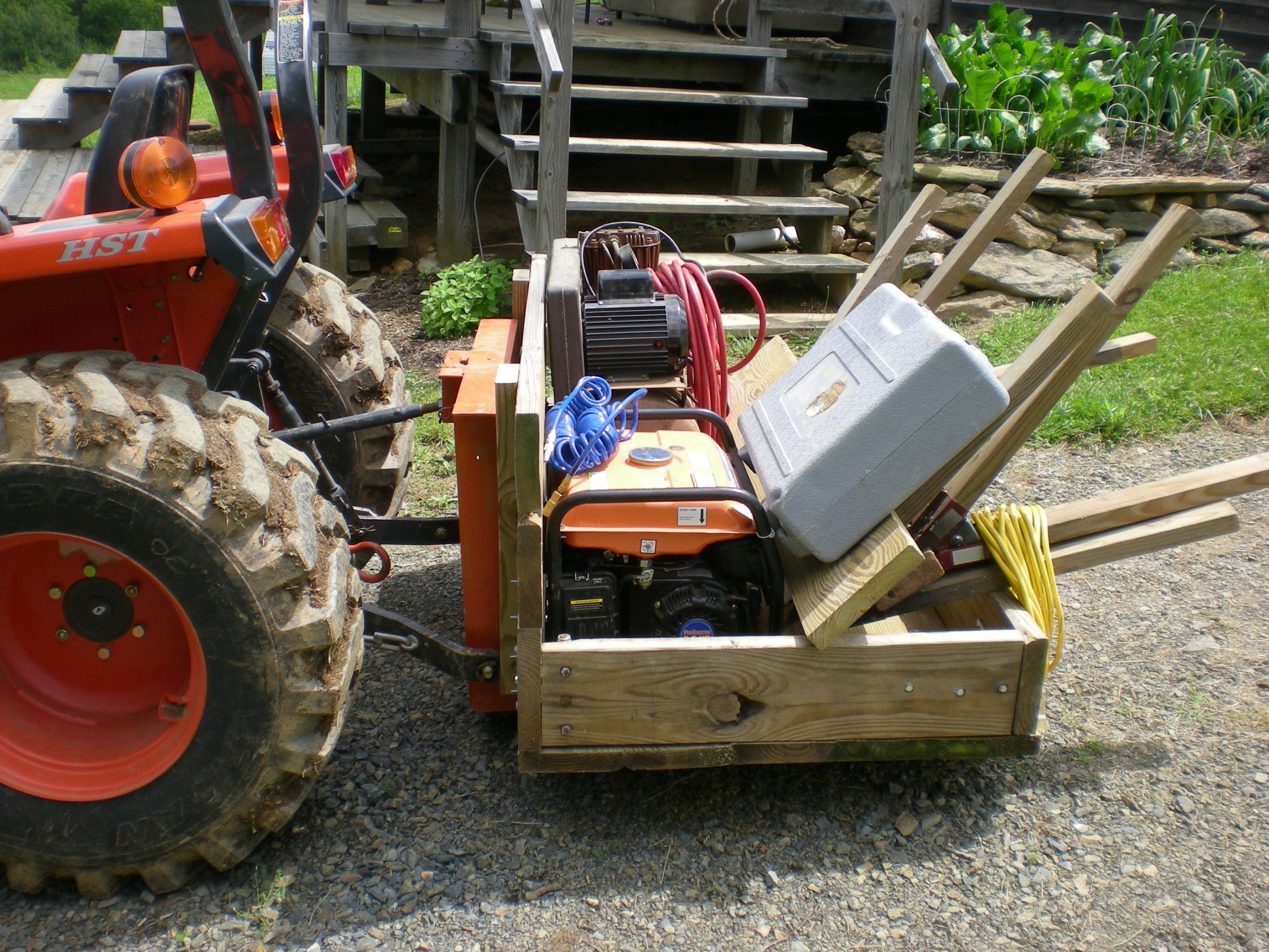

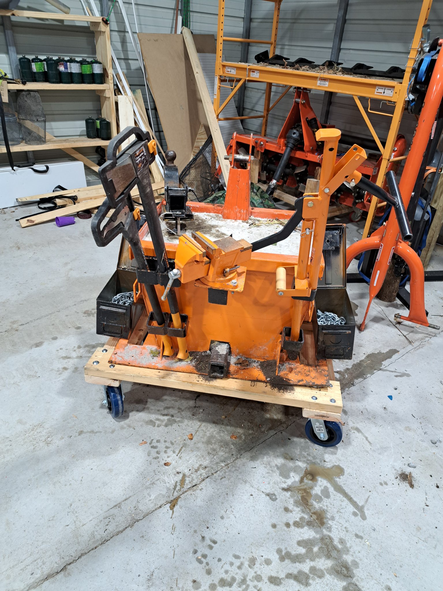

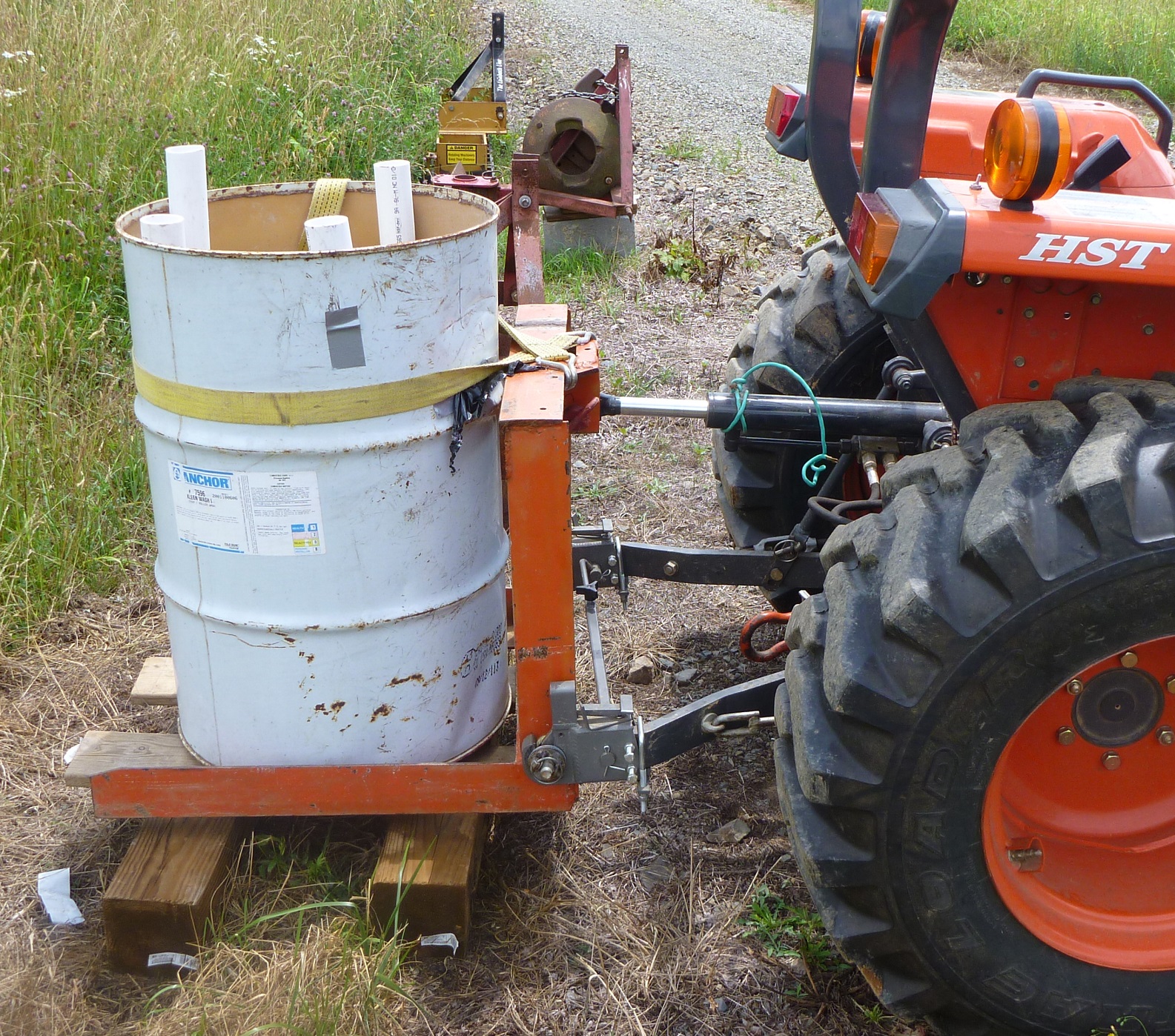

Rip, how handy are you?
That will make a difference.
For instance, I can envision a Box Blade with suitcase weights that fit into the BB to reduce length.
However if you don't need a grading function, you could make up something like my "Swiss Army" ballst box.
Fun project, but my BH77 is on 90-95 percent of the time.
Edit: Oh yea, if you're gonna go the "Swiss Army" route, Don't add wheels to the bottom of the box.
Mine lasted about 3.4 minutes before I backed up into a "bump" and ripped them off. LOL

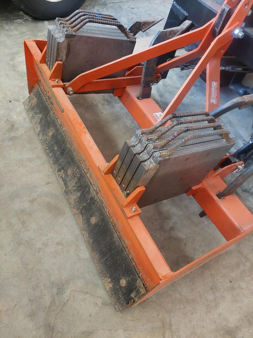

This is what I use as counterweight on the back of my BX, 8 homebrew 42# weights. Just need to get some paint on them this winter.
