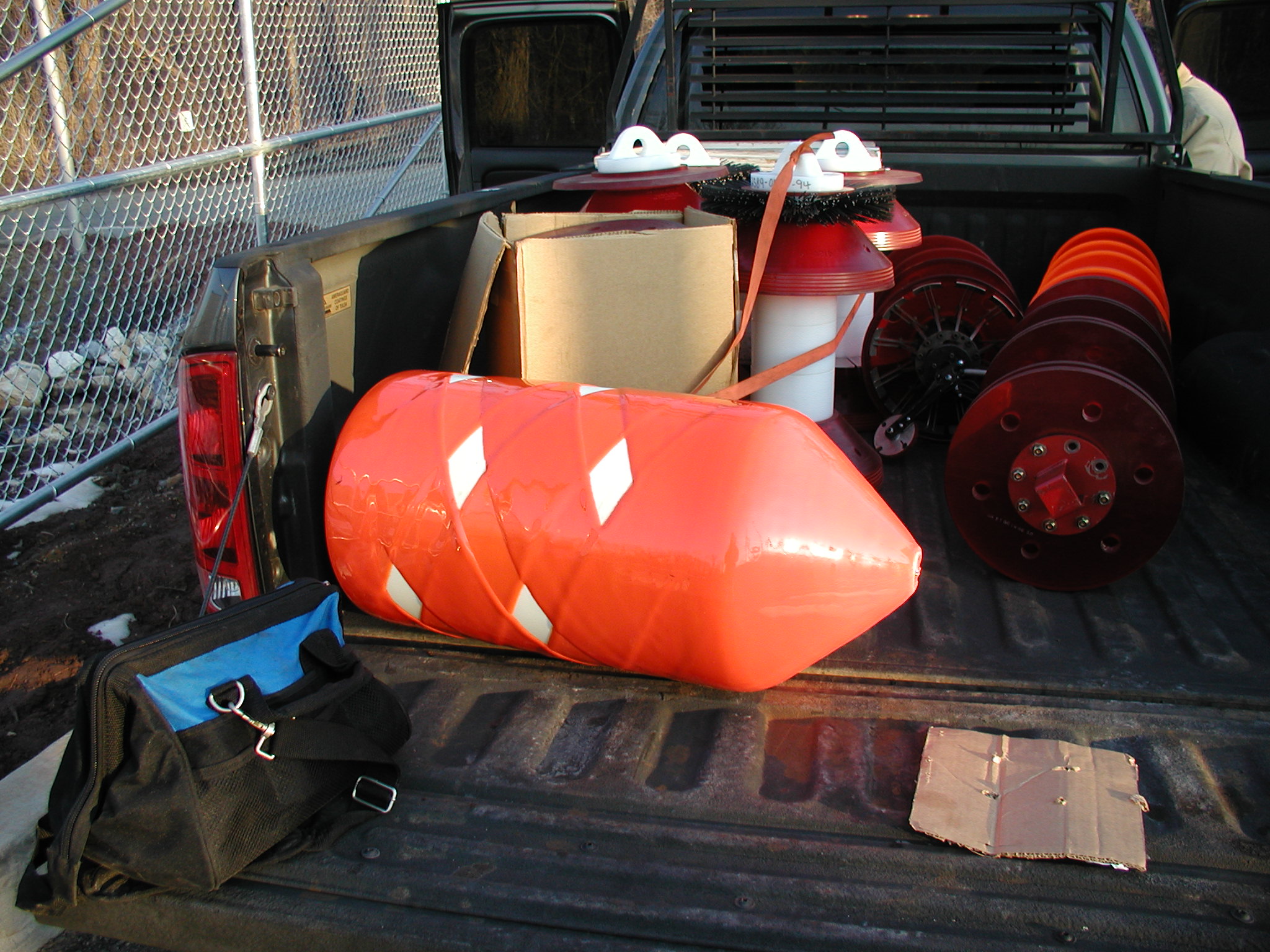

With your background you probably recognize something we had a chance to play with:
I'm getting the pig...
Name that movie!
I had an ugly, amusing now, encounter with one of those things early in my career.
