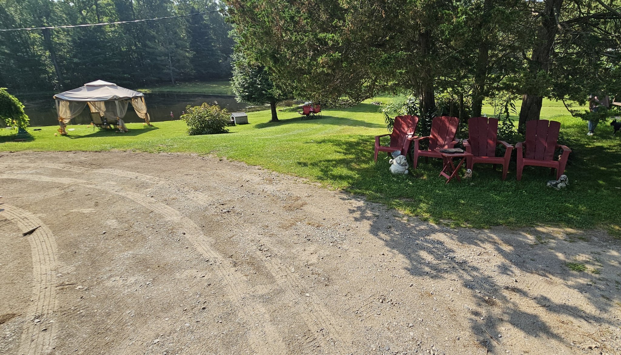

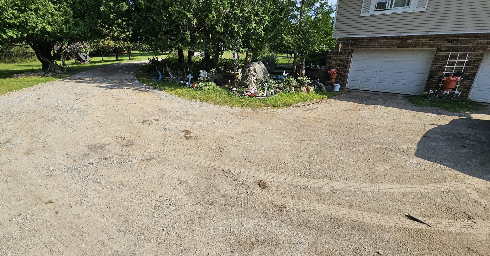

I have elderly relatives that don't have the resources to do the work themselves or to hire someone to take care of their gravel driveway, so I volunteered. My understanding is that nothing has been done in 30 years and it shows, many deep potholes along with crevices from running water.
I've never done this type of work, I did my best using what I had on their 300-400 foot driveway, a box blade. My understanding is that when there's potholes, one needs to grade to the depth of the pothole and that's what I did. While grading, I noticed that there was a very thin layer of gravel, mostly dirt mixed in. in the end it looked much better than it was and one can actually drive on it now.
The continuing issue is water running down the drive, into the parking area and into the garage. It appears from the first image the driveway is lower than both areas to the sides and acts as a channel for the water. I was told that there once was a berm where the blues lines are, it disappeared long ago, the idea was to direct the water to the left of the image, that didn't work out well because it forced water into a pole bar.
My questions are:
#1 what type of gravel do we need to put on top for here in Michigan, most of what's remaining is just dirt with a little bit of gravel mixed in.
#2 How do I grade the driveway to keep water from running down the drive into the parking area and in the garage. In the third image, from the parking area, the yard runs downhill into a pond.
#3 What would be the best approach to fix this going forward, culverts, drain tile, etc??

You describe water running down the middle of the road. I'd suggest lowering the outside edge of the drive on both sides by dragging the material to the center. This does two things. Begins to form a slight ditch for water to stay off the road, and adds material to the center where you need it.
If you need a culvert across the road don't use corrugated metal unless you have it laying around. Use the double wall smooth PVC. The big advantage of the smooth interior is material doesn't build up in it like the corrugated does. It just stays cleaner.
After you have the drive the way you want it, then determine if you need more rock. The driver should be able to lay the rock however you want it, requiring very little if any tractor work.

First, you did a great job grading... If you are going to be adding gravel to the driveway, I would work on the driveway and shape it with what you have on hand (dirt and a little gravel) then add good gravel as a finishing touch.
I can't comment on gravel in your area - I use Crusher Run (3/4 minus). You want "fines" to compact down.
I would cut in ditches (even small ones work) on both sides (use that dirt to raise the middle of the driveway up). Put a proper crown on the driveway so water runs into the ditches...
I've used both 6" and 8" PVC pipe to move water from one side, to the other side of my driveway. I got them for free, schedule 40, 20' long pipe, and I had it on hand. I would dig a deep bowl area before the opening of the pipe (to collect sediment and only let water through the pipe).
I used the FEL to dig the pipe down a few inches (6"-7" deep) which also makes a raised water bar on the surface. I angle it across - about 30° and make sure it slopes downhill!
I usually let it rain on the dirt driveway a few times, I'll walk it in the rain to make sure water it doing what I want it to do BEFORE I put down any gravel! Easier to correct any problems (so you don't waste gravel).
Good luck, there are MANY threads about building driveways/roads on this site!! Most of them will tell you to fix water issues first!!
PS... and yes, you repaired the potholes correctly, digging until you are below the bottom of the pothole.
