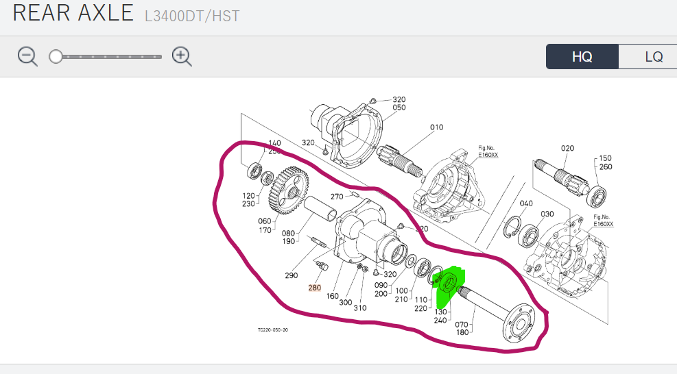

North Idaho Wolfman Moderator Staff member Lifetime Member Equipment L3450DT-GST, Woods FEL, B7100 HSD, FEL, 60" SB, 743 Bobcat with V2203, and more Jun 9, 2013 30,543 6,595 113 Sandpoint, ID Nov 30, 2024 #2 Not much of a concern on the seals leaking, but an easy fix. I would buy it without any worry. Reactions: 1 user
