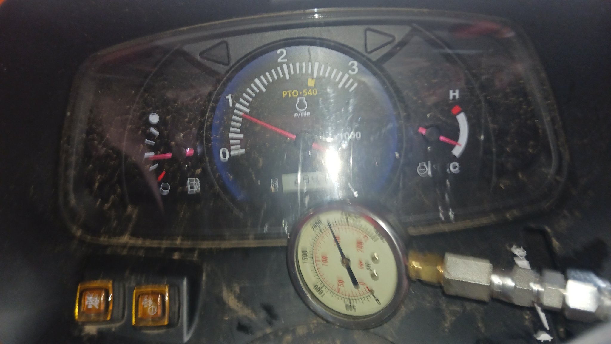

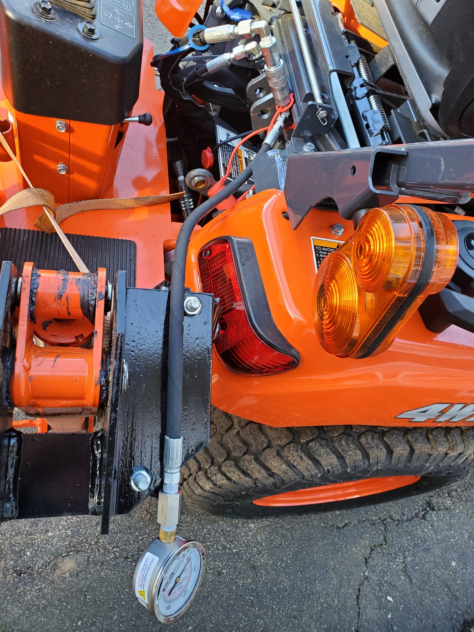

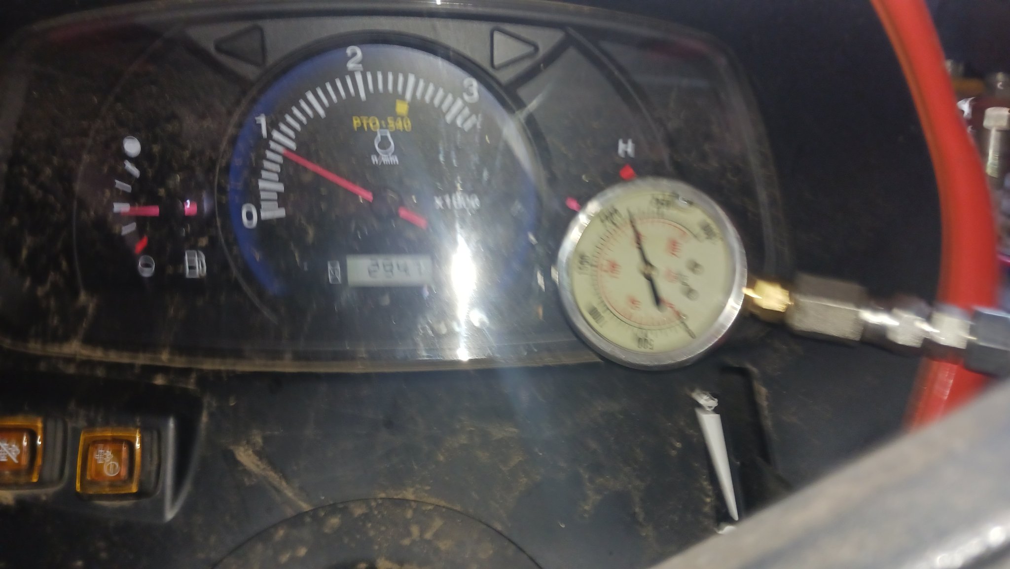

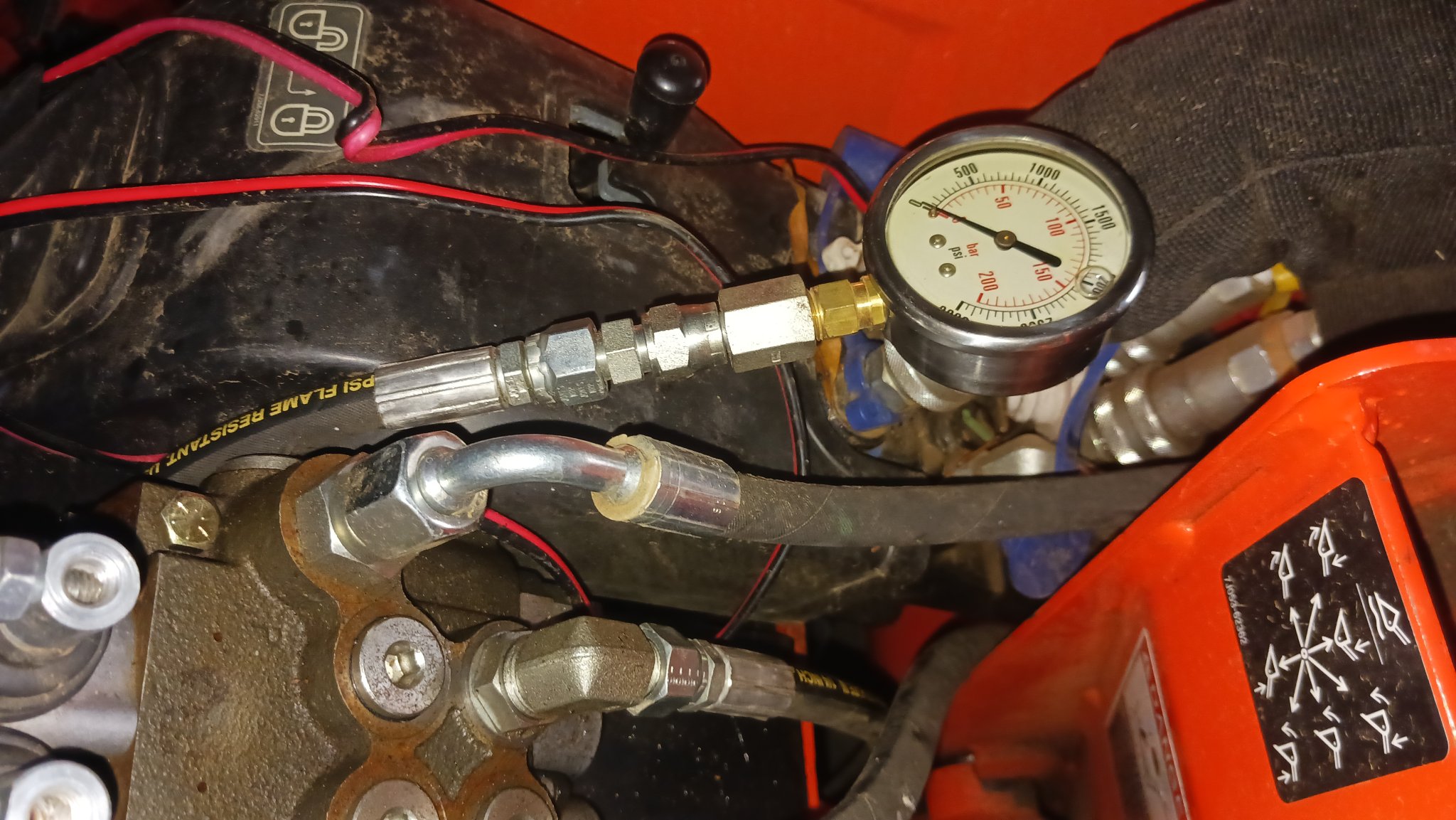

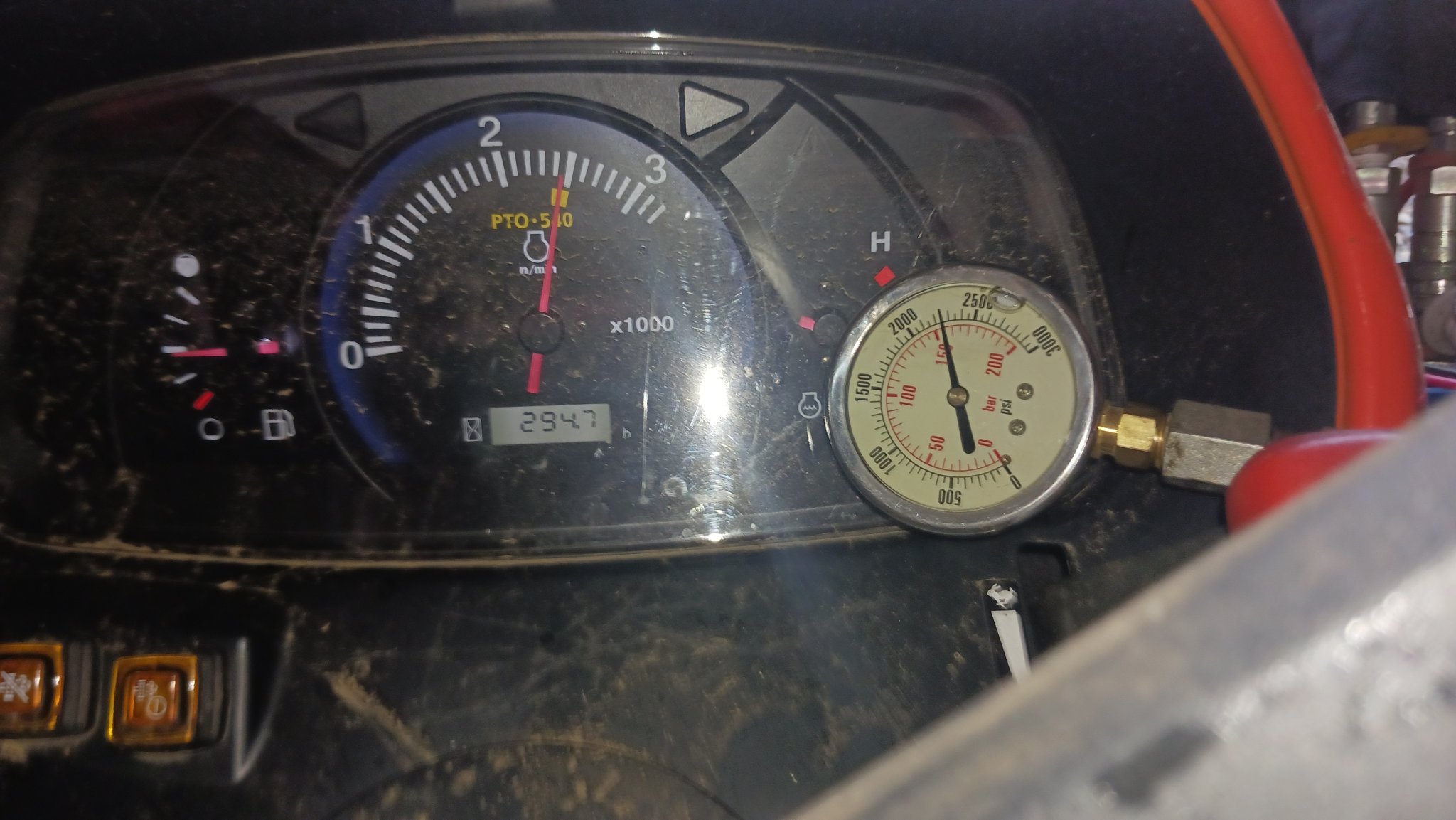

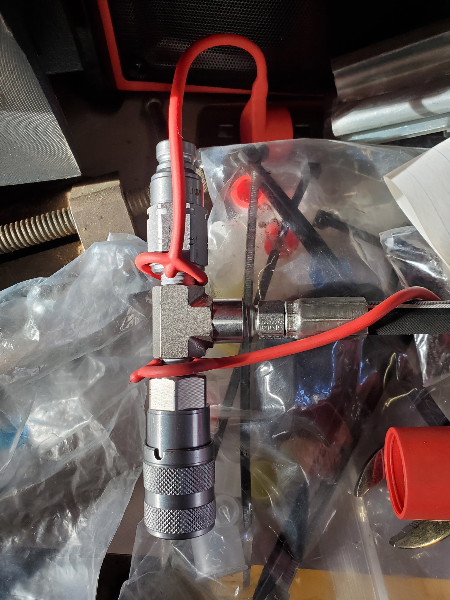

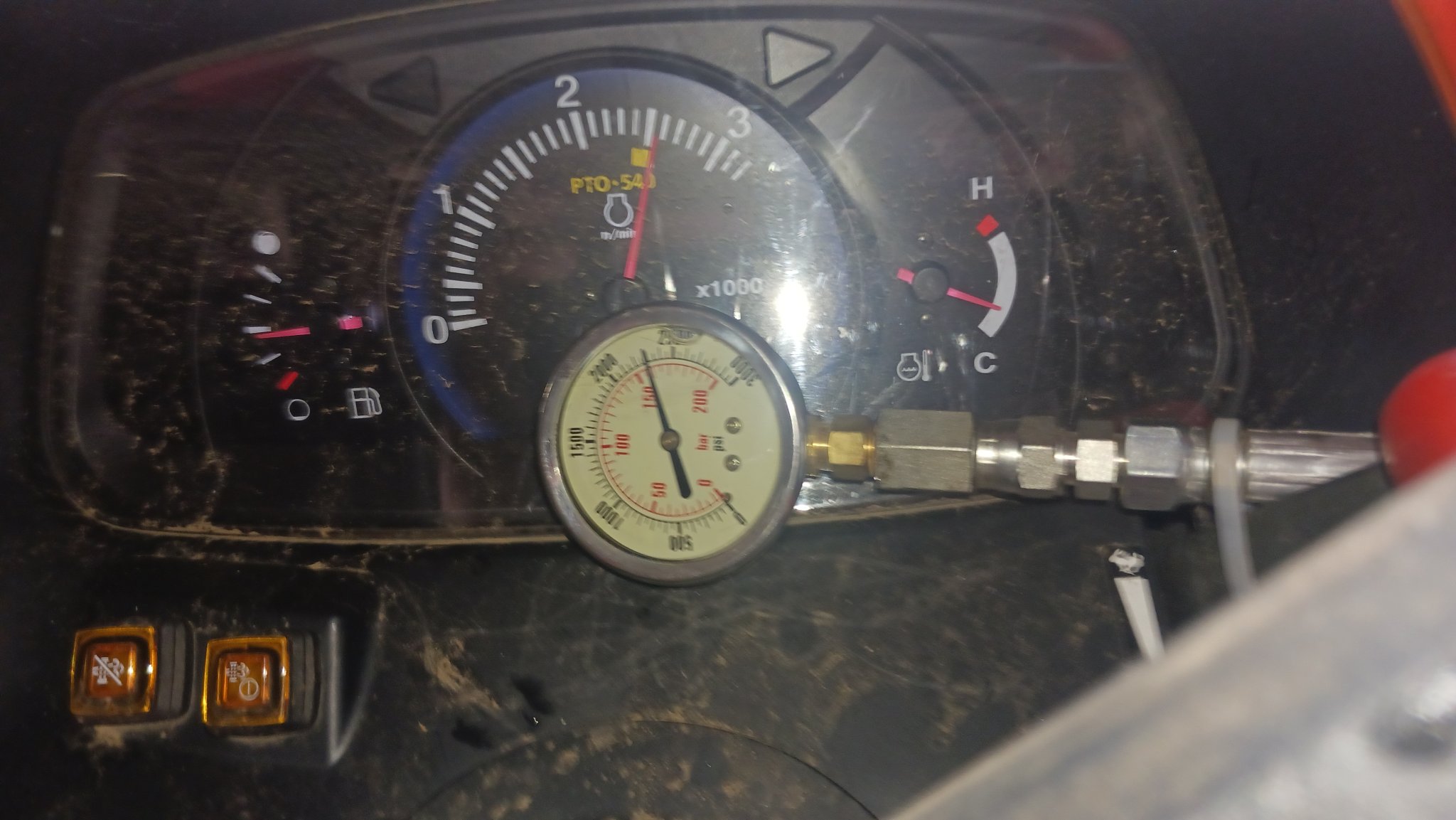

I finally got around to checking this.
It confirmed my "butt dyno" feeling.
-3000 PSI gauge teed into the backhoe power beyond (not the backhoe power feed).
-Tested loader lift and up curl as well as my third function running off the loader power beyond. All 3 had the same results.
-Cold was approx 60*. Started, drove out of the garage and stopped. Hooked up gauge and ran tests.
-Hot was after running the loader for an hour plus. Dug into some pretty hard soil, stalled many times against a tree stump and too many roots. Not that hot out but definitely gave it a workout.
-I also checked with the backhoe power beyond disconnected and the gauge attached to the hose. I only did idle and max, got the same readings.
Cold pressure readings
-Idle (approx 1500 RPMs) 1100 PSI
-2000 RPMs 1600 PSI
-2500 RPMs 1650 PSI
-3000 RPMs 1700 PSI
-Max (3500 RPMs) 1800 PSI
Hot pressure readings
-Idle 600 PSI ( I did a double take when I saw this, definitely explains the weakness)
-2000 RPMs 1500 PSI
-2500 RPMs 1600 PSI
-3000 RPMs 1630 PSI ( rough estimate, gauge only has 100 PSI increments)
-Max 1690 PSI " "
To head off some questions.
-My tractor has 125 hours as of tonight.
-Replaced hydraulic fluid and filter with Kubota parts, cleaned pickup screen (wasn't that dirty) at 50 hour service.
-Fluid level is good.
-Hoses were warm to the touch, not excessively hot.
-No unusual noises.
