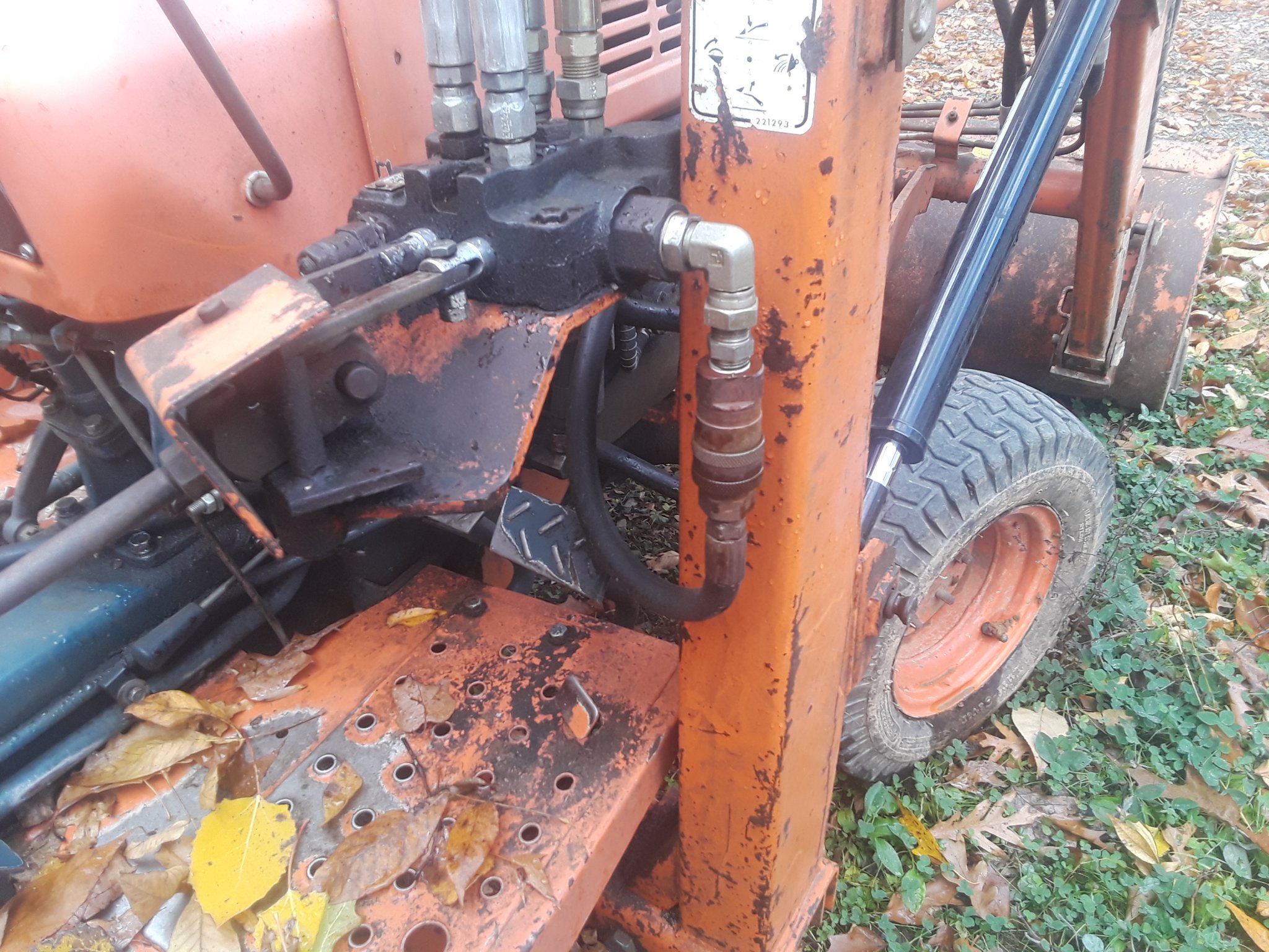

Thanks Dan. Could you clarify "power beyond hose from loader valve" vs "power beyond port of loader valve"?
Before my changes, two hoses ran from the hydraulic box to the loader control box. Am I changing anything downstream of the loader control box? If so, will I use the two capped-off front-facing ports on the attached picture?

You have two hose connections from the "hydraulic block" to two different ports on the loader valve. One supplies pressure from the tractor to the loader valve. The other returns pressure from the loader valve to the tractor. That second connection is the power beyond port and hose connection FROM the loader TO the tractor. That is the line that you want to use to supply the log splitter. That appears to be the hose in the forground of your picture. Put a male/female quick coupler on that connection. What you get is something like this:
Now change the male quick connect on the log splitter return (tank) hose to a female quick connect. To connect the log splitter simply disconnect the male/female power beyond connection at the loader valve and connect it to the male/female log splitter hoses. The tractor MUST be off when doing that.
