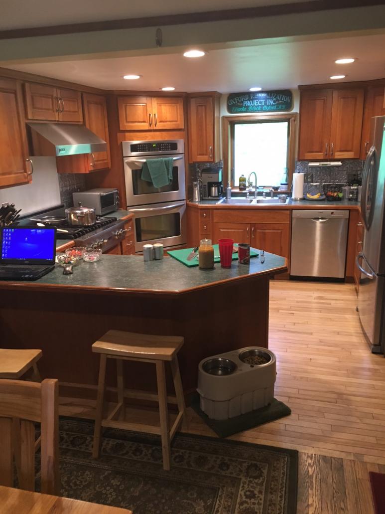

I had a similar problem. The original kitchen from the first remodel waayyyy back in the 70's had a wall between the posts where the short breakfast top is now. That side was once the back end of the house. We wanted the open concept and built some headers & beefy posts to carry the weight to the foundation and it worked out great. The long part of the breakfast bar had hanging cabinets which we took out.
It's just to show that there are ways to make it work.

By the way, I would have taken better pics but we sold that house. Certainly made a 70's house into the most expensive house on the block when we sold it, quick!

Wow, Sean - that's nice!!!
You've got more square footage in a couple pics than we have in our whole downstairs!!:eek:

Thanks. If you asked, we sold it because,... we wanted more room. This was a 2,400 sqft, 3 bd/ 3 bt home on a tiny lot in SoCal to a bigger one with ACRES. Lord knows I want my space!
I spy your double oven, Kitchenaid? Can't say for the stove, my wife would have killed for that!
Another pic to show the other view of the kitchen I did for my wife. I've never done a kitchen remodel, go figure. Everything was gutted! Let's just say that after 3 months of work, I've collected enough brownie points that I got land, a shop, ATV's, tractor, and four flat screen TV's out of it.
OP, Sorry for going off topic. If you were close, I would have given you a hand and show you the possibilities & ideas. Your pics were strikingly similar to the old kitchen we had.

See, Daren is getting some ideas from your pictures!
The double oven is Frigidaire - convection both ovens. Don't remember if they were Whirlpool by then or not - many brands now are Whirlpool.
The rangetop is Viking Professional, with matching hood. My pride and joy. I cooked in restaurants through high school and college. Still pretty good at it, and REALLY wanted the 6-burner commercial-type. :cool:
My wife really wanted granite counters, but at $6-8K just for the tops, was a deal-breaker. We had formica for almost 20 years with no issues, and these are formica tops with cherry banding to match the cabinets. At $1,000, much better deal.:D
