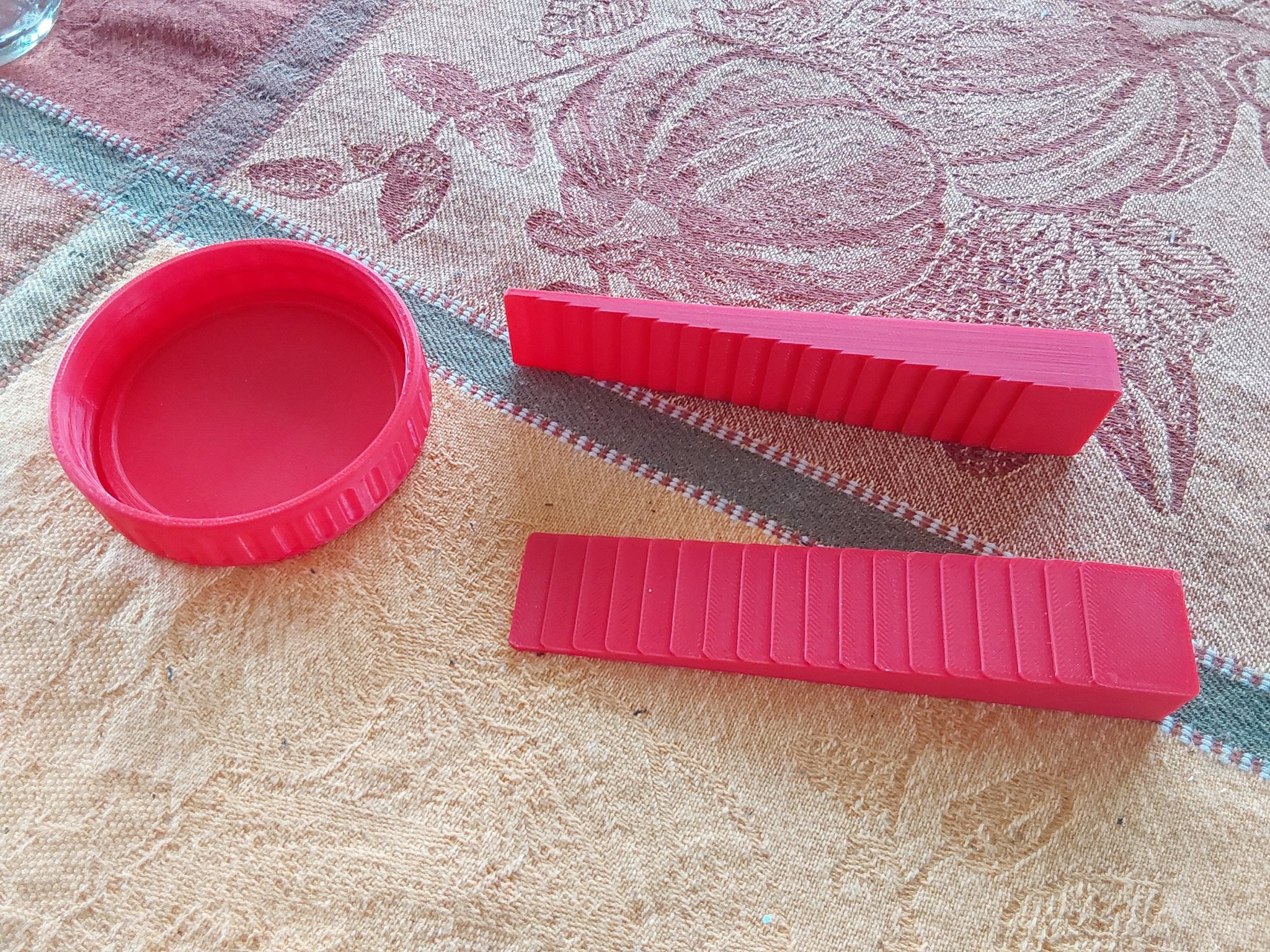

Wife wanted another jar lid and I needed some shims so the printer came to the rescue again

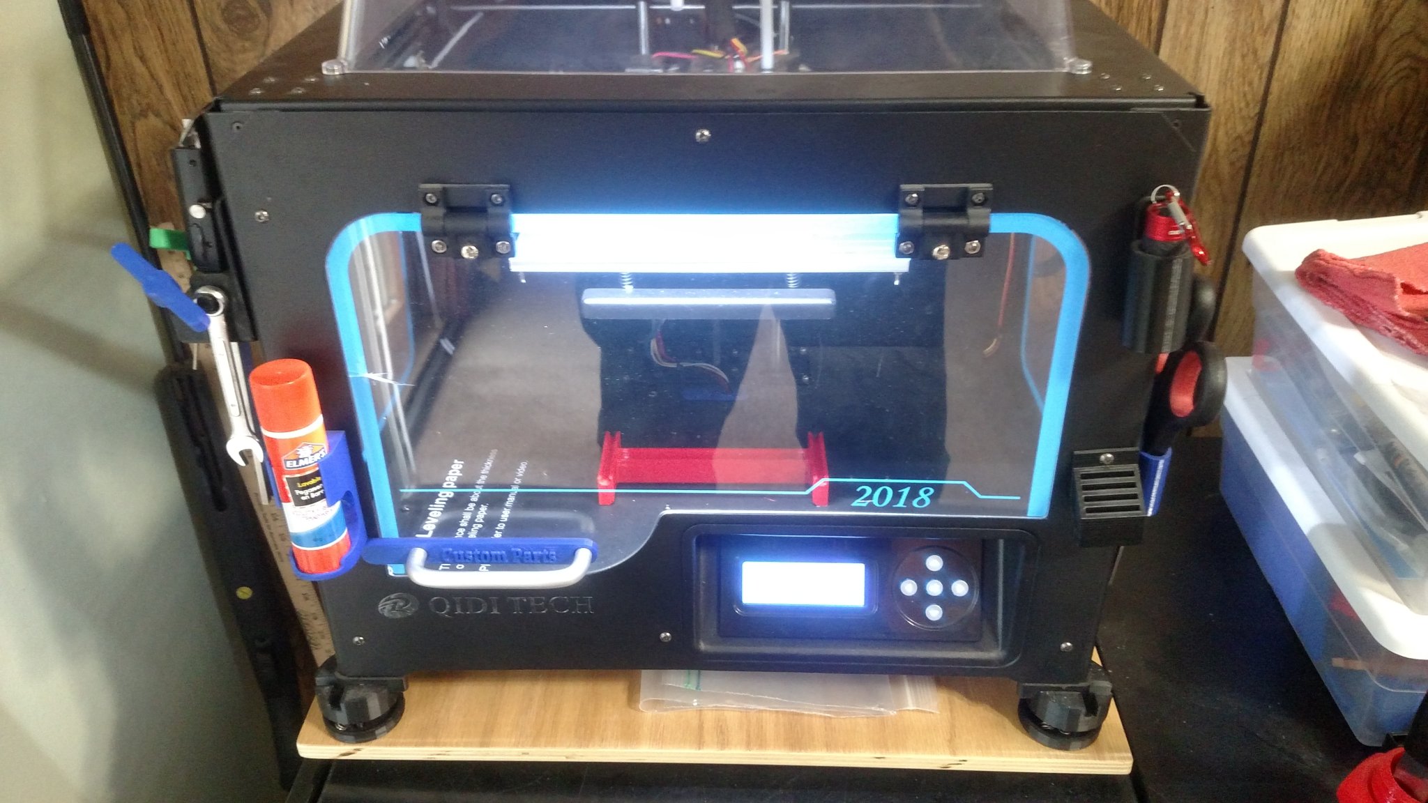

I have a QiDi Tech printer I bought almost 10 years ago, and a Hypercube 300 core XY that I built from scratch. I used the QiDi to print a lot of the parts for the Hypercube. It has a Duet3D board that has USB and ethernet, so it's attached to my network. Makes it easy to download files and print them out remotely.

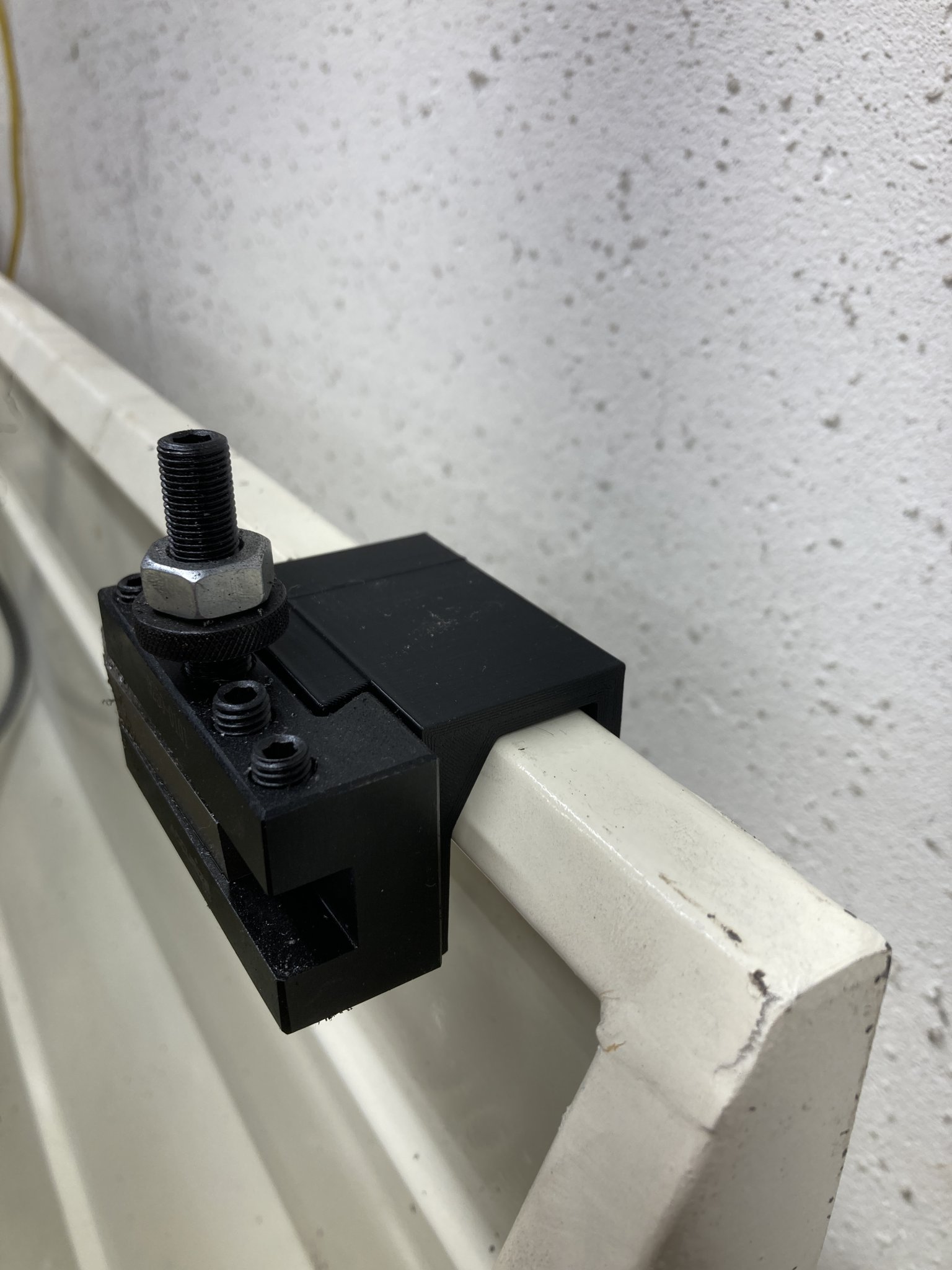

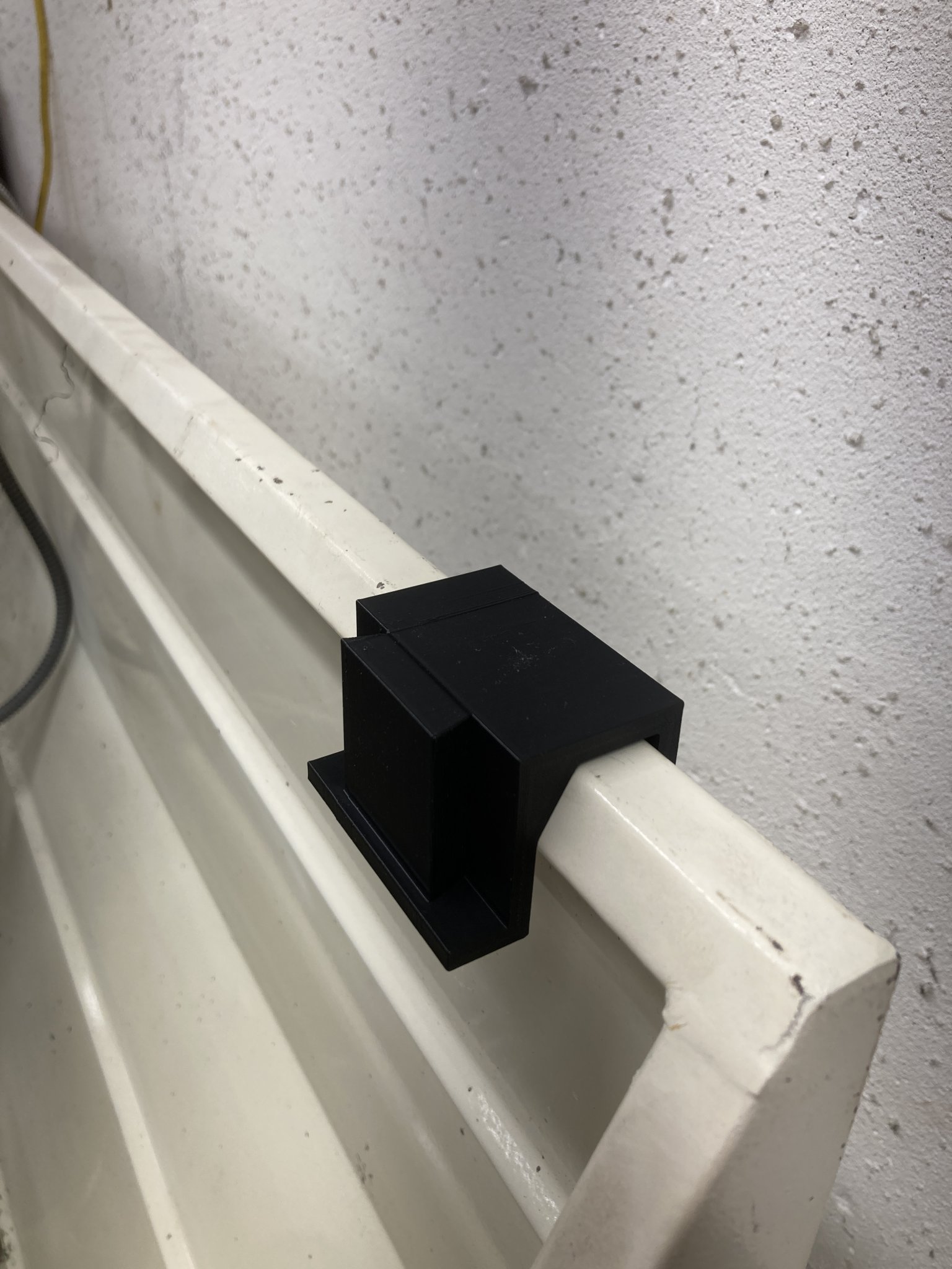

Well, I just got my newly printed "Lathe tooling holder" and it turned out great.
It turned out much better than I had anticipated.
I am "duly impressed"

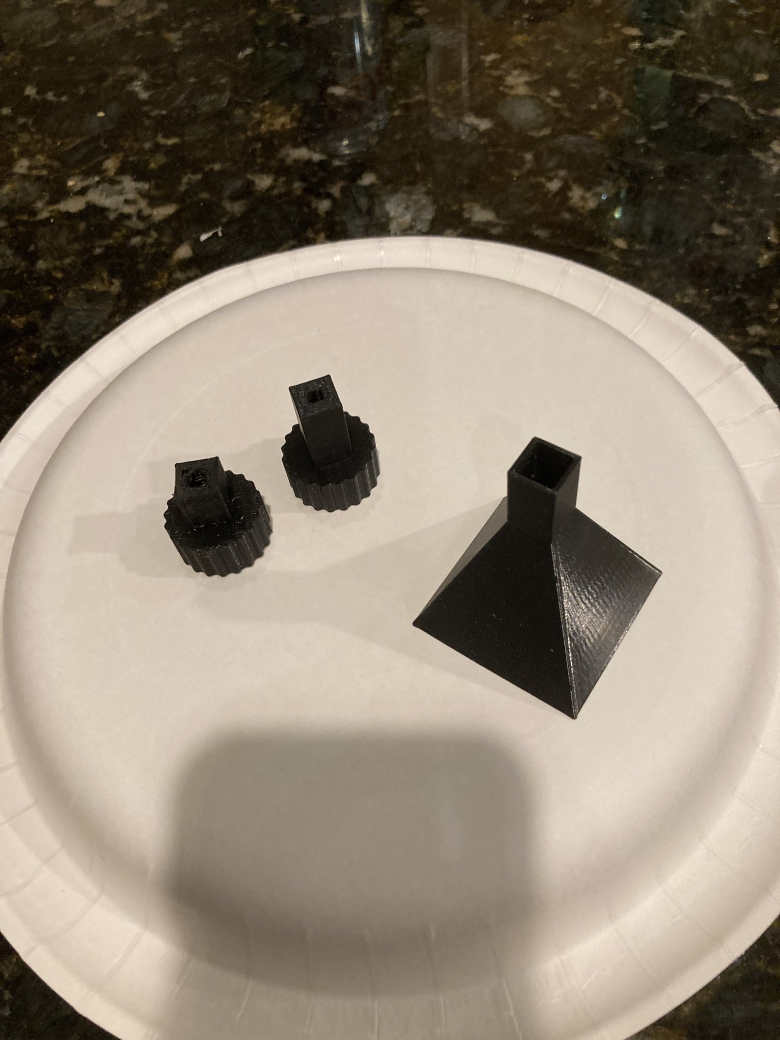

The other things, well, it was kind of a mixed bag.
They all turned out nice, and seemingly well made, but some of the circular parts came out square?
Not sure what happened there, but I have a feeling there was some sort of "miscommunication" with the file.
Everything you see below that is "square", should have been round.
Not sure what happened, but they all seem plenty strong.

Nice. Which printer did you get? When you export a STL rounds are really segments. Up the number of segments to get rounds in the export page that opens when you hit export.

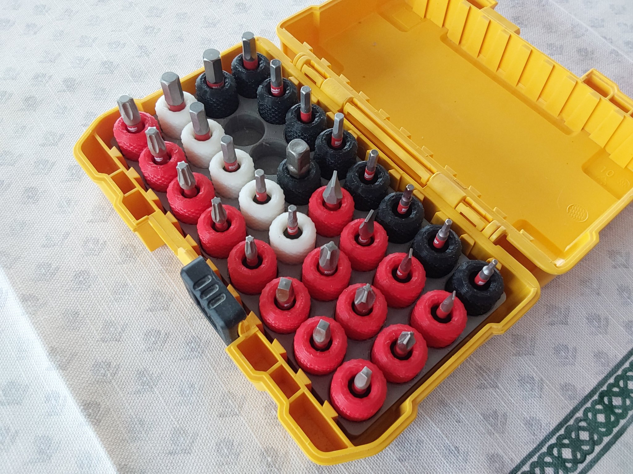

Decided to make a whole set of the mini drivers with extra bits I had. Printed the finger knobs, Printed a holder that fit in an old Dewalt case, and made some vinyl labels.

Very nice!
