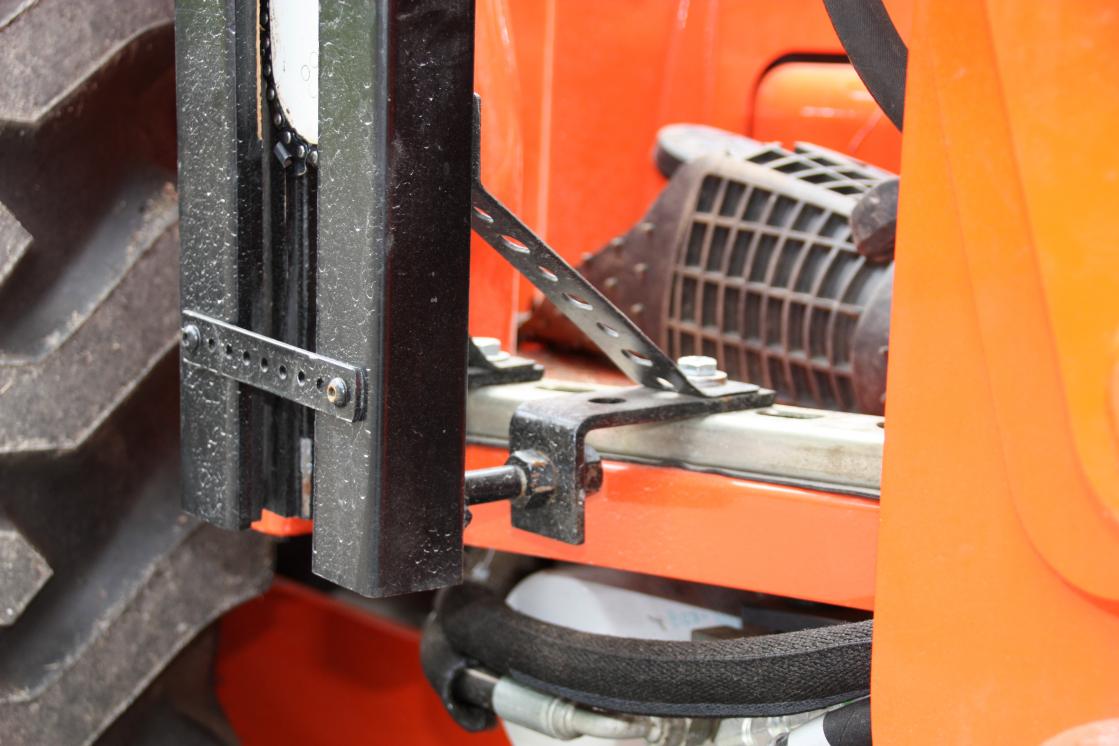

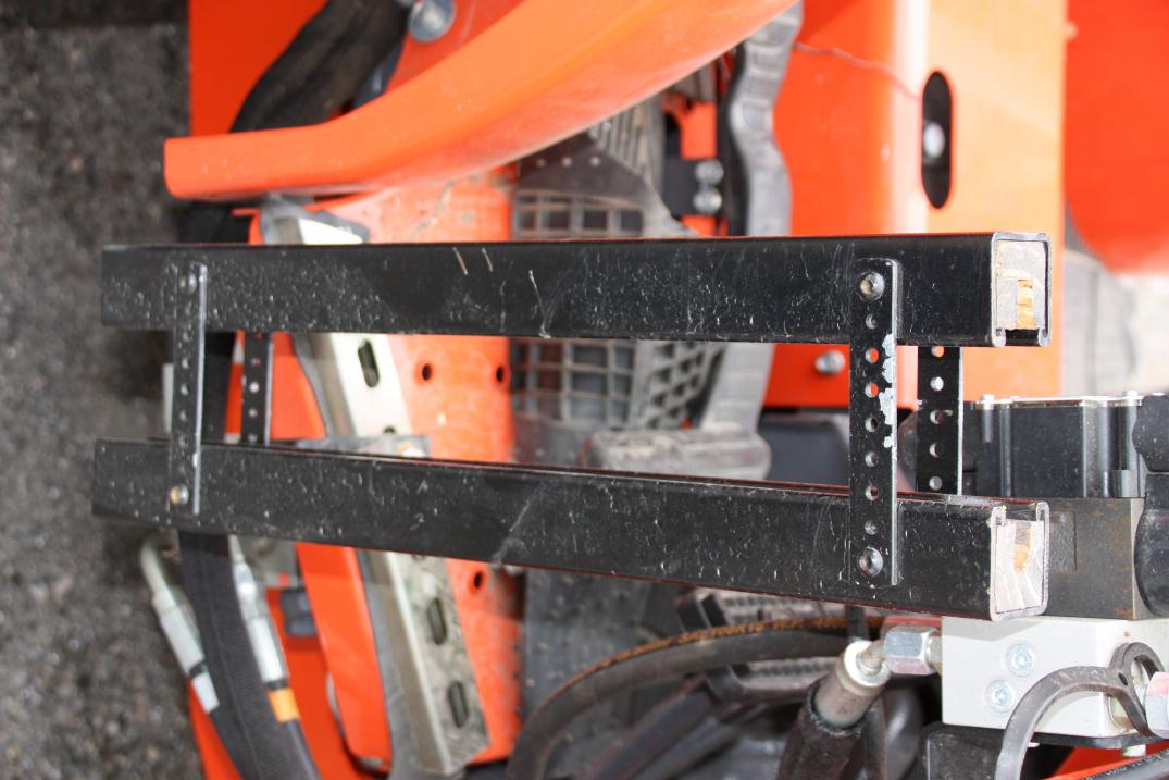

I've posted my version before but here it is again. It is made from Uni-strut and sleeved with wood. I have since added a top brace bolted to the FEL hyd. valve support to control vibration, not shown in these older photos.
