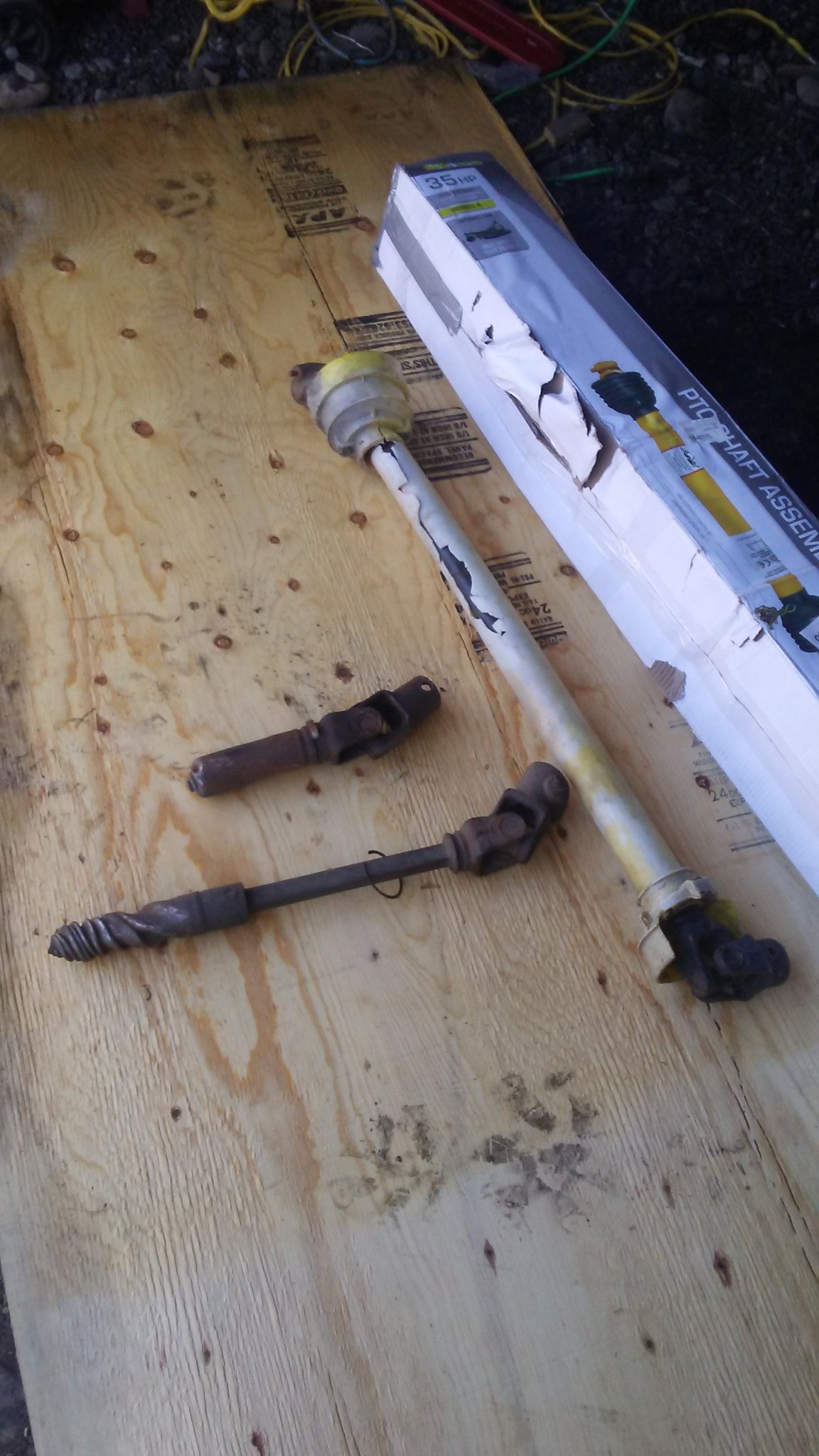

I learned some things about PTO shafts. Like a shear bolt must not be replaced with a grade 8 bolt. There are horsepower ratings for the equipment and the shafts. Little things ya overlook.
I inherited a 48" rotary cutter, tiller, post hole auger. They work great on my old 7100. The old machine had a tire problem and I wanted to get the pasture mowing done. What the heck. Put the rotary cutter on my L3901. An hour later and nearly done I find a stump. Normally the shear bolt would give and I'm out nothing but a cheap bolt. I never thought to look at that bolt. I never thought about a 20 hp shaft on a tractor with far more power.

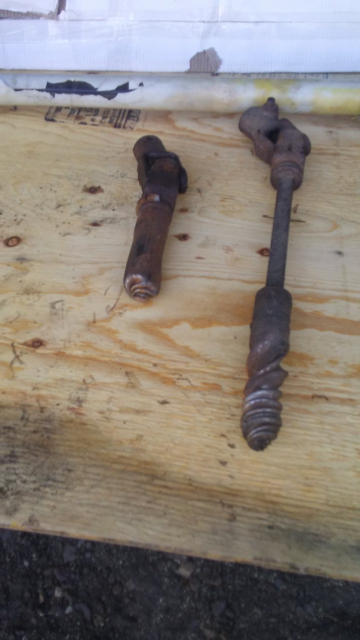

Now I have a new shaft for the correct hp and have correct shear bolts. Here are pics of the old shaft

That is torque .... and lots of it!!! I have never seen that wind up like that - seen a few shafts beat something to hell and back .....
Glad no one was hurt. And don't beat yourself up - IF someone every says = "I have never screwed up," they lied!!!!
Hell - first screw up I did was dump a heavy piece of wood on my 1 hour old brand new tractor that I had not made the first payment on yet ... I have the dent to remind me ..... everyday!
Good story - thank you for the true story! And a teaching lesson.

Might be able to repurpose that end as a screw point for a post hole digger.............. :D

I looked at the picture before reading and my brain couldn't comprehend what that was. Wow! Live and learn. :)

I bought three new shafts to replace the three I had. On one older shaft (in picture) the shield was falling apart due to years of sun. I figured that was a safety issue as well.

Glad you weren't hurt but that is cool as heck! Seriously, I'd hang that on my shop wall in a heartbeat!
