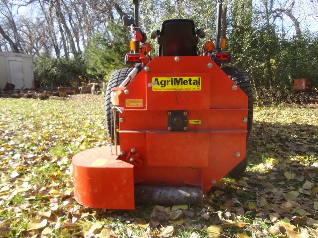

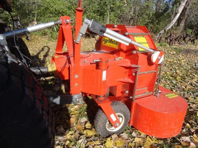

Here's a few pics of my blower purchased in the real early '90s. I should've taken the pics before using it today as it was much cleaner. It has a 24 inch impeller which looks about the same size as both your machines. I run with it just off the ground as much as possible. The wheels keep it upright when not attached and make it easy to move around for storage and for hookup but otherwise aren't needed. Maybe on real uneven ground they'd come into play.
The 12 volt linear actuator added works quite well to raise and lower the chute deflector. The switch is mounted on a plate attached to the threaded hole on the ROPs with a disconnect for the wiring. I plug power into the "cigarette lighter" socket on the B2650.
