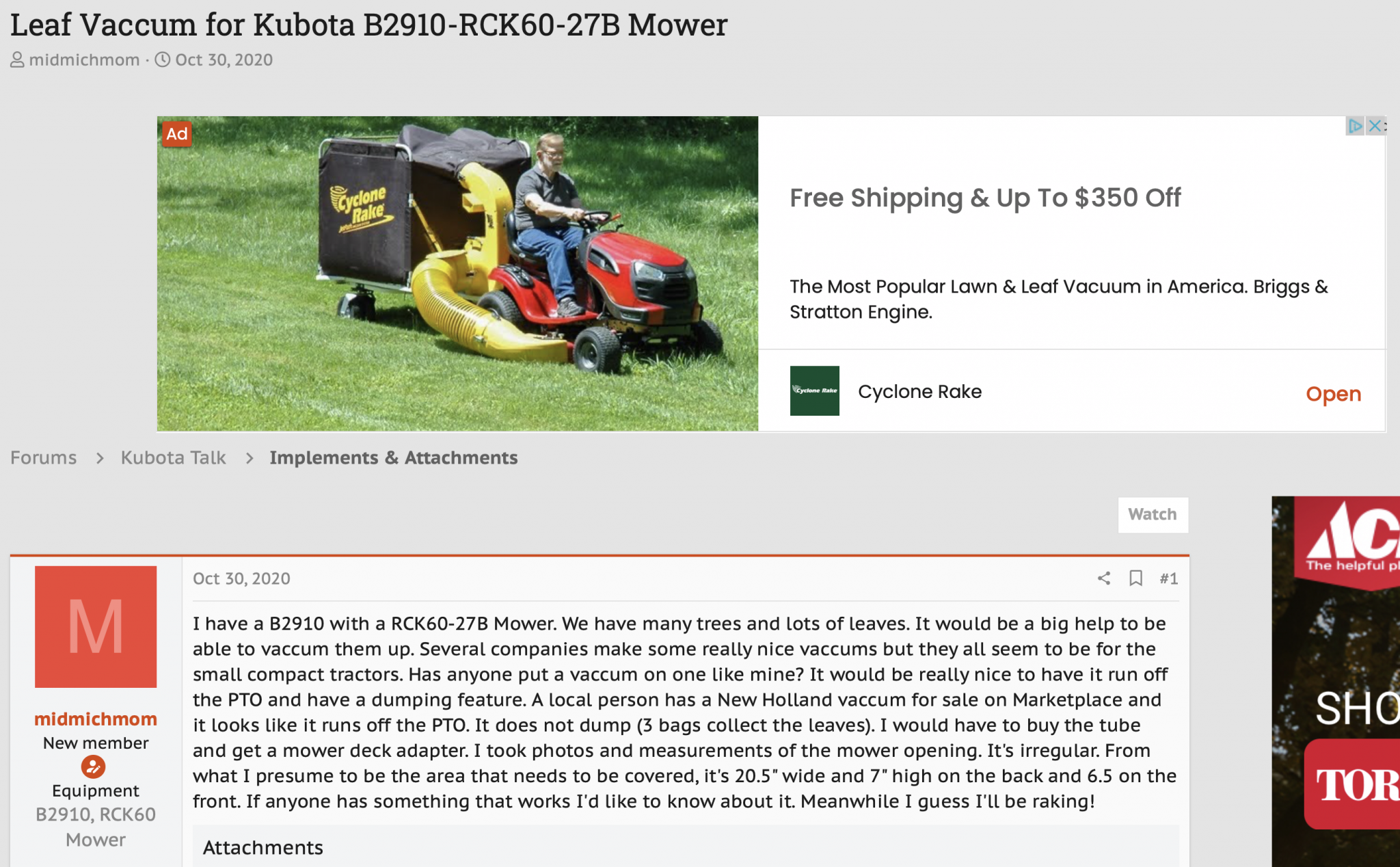

I think you made a good choice. Got a chuckle when I opened this thread and saw this add above it!
