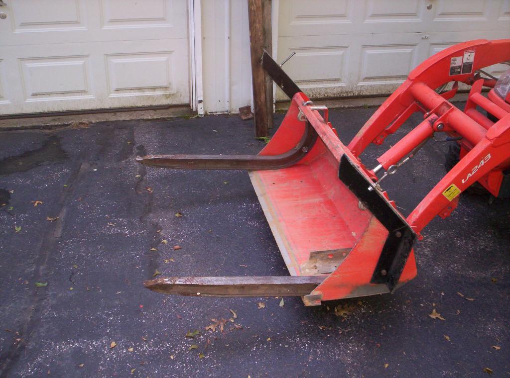

Having to load logs onto a flat trailer and stacking to max lift of my BX I made some log anti-rollback brackets . They are 3 x 3 angle iron and bolted to the side of the bucket with the fork mounting bolts (1/2 inch grade 8). I made the forks from old plow beams (they fit the bucket curve perfect).
The anti roll brackets kept the logs on the forks (plus slightly tilting the bucket forward as lifting) - main thing is to NEVER look away, get distracted or be overconfident, slow and steady is much safer.

Rgk66, that is amazing you found 50 year old plow beams that fit as if they were made for the project. Painted orange and folks would never know they are repurposed steel, and want to know where you ordered them! Nice job.
