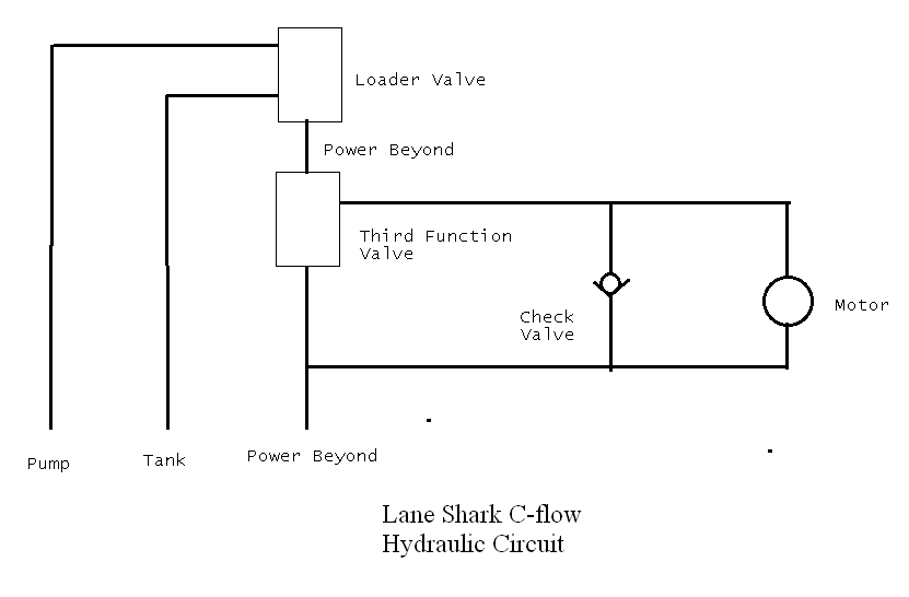

Lane Shark seems to struggle with this issue. AFAIK none of the Kubota third functions return to sump. The 3rd function outlet goes to power beyond for downstream power to 3pt, rear remotes, backhoe, etc. If you plumb the Lane Shark return into the power beyond outlet the route to tank goes through all of those devices.

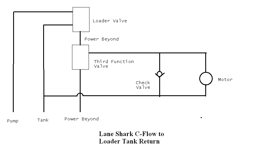

That said the Lane Shark return does not have to be plumbed into the 3rd function outlet. It can be plumbed directly to sump via the tank return on the loader valve. That minimizes return restrictions and eliminates the possibilty of deadheading the rotating mass of the mower but it comes at the cost at the cost of loosing all use of 3pt and any other downstream valves/outlets when the LS is connected AND running. When the Lane Shark motor is OFF everything behaves as usual.
You DO NOT need their switch. All you need is a way to hold the the the third function on and a simple toggle switch wired into one side of the the 3rd function circuit will do that.

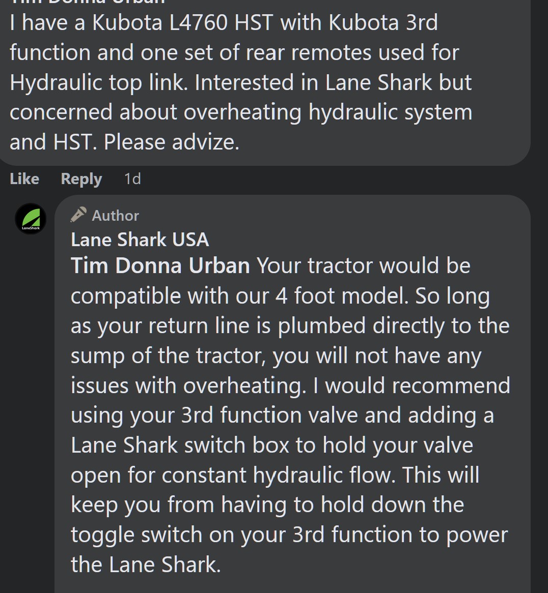

Thank you for your comments and the schematics, it is nice to have someone good with tractor hydraulics to provide input. You are correct about the LS struggle in regards to knowledge of My 3rd function set up. It is confusing. My fear is the LS dealer knows Kioti systems but won't know Kubota systems further complicating my installation. There is a Kubota dealer two hours away that also is a LS dealer so I may give them a call.

Lane Shark has to deal with lots of different makes, models, and third party valves so in fairness they cant be intimately familiar with the details of all of them. That said they have videos clearly showing installations that do not follow that guidance. That is bad.
