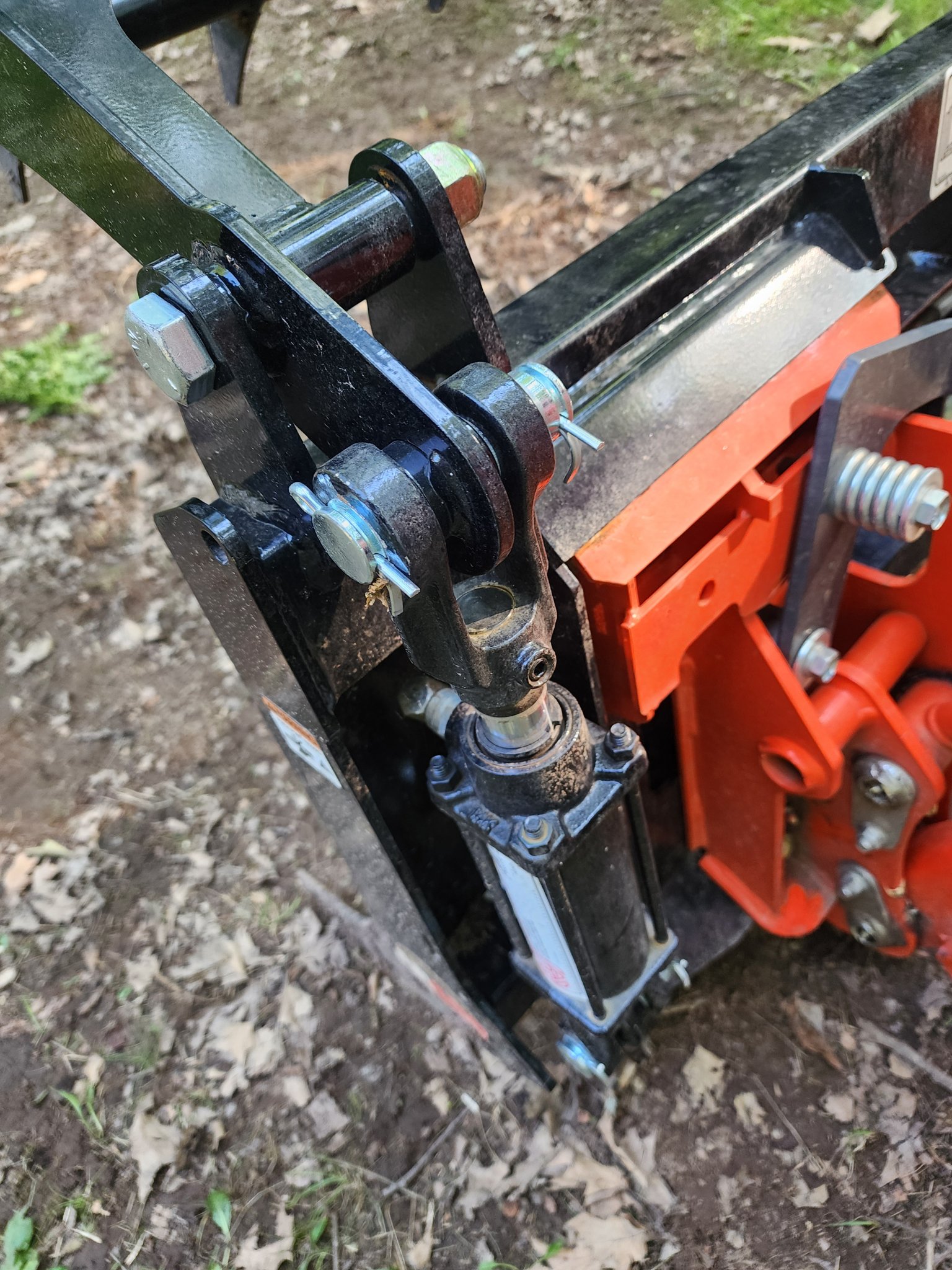

I know this is an old thread, but I've been using my grapple more often and would like to replace the pins with some with zerks on them.
Or drill and tap the hinge parts to take a zerk, but I don't think the steel is thick enough to clear the pin with a zerk threaded in.
Obviously I would have to change 4 of the pins to none cotter pin type. Pins on both ends of hyd cylinders take cotter pins.
Nothing is mentioned in my manual about lubing this unit. There are zero zerks. 6 major pivot points... each end of the hyd cyl and 2 on the claw.
Any suggestions for a good place to buy bolts set up to take a zerk at the end and a lube hole midway down the length?
I can make my own but I will spend more on drill bits, I think.
LandPride SGC0554 grapple.
Drill and tap the pins.
#7 HSS drill x 2 = $1.60
1!4-20 HSS tap x 2 = $6.50
14,990
4,068
I was thinking about drilling the bolts and then cross drilling about half way and tapping for a fitting in the bolt head, I havent looked real close but I think you could do the same thing to the pins though you would have to off set the main hole. But since I dont have ,nor do I know how to run a lathe, I doubt either of those things are going to happen,,,, HINT HINT HINT
Can you run a drill press? HINT, HINT...
