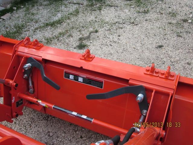

The LA525 was available two ways, sounds like you have the less expensive pin-on style bucket so yes you would need a new bucket or modify yours with a SSQA plate.
This is what the Kubota SSQA bucket looks like:
