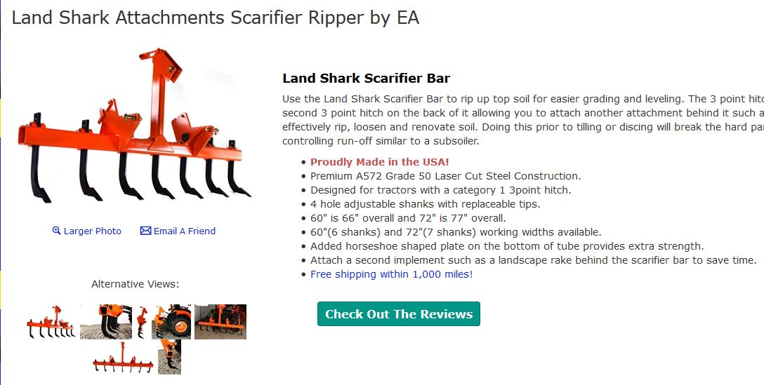

I'm always doing a similar job to you it seems! Ripping roots and clearing trees. With my MX5800 I use a Land Shark Scarifier Bar made by Everything Attachments. It works quite well at removing surface roots and breaking up the soil. I would then use a disc to chop things up followed by a chain harrow to smooth things out.

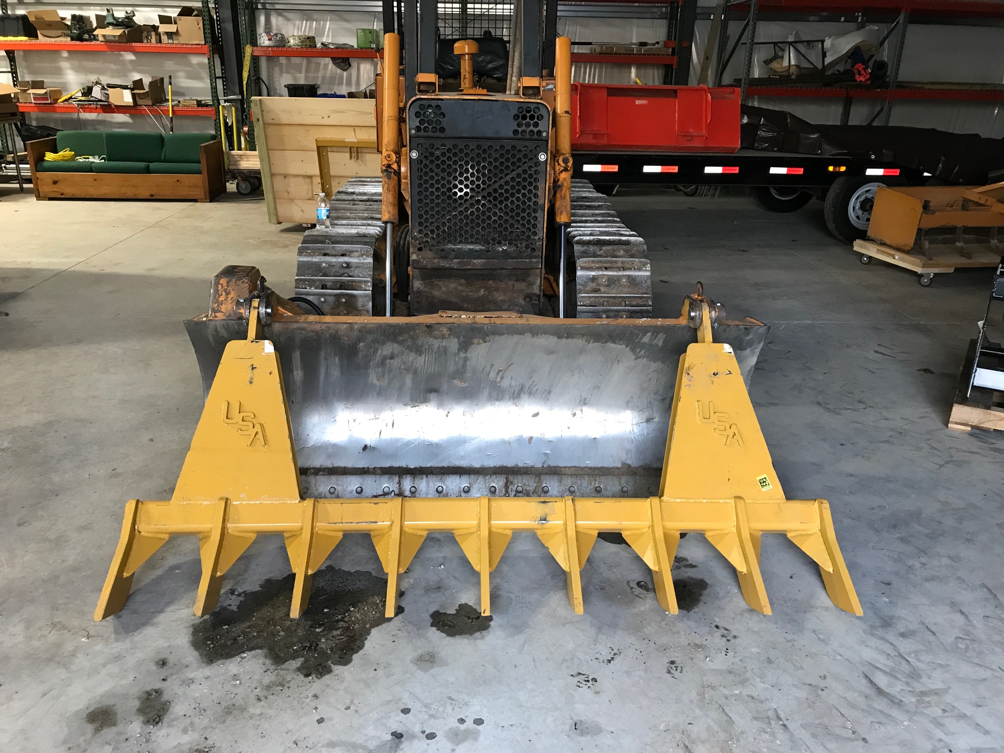

When the going got really tuff, I would get out my big yellow monster, it tends to work a little more effective in very dense root fields. It may be old but as you can see it got a new set of teeth just for this type of task! Good luck in your tasks.

Yeah thanks! I saw one of those attachments while surfing around the other day. Thought it might be a pretty good idea. And yeah I think a dozer with a root rake would definitely be the best way lol! Lemme run that by the wife!

That's quite a set of dentures. Did you fab them yourself?

No USA attachments built the dozer root rake, they did a great job and made it to fit my machine, it’s an early 70’s Case 450.. I have a large acreage of woodland and each year I clear a few more food plots and make another trail or two, this thing is a work horse and stops me trying to do stupid heavy work with my tractors, just hoping it keeps on running

A machine like that should almost last forever with regular maintenance. I have a 49 MacCormick Deering W4 that pures like a kitten.

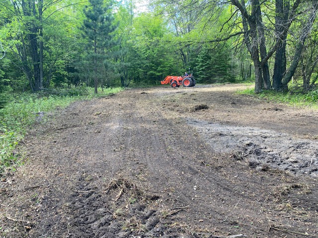

After recommending a subsoiler today I went and purchased one myself, I just cleared some small woodland food plots for bow hunting in the fall and want to pull any surface roots, I'll use my L3200 and the TSC subsoiler to get into these tight areas. I went to my local tsc and saw that that had 1 subsoiler in stock online, when I got to the store it turns out it was slightly used and returned, the manager let me have it for $159, a bargain. Look forward to putting it to use next week.
I like to get the surface roots out before I get back in there with the rototiller as the surface roots quickly choke up the tiller.

Looks great! Thanks for the advice
