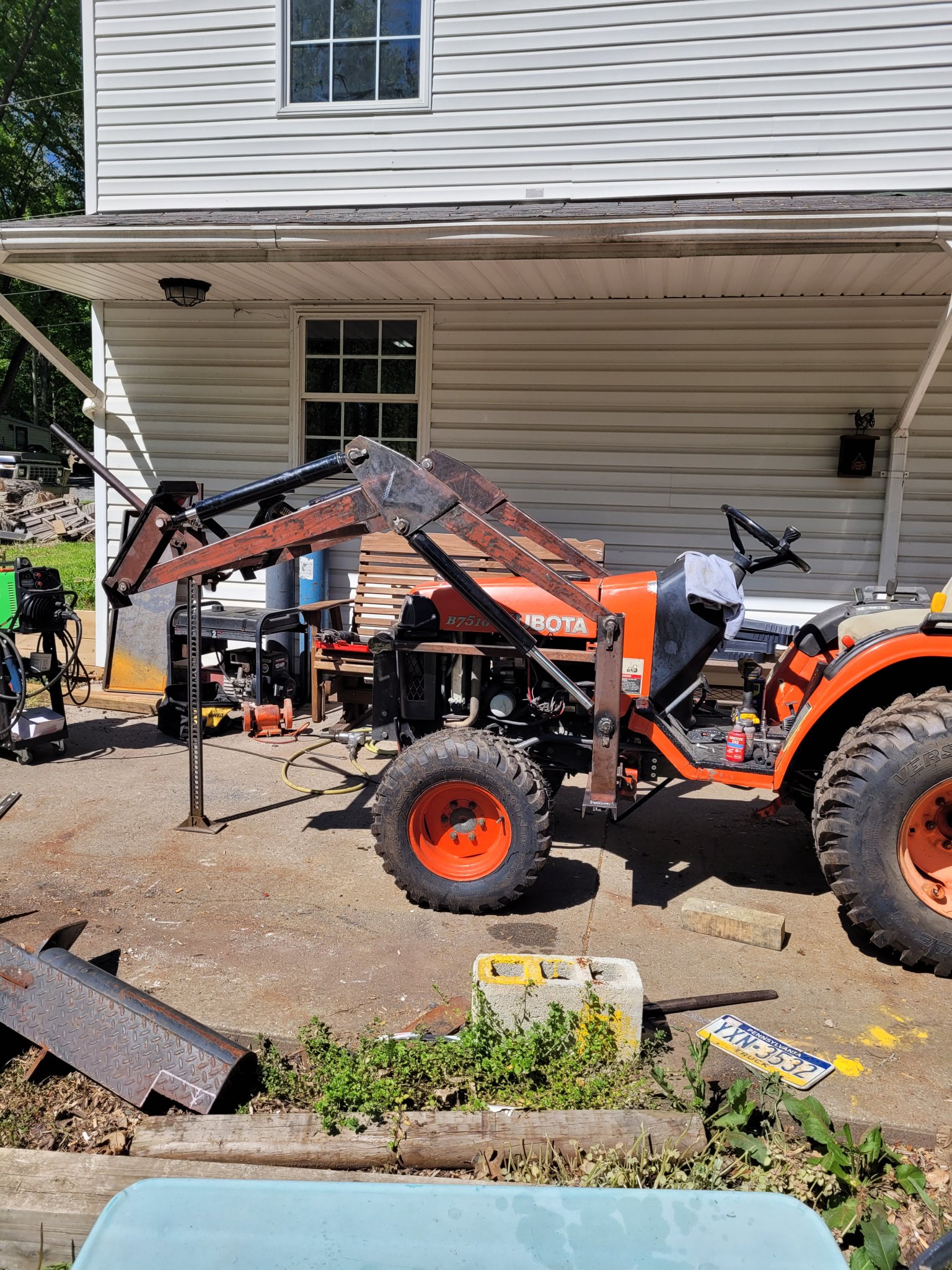

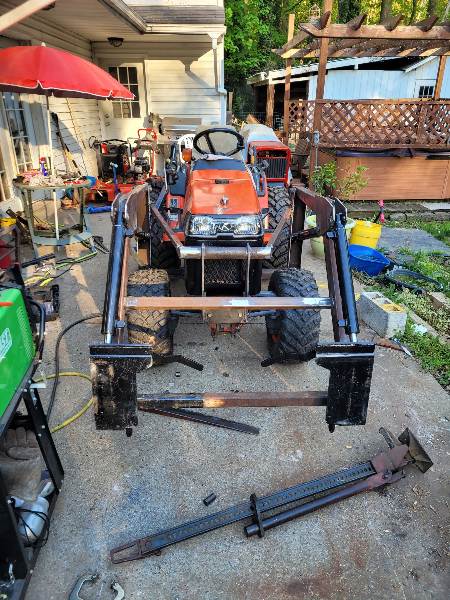

Congrats on finding a fel for your B. I ended up making the entire thing for mine... the lower frame isn't terrible to make imo. Did take a few days till it was figured out. I made mine a bit different then kubota. 4" C channel and 3/8" plate the hardest part was the 2 bolts toward the rear of the tractor. I ended up making a separate plate that slid under the forward/ mid section and bolted fast. Ended up working pretty well. I have it at my uncles shop waiting for some fittings to show up to plumb it. Here's a few pictures in its undone state. Still need to weld a few gussets in and box the uprights/ paint. I'm eager to see how you fab up your mounts.

Thanks for those pic's!
Nice to see other idea's.
I lay in bed at night thinking how I'm gonna make that Main Frame...then I fall asleep and forget everything.

I don't know your time frame, but I'll try to swing by the shop and snap a few pics of the frame this week. It's not finished but you'll get the main idea of it.
