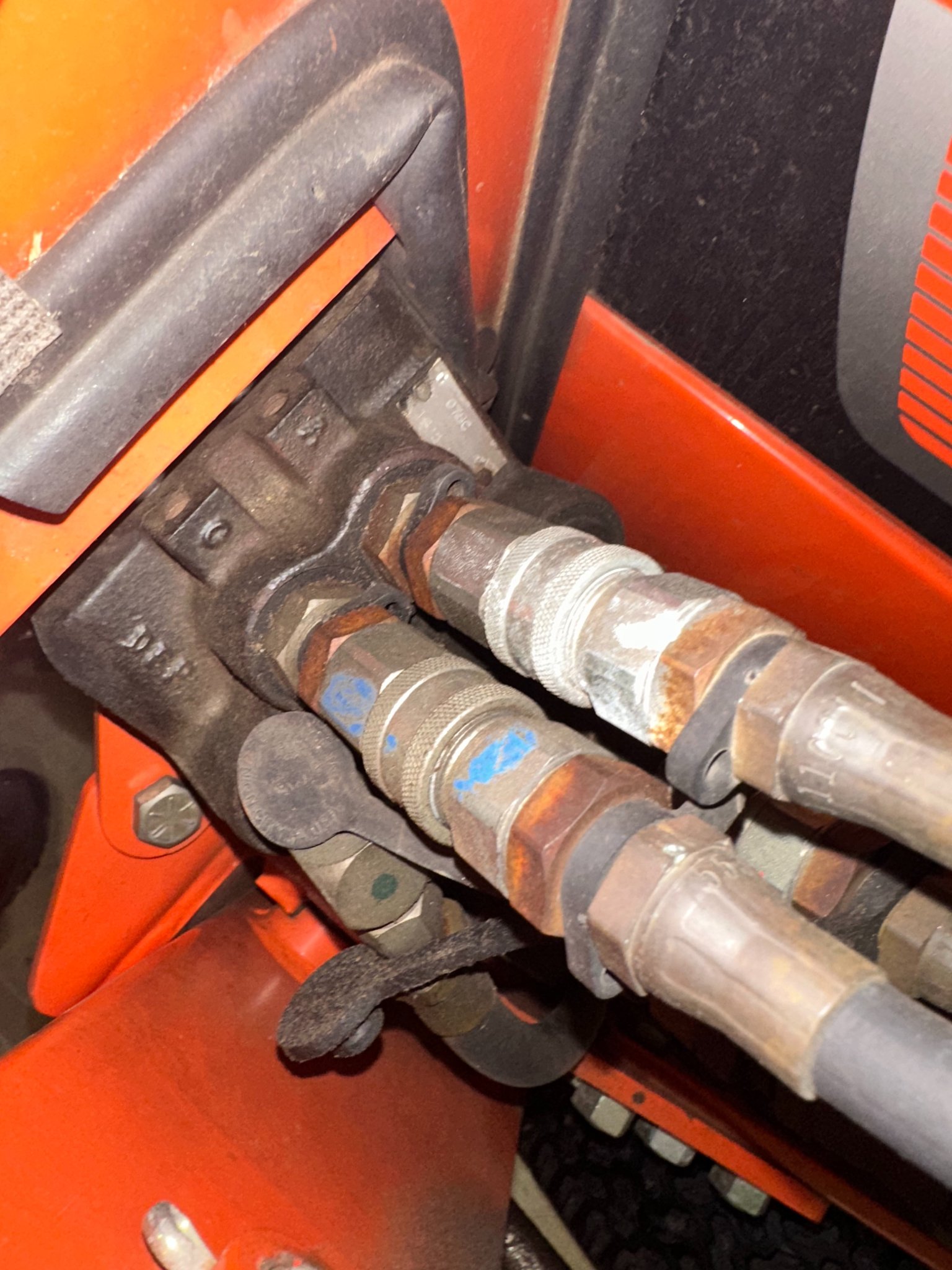

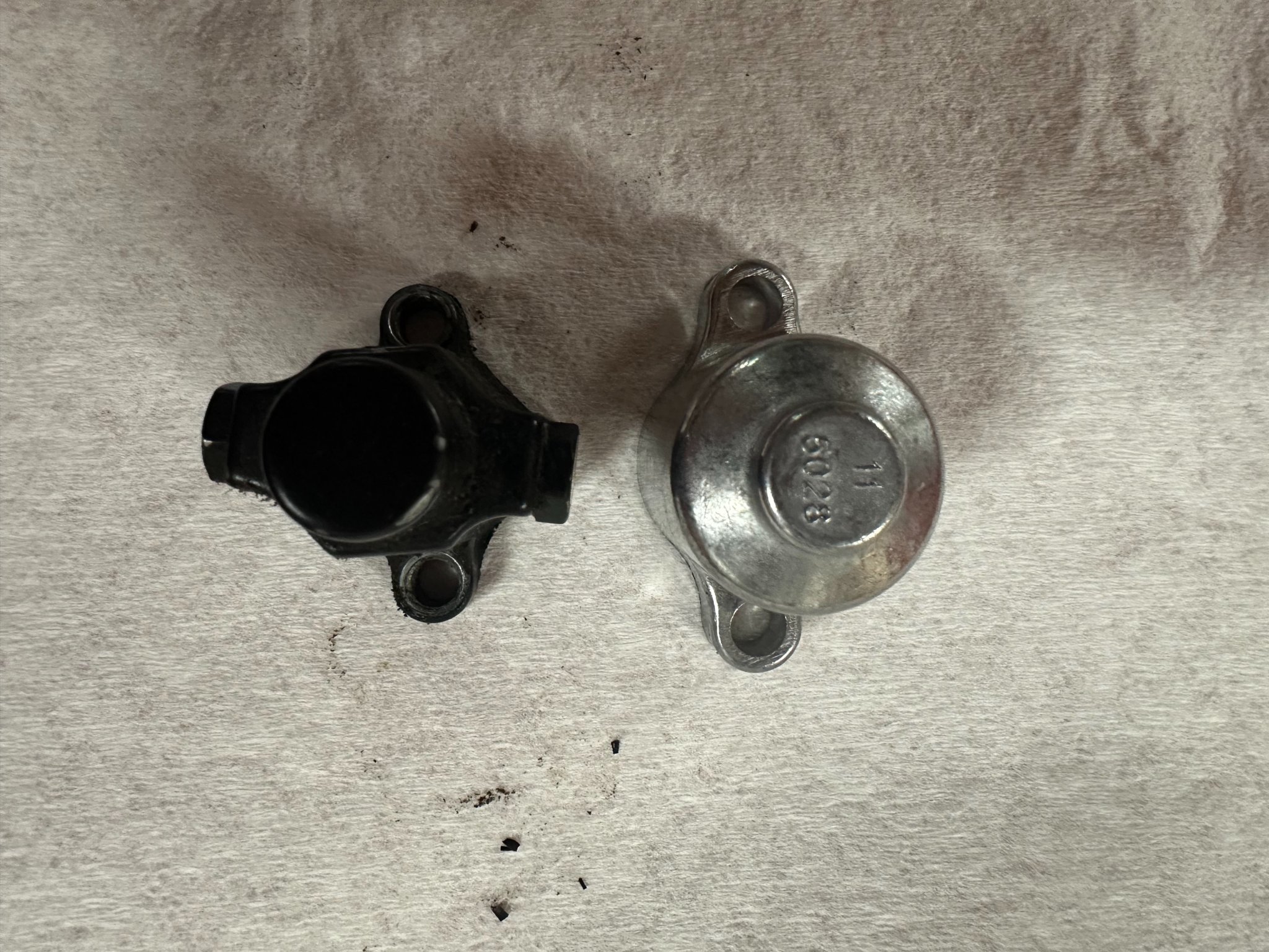

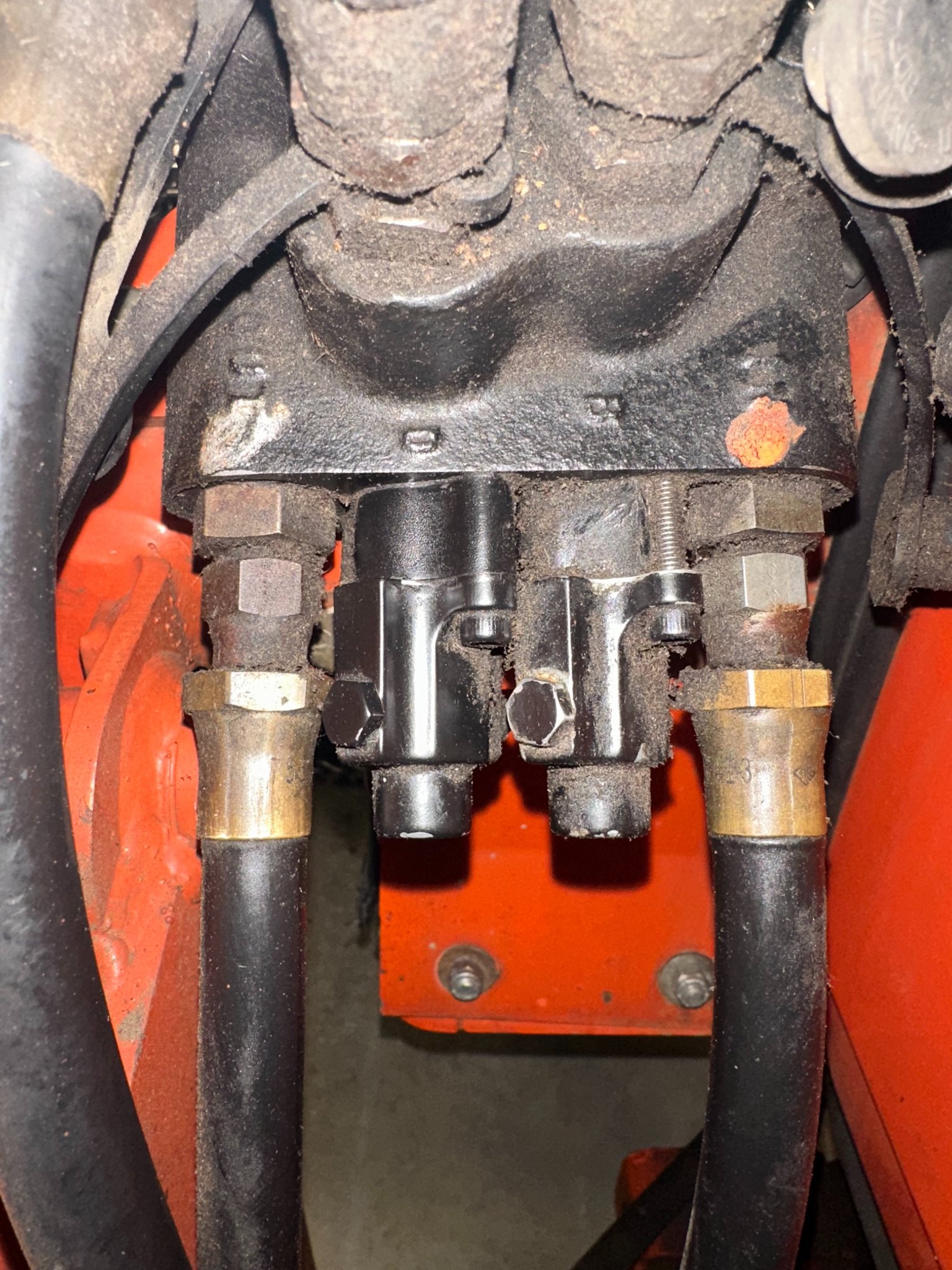

It is a challenge to get clear pictures of it, but here are a couple of the valve and then one comparing the rebuild kit I ordered.
Did I select the correct Summit valve? P40G-2K16A1-J Based on following the hoses in my setup, I believe I also need to purchase the power beyond adapter to connect the line that runs to my 3 point hitch.
Thank you for your guidance.

That looks very much like a Kubota valve. Are there four positions on both spools?
BOOM - UP, DOWN, FLOAT
BUCKET - LEFT, RIGHT. RIGHTER

Yea that's not the right valve for the LA301
It might be a Kubota valve but it's not a stock valve.
I have never noticed a 4th position on the bucket spool, but I can give it a test and report back. I have cab in that direction, so I may never have pushed all the way to ”righter” :)
