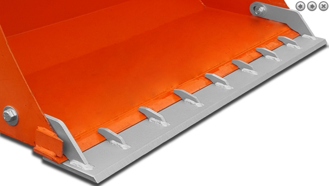

The bucket is not too hard to drill with a step drill bit and 1/2" drill. I did mine to mount a 2" receiver. Maybe the cutting edge itself is to hard but the bucket is not. If you find a wide enough replacement edge you could drill it and bolt one on. BXpanded also makes a straight edge you can bolt on. I have their toothed cutting edge for digging, wouldn't dig half the stuff I do without it. You'd have to measure your bucket and contact them to make sure one would fit.
