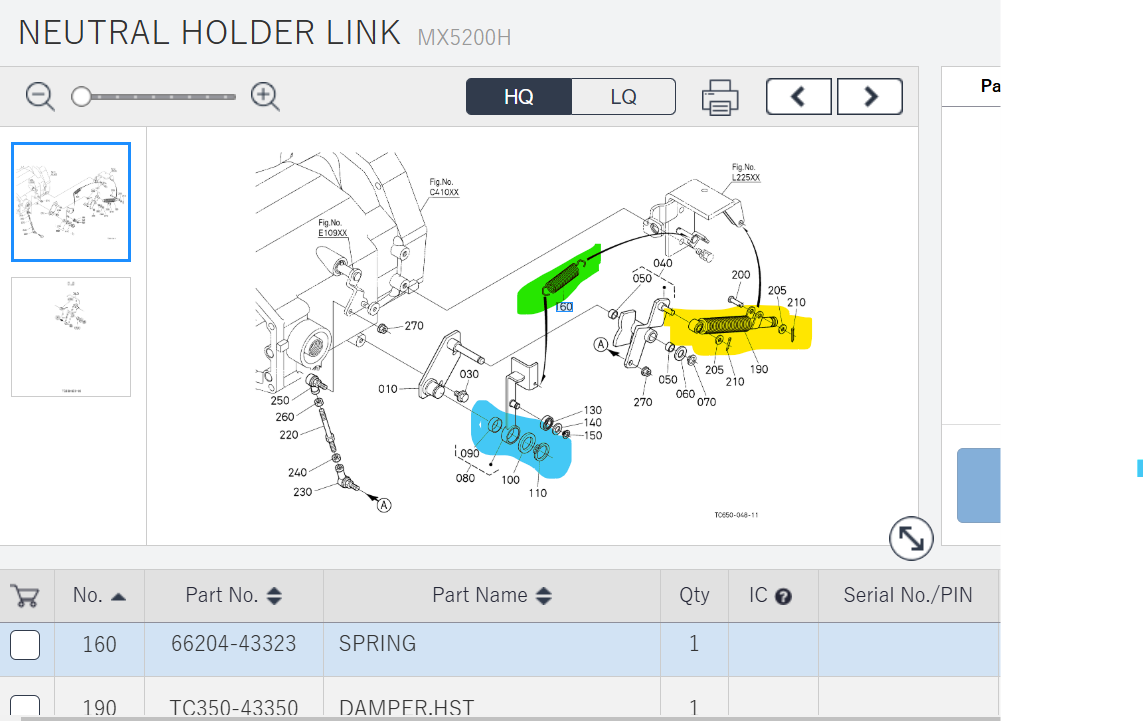

Thanks Wolfman, after adding utd it seems to be working normal again. i talked to the dealer about the HST and he agreed it most likely the Damper, Anyone know the part no for it. ive looked and looked with no luck and how hard is it to replace?
30,768
6,821
All super easy fixes:
Check this spring too:
Spring: Green
Neutral holder bearings: Blue
Damper: Yellow
