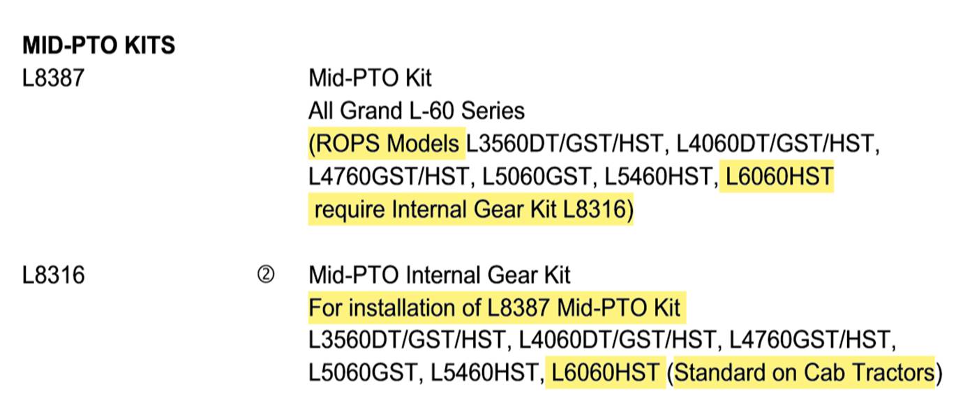

Judging by what I'm reading in the Jan 2016 wholegoods document the answer is that it needs a Mid-Gear (L8316, $248) when it is a ROPS model.
I believe installation of the gear requires the tractor to be split to install, but not 100% certain.
The Mid-PTO (L8387, $377) is very easy to install if its anything like the installation on a Grand L30.
The note for the Mid-PTO Internal Gear Kit states:
For installation of L8387 Mid-PTO Kit, L3560DT/GST/HST, L4060DT/GST/HST, 4760GST/HST, L5060GST, L5460HST, L6060HST (Standard on Cab Tractors)

See my post above. It is clear there is a difference between ROP's and CAB. Cab it is generally included and ROP's it is NOT included.

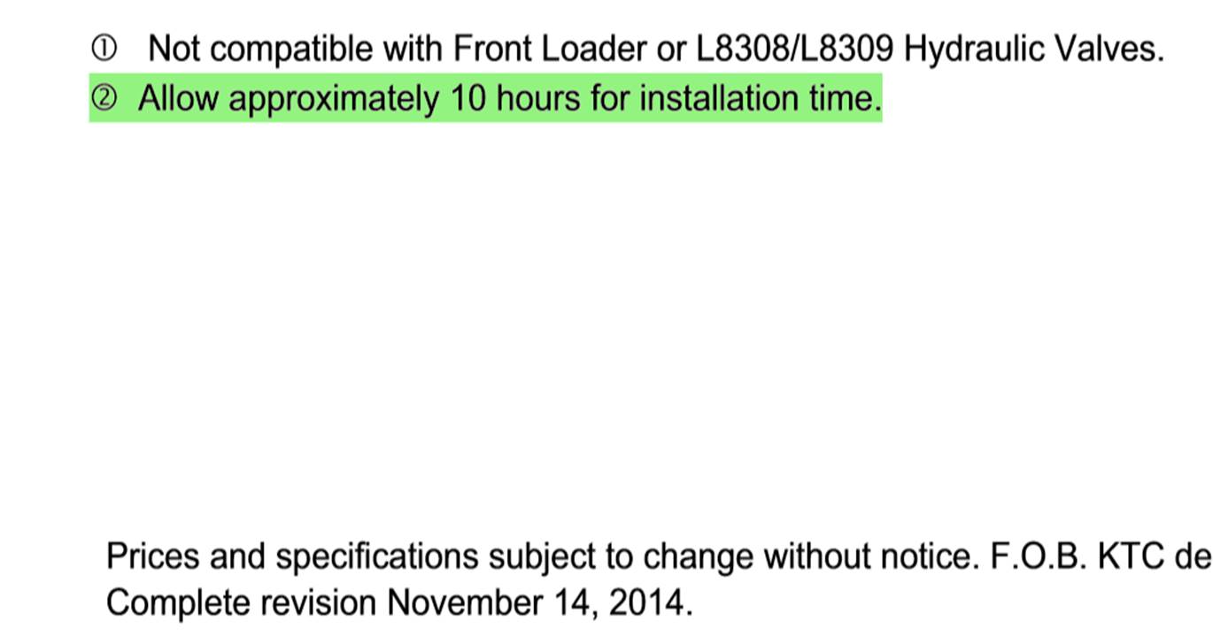

This should NOT be very difficult for your local dealer to figure out. The information in the Wholegoods document clearly spells out what is needed and points to a clear difference between CAB and ROP's models. Unfortunately the OP has a ROP's.
The attachments below are from 2014 so it is possible it is not 100% correct. Any Kubota dealer should have the latest and greatest and has the ability to contact Kubota technical for additional help if they are not 100% certain.
Please pay attention to footnote 2. It requires 10 hours for installation.
Hopefully the attachments will help provide clarity.

I was going to say, on ROPS models (no cabin), they allow approx 10 hours for installation, so that typically means "split".

Checked with the techs at the dealership today and as the other posters said, cab model no problem, just bolt on, but rops have to split.
