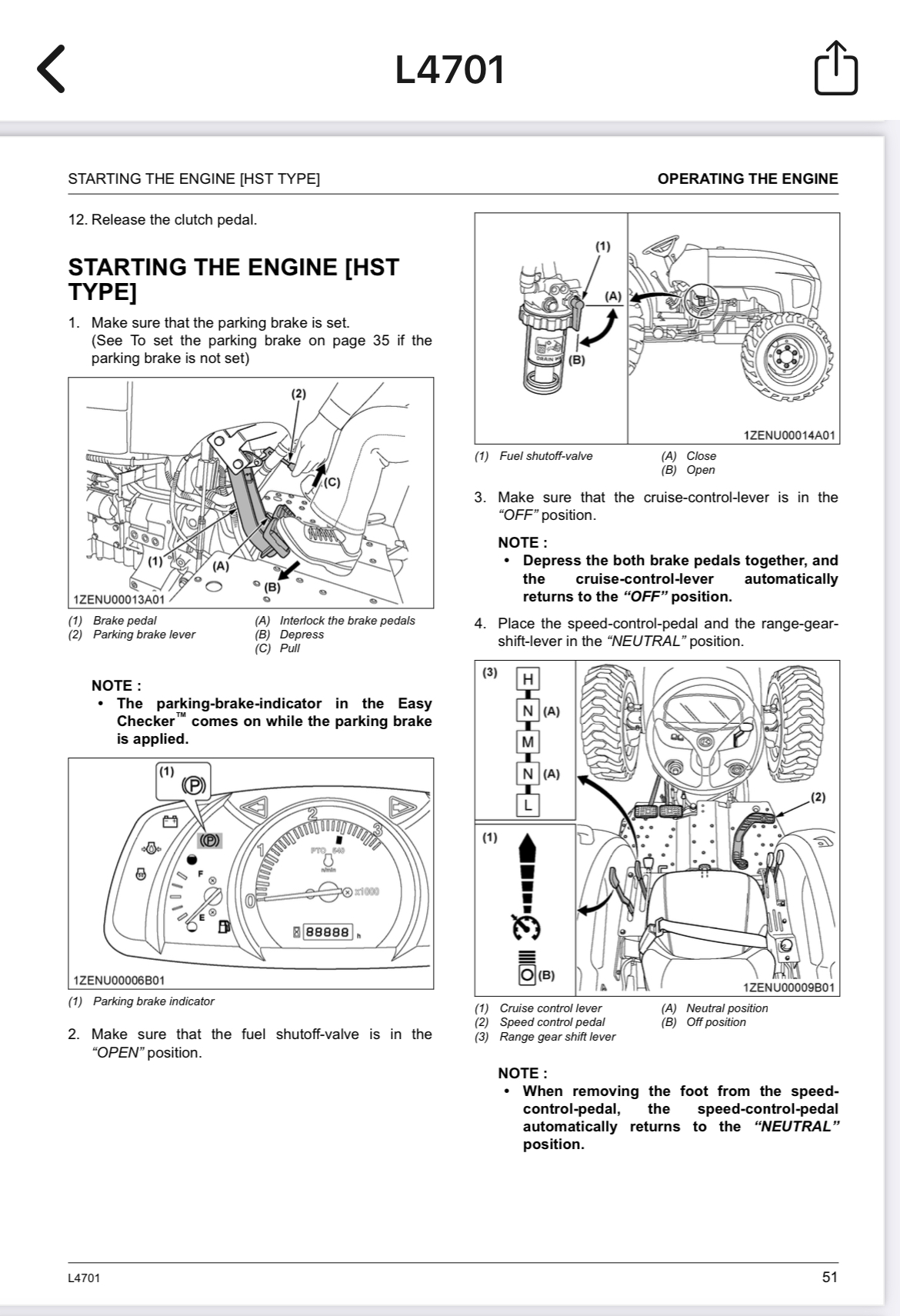

Your profile shows you’re in El Cerrito. It’s not particularly cold there. Highly unlikely it’s cold enough it should need glow plugs to start.
OM doesn’t instruct use of glow plugs in temps above 23F. Admittedly, I normally park mine in a building that varies from about 58F to 65F. At those temps I have never needed glow plugs to start it. Left it out overnight in the low 20’s once, totally forgot to glow it, and it started running rough but started. Smoothed out after a couple minutes.
Point being, even if glow plugs aren’t working at all, it should start with no issue if it’s over about 40F. If it wouldn’t, it had real problems before starting fluid. Addressing the issue with starting fluid was putting out a fire with gasoline.
For those who may not believe the “start without glowing” thing, the salient pages from the OM are included below.
