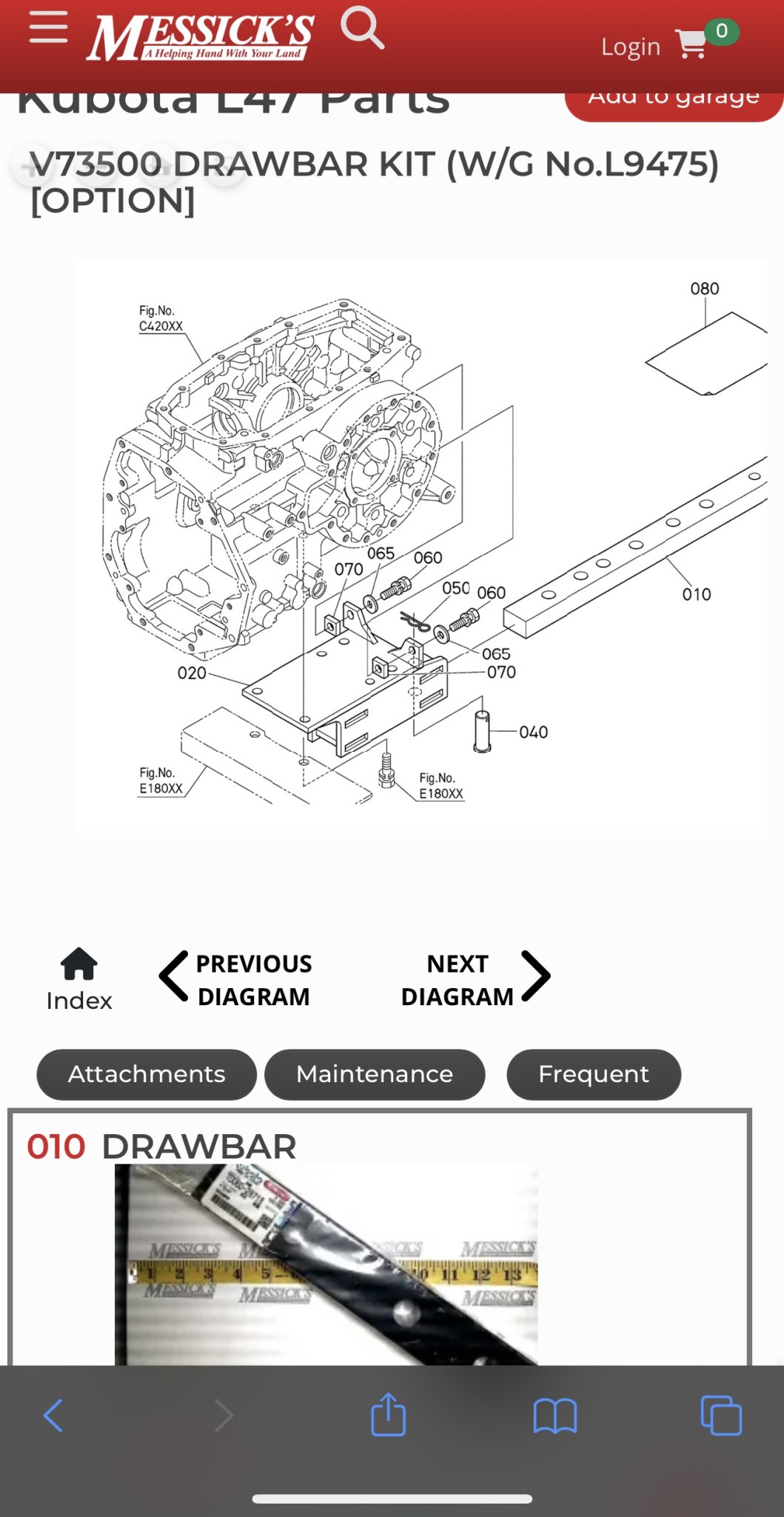

I recently dropped by BH and set up my 3 pt hitch on my L47. Today I was getting things adjusted and decided to see how the new drawbar fit. Well, either I am an idiot, or there is no mount for it. Does anyone have a pic of the back of their L47 without the BH on? Thanks! L47 3 point.jpg

Can’t help with a pic of it, but looking at the parts it is listed under options

Thank you, sir. I looked at parts diagram, couldn't find. I guess I didn't ask the right question!

I believe that both the 3pt hitch, and the drawbar were/are options.
I see that you do have the 3pt hitch.

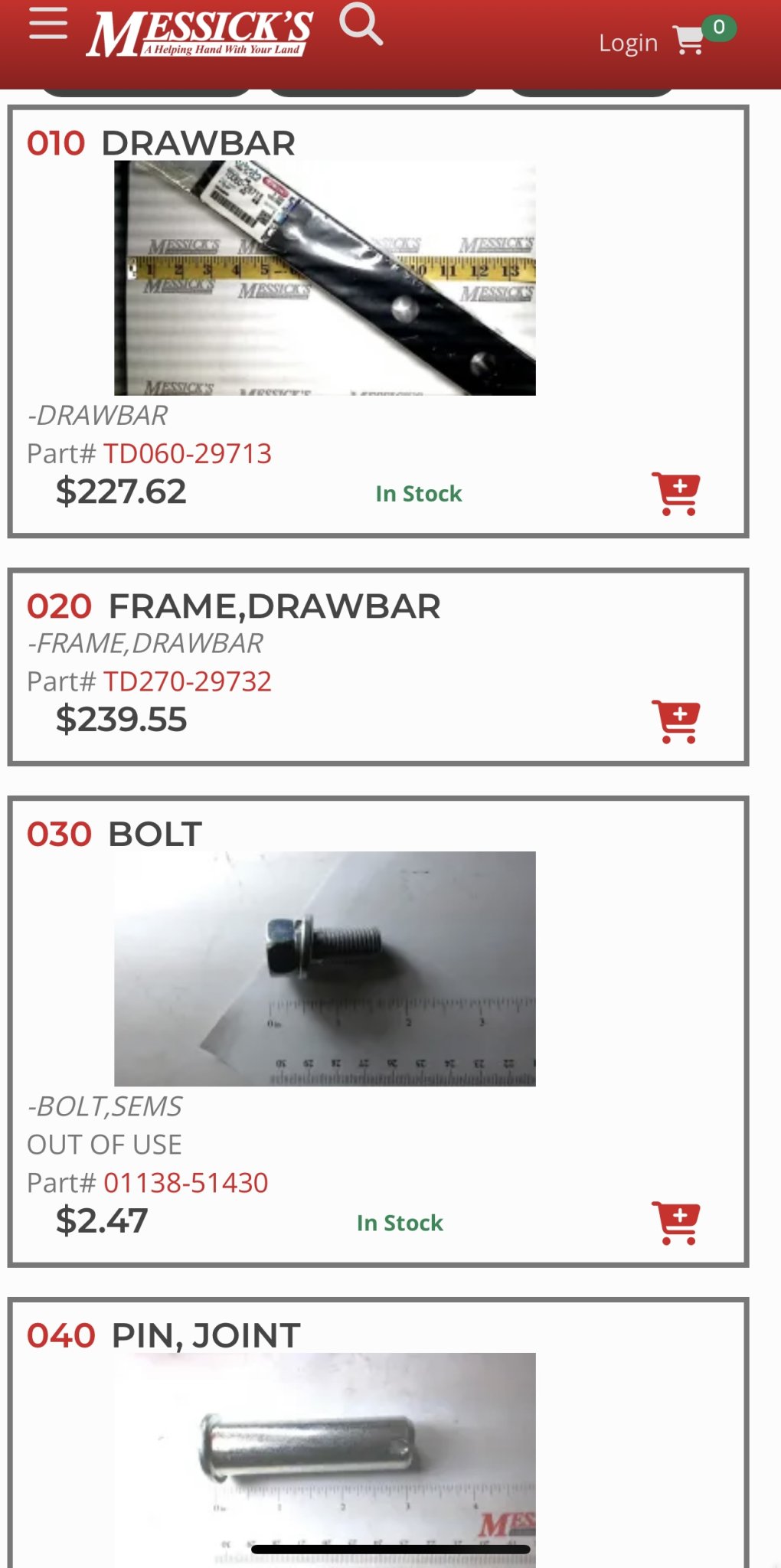

Buy the "drawbar kit" because it's cheaper than buying just the parts and you will have everything you need. You will need to add the base mount as the draw bar was an option on these TLB's.

Thanks, the drawbar actually came with my 3 point hitch kit.
