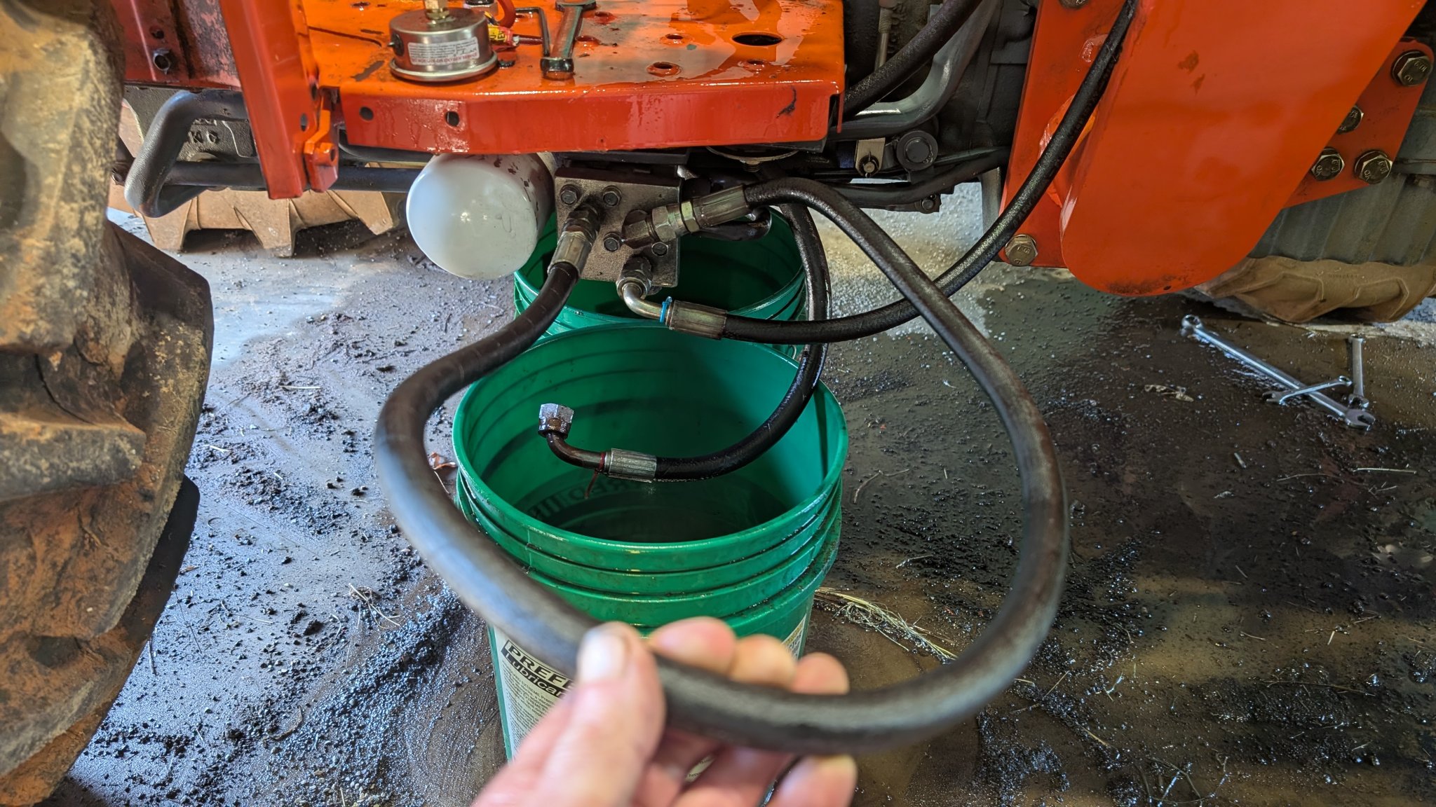

ike this? The 3 point does not work

There is no way to tell what is hooked to what in that picture. But it looks like one hose is bigger thsn the he others so I would say no.
The two top ports should be jumpered together with just one hose as shown below. That bypasses the the loader valve altogether.
Also, when testing the 3ot there should be nothing on it.

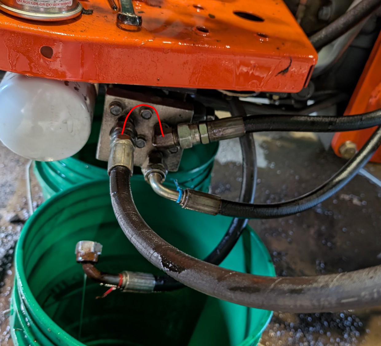

Those are the 2 I jumped, I'm a poor photographer . The 3 point has nothing on it

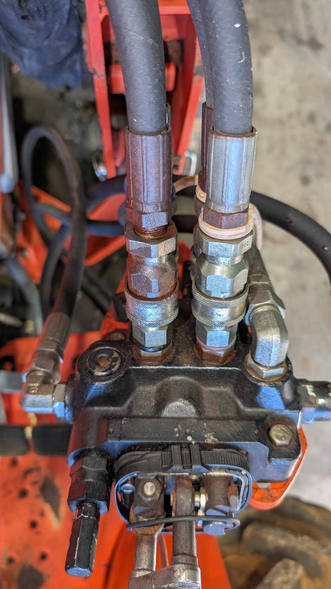

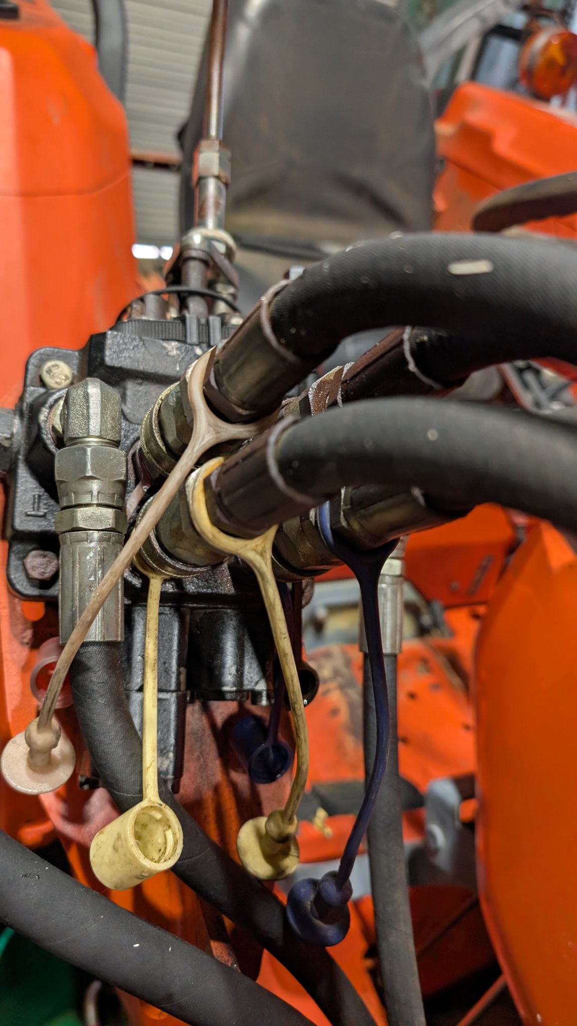

I have these 3 photos of valve from earlier. I'll get better distance photos and attach.
13,118
7,398

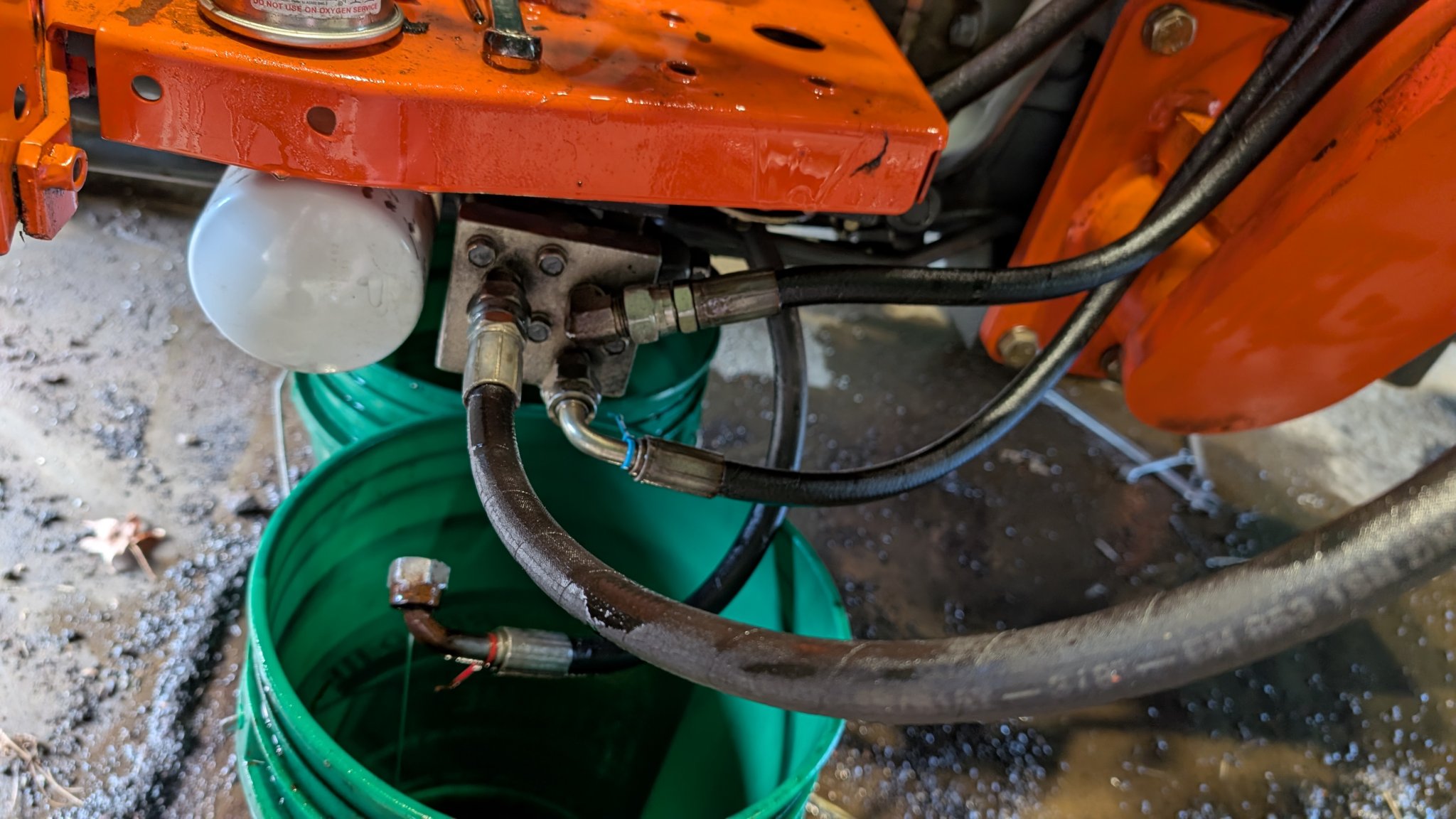

Thats good enough.
The port on the left side by itself is pump in. Connect it to top rigjt port on the outlet block.
The top port on the other side is tank return. Connect a hose to it but do not connect the other end.
The right side port below tank return is power beyond. Connect a hose to it but do not connect the other end.
Put the two unconnected hoses in a clean bucket and start the tractor. You should get oil from just one.
Immediately turn the tractor off and mark the hose that had flow as power beyond. Confirm it is the one connected to the lower port on the right side of the valve.

It is the lowe
Thats good enough.

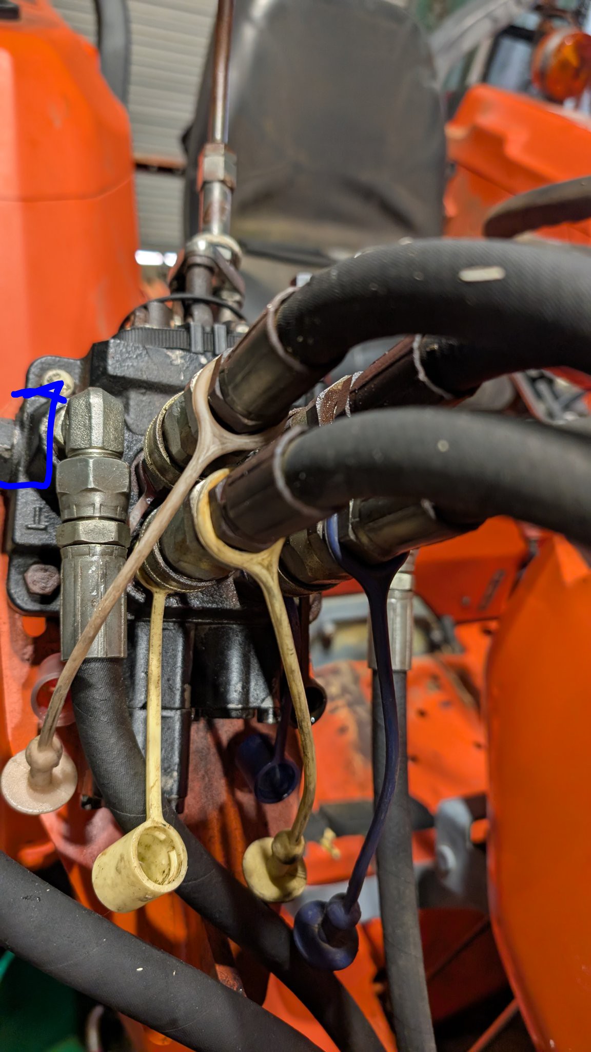

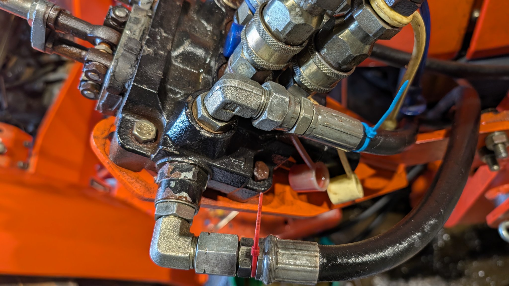

LoweR port on left side that has flow. That is power beyond, yes?
13,118
7,398

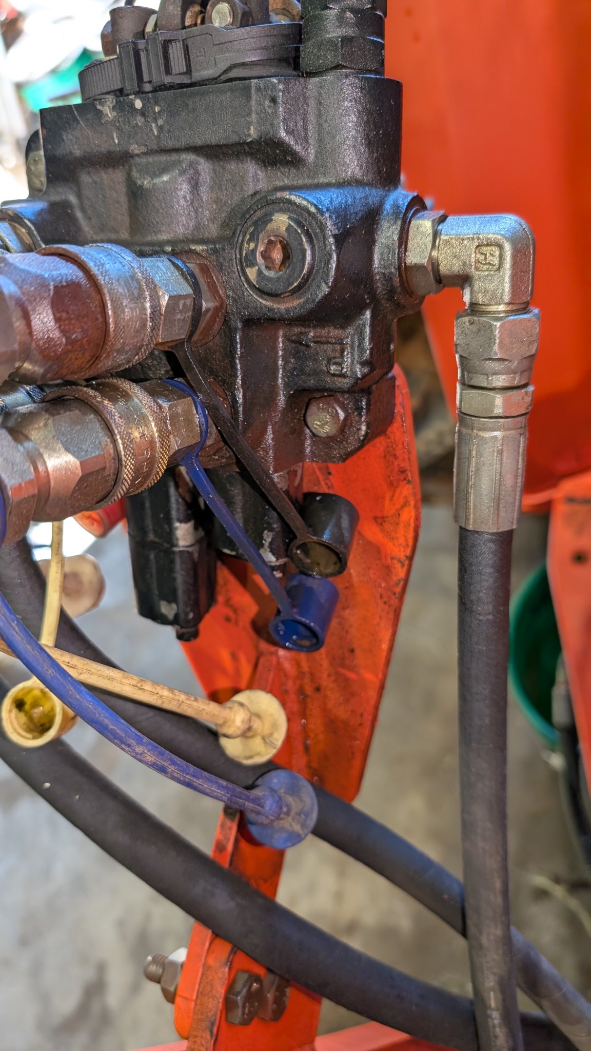

Sitting in the seat the power beyond shoukd be the port on the RIGHT side. That port is cutoff on your pucture but if you look at the area I highlighted in blue I think you will find a ID cast into that boss.
bsamot69
M9000, m9540, m6060, L4400, SVL 97-2
Jul 31, 2018
152
Grapeland, Texas
I don't see a stamp, this is photo showing connection.
