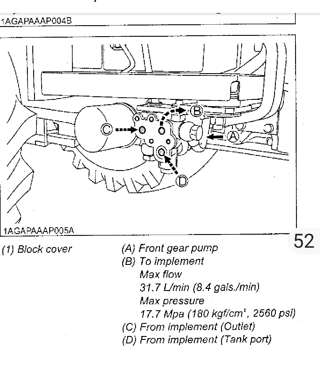

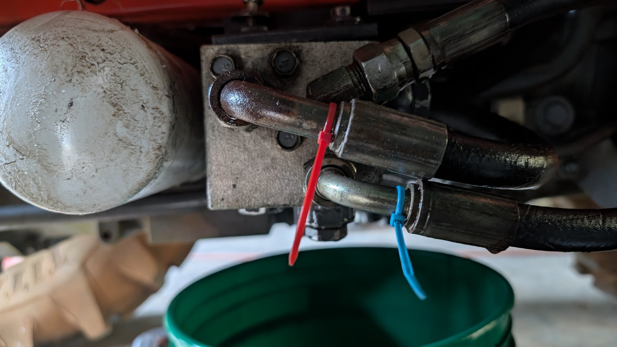

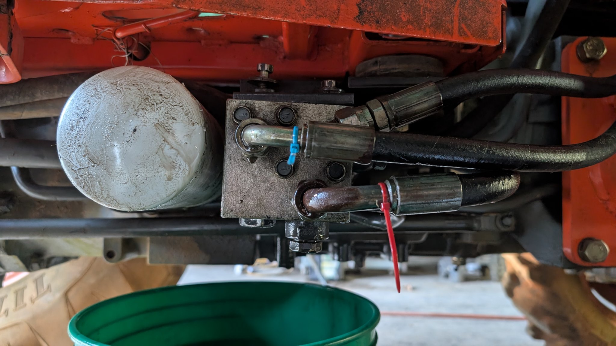

BEFORE doing anything put identifying marks on the loader hoses connected to ports C and D on the hydraulic block. I would suggest paint or tape using RED for C and BLUE for D. Take a picture of the hoses with the identifying markings.
AFTER the hoses are marked swap the C and D connections and take another picture. Put the 3pt lever in the full down position, start the tractor, and test loader operation. After testing put the hoses back in their original locations.
Post the BEFORE and AFTER pictures and tell us what if anything changing the connections did to loader operation.
No change in loader operation
