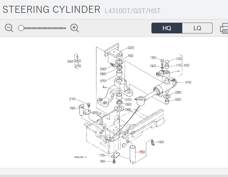

Hello,
I have a L4310 and I took off the steering ram as it was leaking. Took it to the shop to get it repaired, reinstalled and tested. Now if I jack up the front and turn the wheel it can go way way too far to the right and barely anything to the left. Any thoughts? The ram shaft end is fixed on front of frame and the ram body is fixed in the horizontal part of pitman arm so I’m at a loss. Additionally ram body seems to “lift up” even though I reinstalled everything.

Did the shop possible assemble the steering cylinder with the barrel reversed?

It's not possible to install the cylinder reversed or something? I always look for a way I could have screwed it up before I assume that someone who does it for a living might have screwed up. Not that they don't screw up, but it's less embarrassing if I start by assuming it was me somehow, then if it turns out it was me, I'm not surprised. :)

No, it only has the frame mount on one end. If possible I would have screwed it up but in this case I didn’t really have a chance haha
