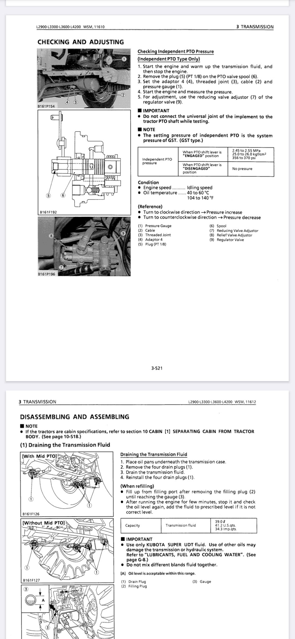

Ah ok, so the only thing I need to concentrate on is getting pto pressure up to 370? So the only adjustment i have is the allen screw on the regulator and if I can't get that high enough is there not a way of getting the pump higher? That's what my thinking was, if main pump is low then im trying to regulate a low pressure from the start.
I dont have a WSM for your tractor so I have not researched that particular system but main system pressure is 2500 PSI
Ostensibly the function of the PTO pressure regulator is to reduce that pressure to 350 PSI.

I just looked at the WSM for the Grand L40. It appears to use the same PTO design as your tractor and the hydraulic PTO clutch is supplied by the PS pump and pump mounted regulator valve. The clutch is operated by s PTO clutch valve mounted on the rear housing. Operator control is via a lever snd cable linkage.
There are numerous possuble causes including a malfunction of the PTO valve for your symptoms. I would like to know the reasoning the indie used to reach their conclusion..
I suggest you break out your WSM and start running the PTO tests described in it before spending big bucks on a new clutch pack.

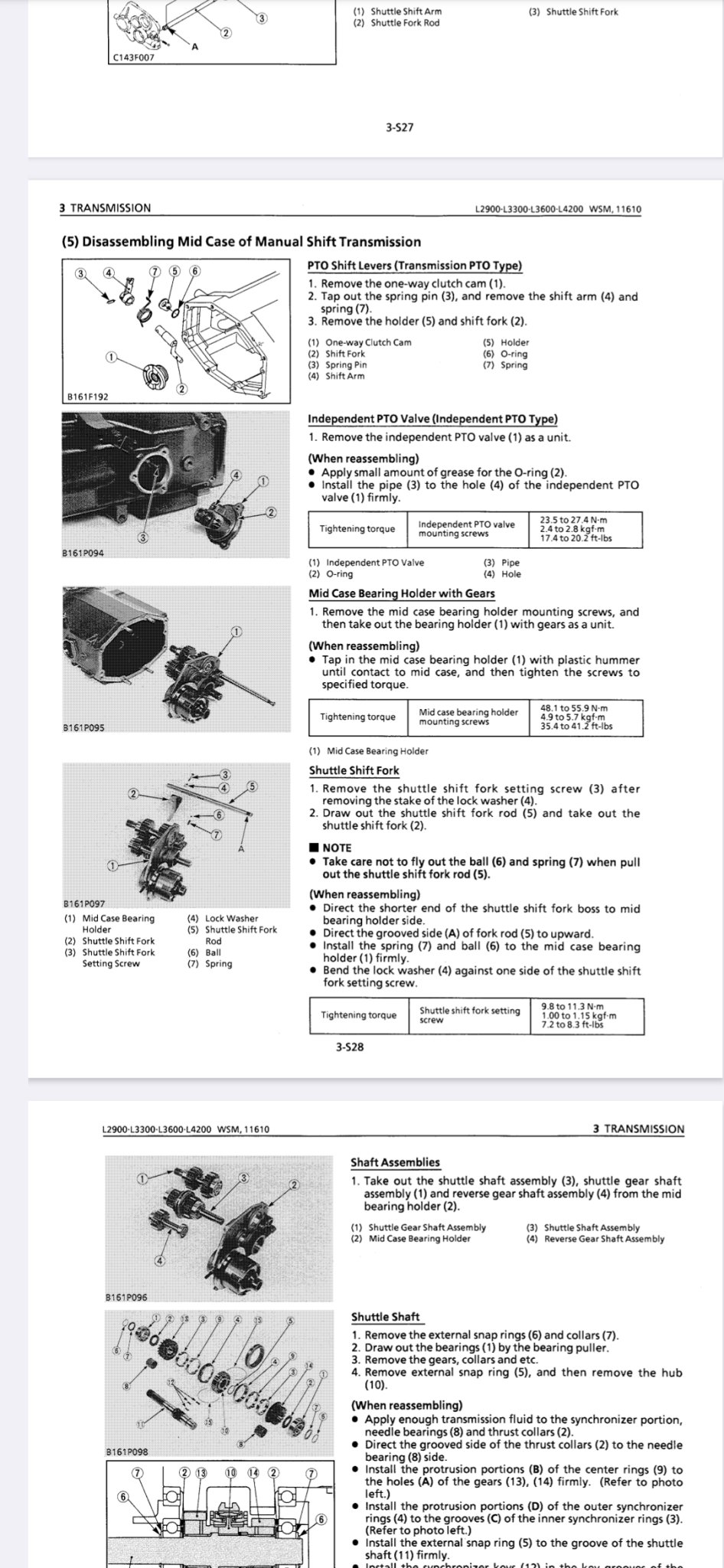

The PTO valve on the GL40 is more than a lever. The transmission mechanism section of the GL40 manual goes into considerable detail on how the the PTO clutch and valve work. The servicing section has diagnostics.
As usual the organization of the manual makes finding every thing relevant to your needs an exercise.
Ha, yeah and I think that's the problem I'm having. I was thinking of printing it and getting it bound so I can actually flick through it. Ok appreciate your help, I will do some more reading tonight. I mean correct pressure reading at the pto test port is a good start.

Ok so I've just hitched my little chipper up and it literally spins at 104 rpm. Bearing in mind I now have 370 psi at pto test port, what is the next test you would be doing?
Thanks
12,245
6,977
Thanks
I would be reading the mechanism section in the manual looking for insight into how pressure is applied to the clutch.
Mmm, I'm going through the manual now but I'm getting confused between pto and gst as there is a lot of info on gst but not a lot on pto. I know the two systems are combined to a degree but I dont want to be going down the wrong route. As you say I need to understand how the presure gets to the pto pack.
