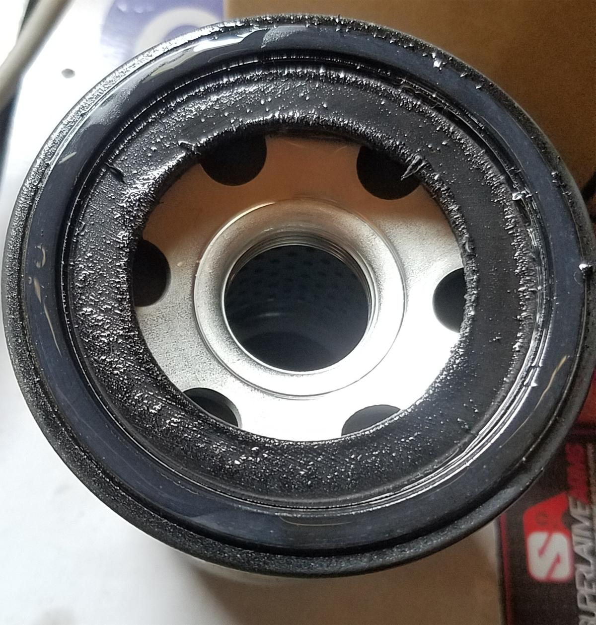

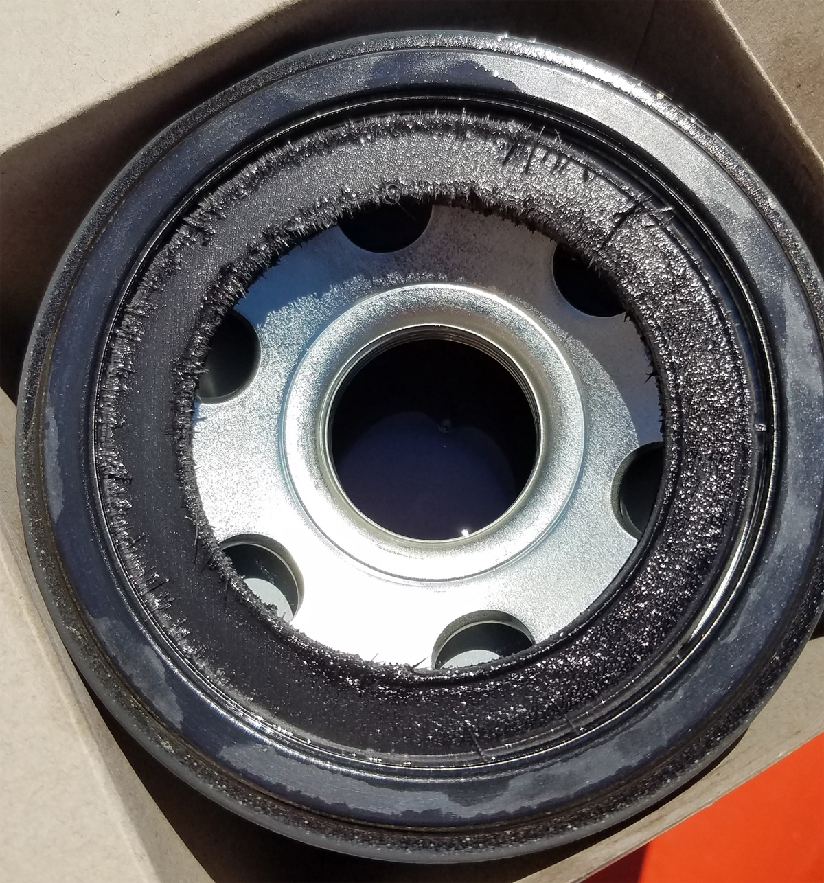

I've done the 50 hour service on two MXs now. I didn't use a vacuum cleaner to limit oil loss and didn't lose more than a quart or two both times. I elected not to change the hydraulic fluid at 50 hours.
Here's the MX6000HST hydraulic oil filter at the 50 hour mark.
And here's the MX6000HSTC hydraulic oil filter at the 50 hour mark.
