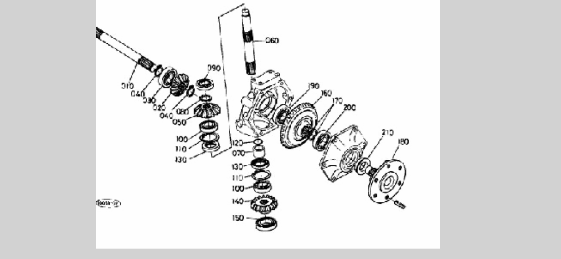

The bearing on the end of the axle shaft disintegrated and ruined the axle shaft and the housing that it fits in the small bevel gear that drives the larger gear on the axle also looks worn there doesn’t appear to be much ware on the larger gear on the axle don’t know whether to change that price I was given was $500 for the larger Gear

Is your tractor a Hydro, gear, or glide shift? Cab or ROPS?
Coleman Equipment price on the large gear (#160 in your picture) is $390.00, and (#140) is $146.00
If the gear #160 is not worn or just has a few marks on the teeth, just touch them with a hand grinder and take the burr off, run it.

Thanks that’s great information exactly what I was looking for I think I will use both gears again and just change the spindle and bearing and the seals and possibly the housing also where is Coleman equipment At?
