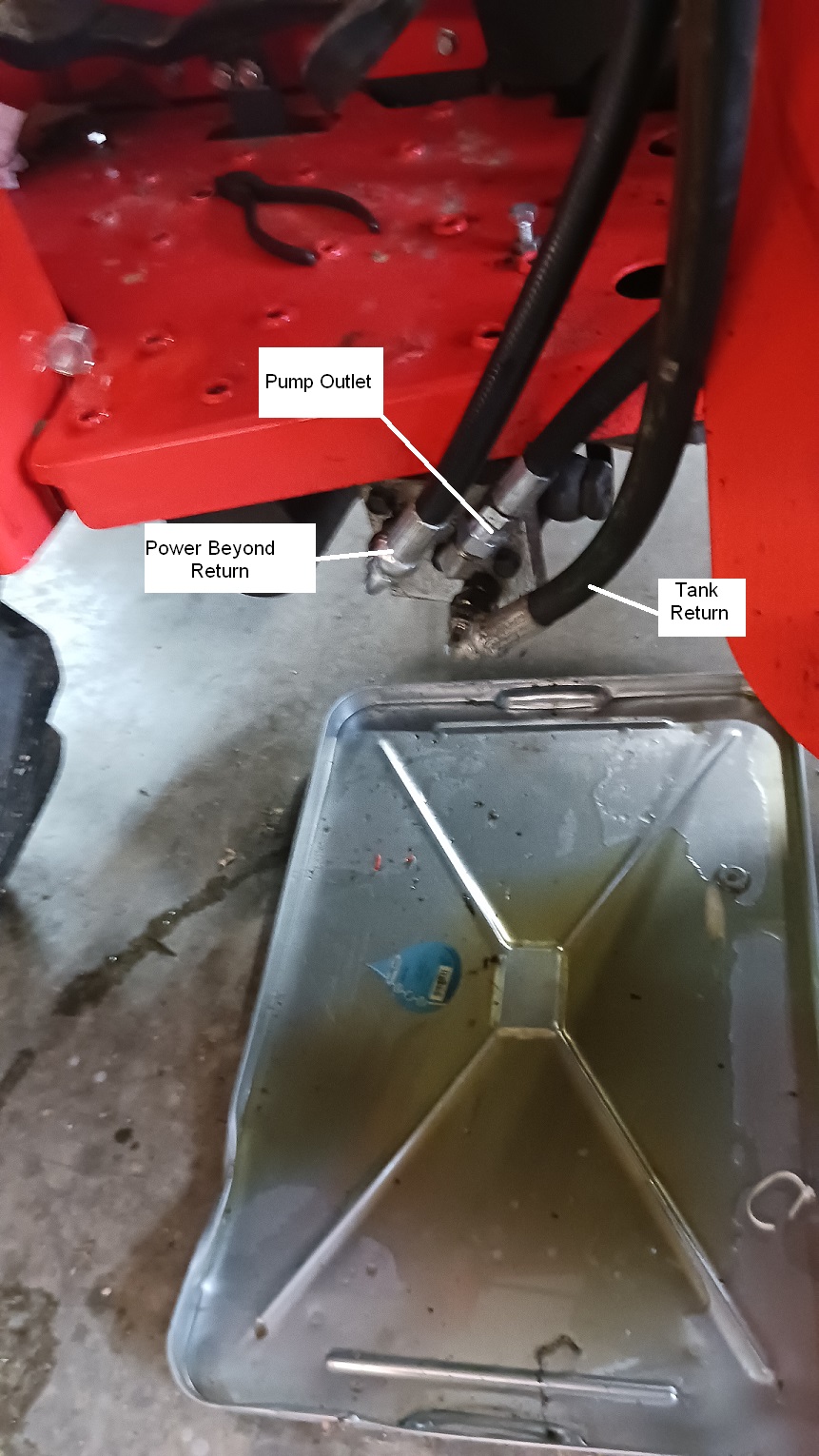

Here is a picture of the hydraulic outlet block on an L3901.
To test pump outlet pressure you can remove the hose connected to the port labeled Pump Outlet and connect your gauge directly to the port in the block. Alternatively you can follow that hose up to the loader valve, disconnect it there, and connect your gauge to the hose.
Once the gauge is connected start the engine and allow it to run just long enough to get a pressure reading. Do not allow the engine to run any longer than that. Disconnect the gauge and reconnect the hose.
Your pressure reading should be very close to 2400 PSI.

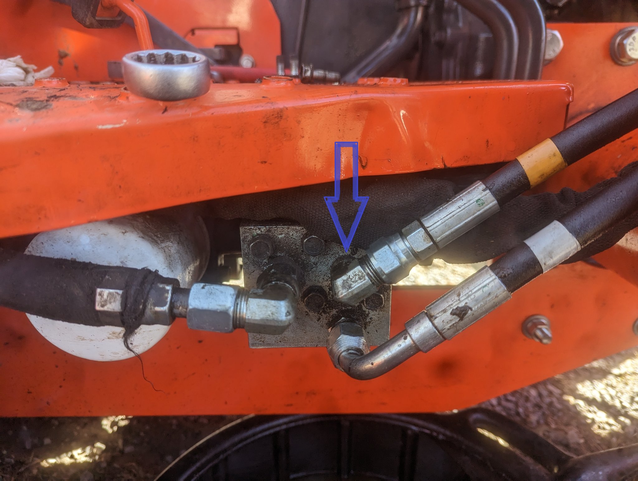

Yeah 2400psi is what it should be, manual says 2349psi if you want to be pedantic. I've been screwing around with it since 11 this morning, and after doing everything suggested, I still have no pressure. The pump is still moving some fluid but still doesn't register on my gauge. I took off the pump supply hose from the lower tube to double check that pump hadn't lost its prime, from what I could tell that likely isn't the issue cause the metal tube was full and the hose had fluid in it. I also turned it upside down so I could put oil in it and crank the engine over and see it suck the oil into the pump, which it did. hooked everything up and fired up to bleed any air that might be in the system. Still no luck, but I let it idle for a few minutes, after probably 3 or 4 minutes it started making the noise like a hydrostatic tractor makes when you're going up a hill in high gear. I broke out the stethoscope and it sounds like its coming from the power steering side of it. I appreciate the help from you guys though, I'll still keep updating until I get the problem fixed. I should mention that I'm a millwright so its not like I'm just blindly doing stuff without any reason. Again Cheers
I am with you - do not dissassemble things without a reason and good justification.
Just to help me understand please::
You removed the pump outlet hose shown in my picture and connected the 3000 PSI pressure gauge directly onto that port on the hydraulic block. No tees or any other connecton just gauge screwed into block.. Yes or No?
If yes you then started the tractor and the gauge showed what?

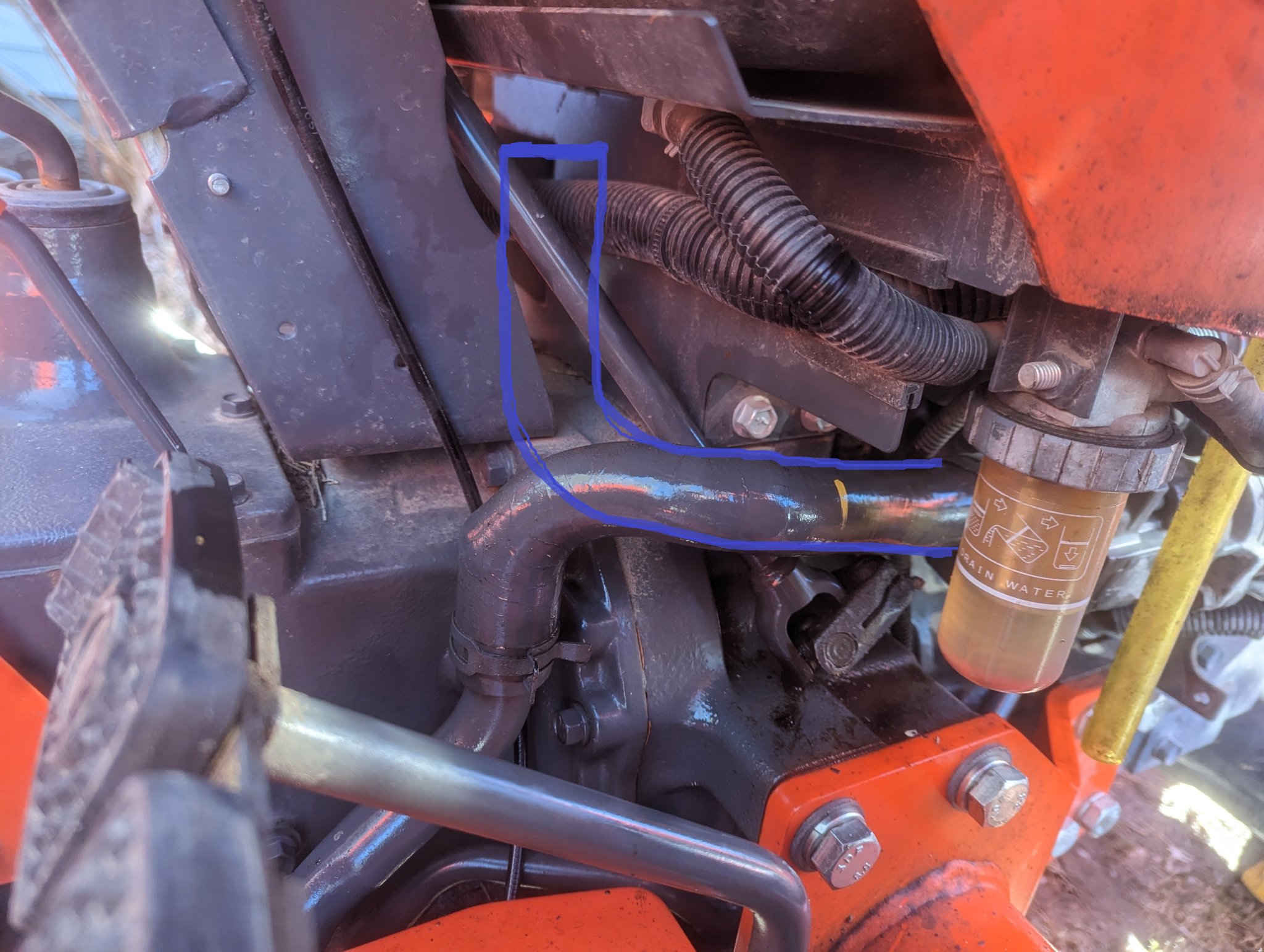

Also what I meant about the pump inlet hose was turn it so it looked like this
