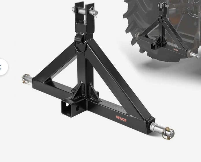

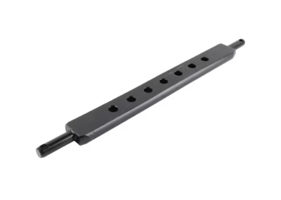

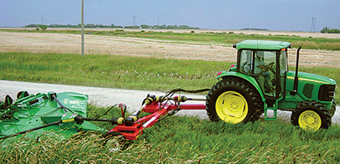

yes. easy to do and done all the time. I will get some pic.s for you.
depending on what you want to do and how you want to do it and your budget.
cheap and easy is adding a cat 1 draw bar on lower link arms about $50. add a ball or 2" reciever mount or whatever off set. they have locks available to stop it from rotating, etc...
or for about $80 one of these and add an horizontal offset head from a trailer shop
or if you have big bucks you can go with a hydraulic offset hitch made by someone like Ibex or handy-hitch that lets you swing your implement from your seat way out to the side to mow ditches, pond banks, near fences, etc....
so common and easy to do just pick your budget to match equipment and task.
View attachment 170153 View attachment 170156
View attachment 170154 View attachment 170157

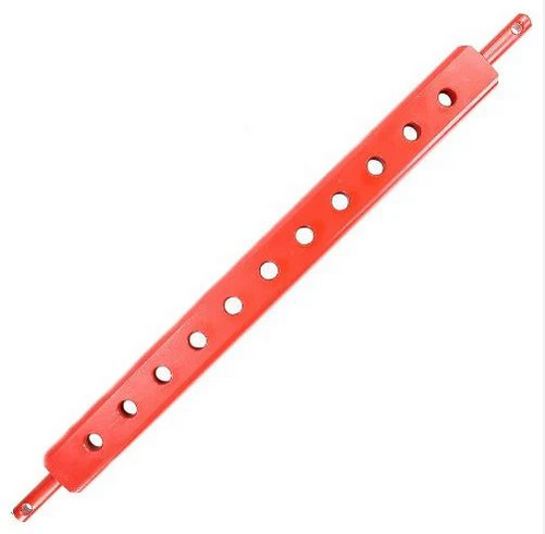

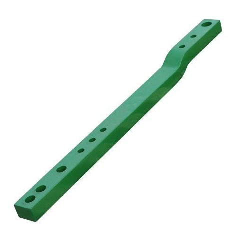

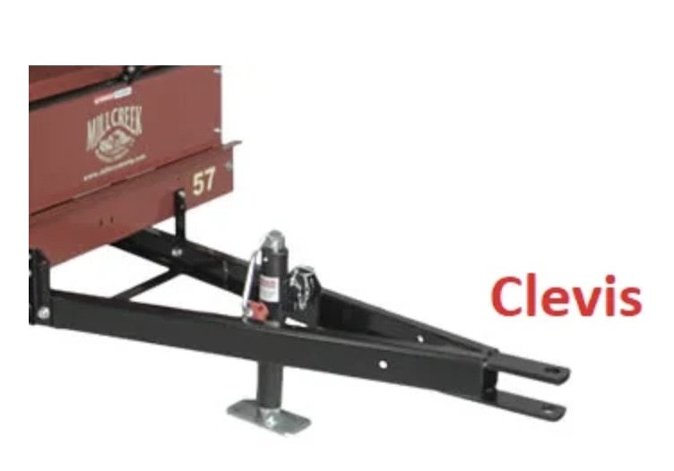

Those were designed (mostly) for pull type implements that usually had a clevis style hitch as shown here. You can see why that design of drawbar worked well for its intended use.

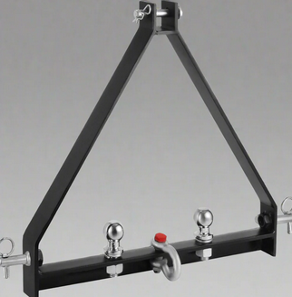

Add one of these two designs to it and it will become useful!
