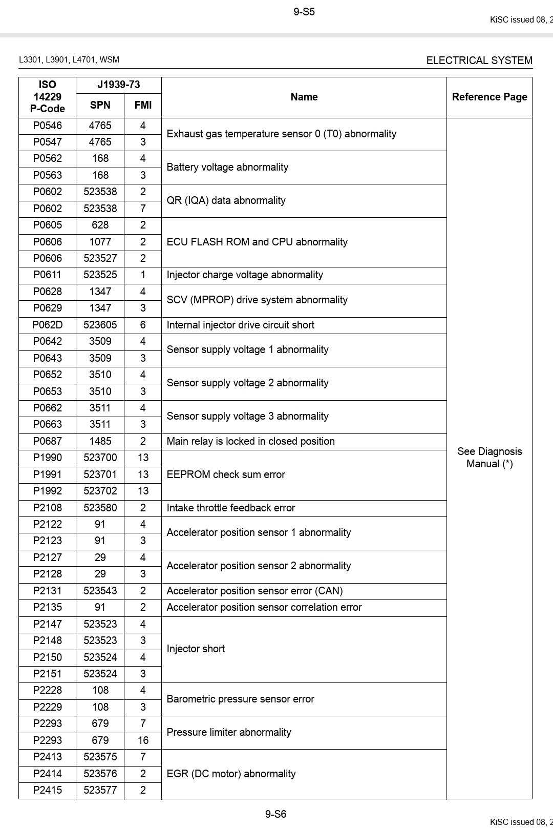

Other than the OP's original posting stating 3 codes are showing, P0606, PO627 and P0629 there has been no discussion as far as these codes. Might these codes not point to a possible solution if they are properly diagnosed?

That would be a good start. Unfortunately P0606 indicates an ECU problem so the SCV codes may not be definitive. I suspect Kubota techs have seen this combination more than once and may know the cause or where to go next. Short of throwing parts at it a scan tool is probably needed for additional diagnosis.

That being said, I would put my emphasis on getting the ECU and P0606 code situation sorted along with checking for any physical damage to wiring or electrical components.

As best I can determine, for a P0606 fault code:
A 1077 SPN indicates a fuel pump related problem.
A 553527 SPN indicates a problem with the CPU in the ECU itself.

Three faults appearing the same time?
I would focus on supply voltage, fuses, ground connections etc. A CPU or memory fault in the ECU is highly unlikely.
My friends tractor showed all kind of error codes and CAN bus faults when a fuse was blown due to a wire short. If we would have followed the work shop manual we would still be searching for the problem.
And yes, 100%, a good experienced Kubota technician will know what the fault is.

TSB-2023-035-E-R3
Issue: The engine may fail to start, and DTC code P0605 or P0606 may appear.
Solution: If DTC P0605 is present, replace the engine ECU with the updated engine ECU in the chart below for your unit per the Workshop Manual and complete a manual DPF regeneration per the Diagnosis Manual.
If only DTC P0606 is present, update the ECU Software to the latest software per the chart below for your unit and clear the DTC codes (The DPK file can be downloaded from the Machine Software page on K Service).
Warranty will cover for 8 years from purchase.
