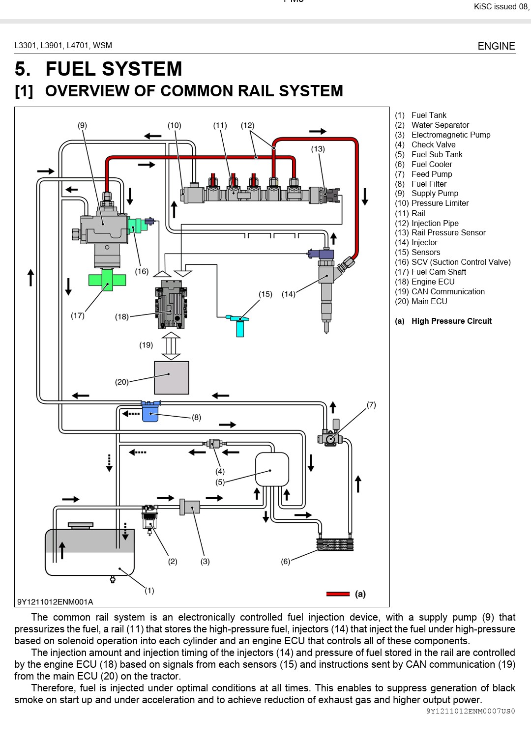

DO NOT REMOVE THE INJECTORS FROM A COMMON RAIL FUEL SYSTEM!!!!!!!!
It does not have an injection pump, and the injectors will only inject when the ECU tells them to.
If you do not fully understand the Common Rail injection system, do not mess with the injection components.
Messing around with this fuel injection system will result in a lot of whining about the $8,000 —$18,000 repair bill.
