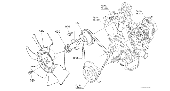

My belt is busted. I'm trying to figure out whether to try fixing it or haul to a dealer. There are 3 pulleys to stretch it over which is easy enough. But there is a shaft connecting the radiator fan to the engine block. somehow I have to get the belt over that so that the shaft runs thru the middle of the belt. I can't find anything in the shop manual other than "replace fan belt if it is damaged" (HUGE help! LOL) couldn't find any YouTube or other tips
so how much must be disassembled? better off trailering it?

Unless I am mistaken In the design Loop the belt over the top blades (and around the side ones), let the belt rest on the shaft and loop the bottom of the belt under the bottom blades. it should now be behind the fan and start running it around your pulleys

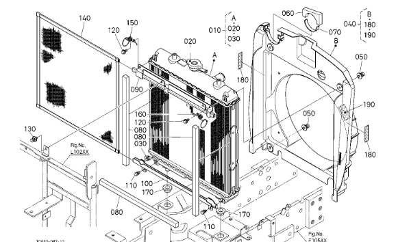

the fan has shroud around it. is there room to slide the belt between the shroud and fan?

There should be enough space between the blades and the shroud to slip it over or around each blade tip. You may have to turn the belt to slip the thinnest side of the belt through the gap (may be thinner side to side than top to bottom).
I doubt this needs mentioning but… make sure the key is not in the ignition so no one accidentally turns the motor while you are in there.

Often there is an adjustable pulley in the circuit whose job is also to provide a means of adjusting tension. Thats been my experience. I don't think stretching the belt is the best maneuver. Good luck and be careful.

not really BUT the blades are plastic and bend easy enough to slip the belt past. done several of them. Look for rodent signs as the belts often last a very long time, but rodents will often gnaw on them causing them to bust prematurely
