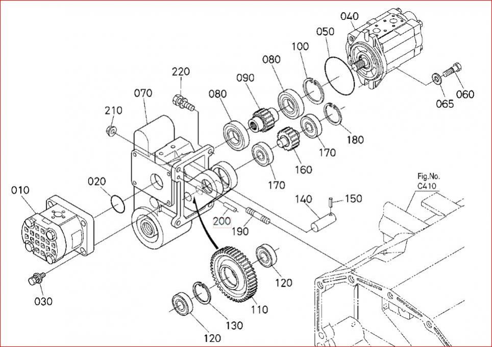

Both rentthis and 85Hokie are referring to the main hydraulic pump, but in this case both the main and the secondary pump are under the right side off the mid case, only model that I know driven like that, considering you have lost both movement and loader/backhoe control would suggest that the drive for the pumps has went out.
On other models this could be because it blew the mechanical clutch or because it broke a tooth or shaft on the hydraulic drive, In your case it can only be the drive as the Hydraulic pump is driven separately from the mechanical clutch by shaft #100 in yellow.
Start by pulling the drive off and checking for damage there. ;)
