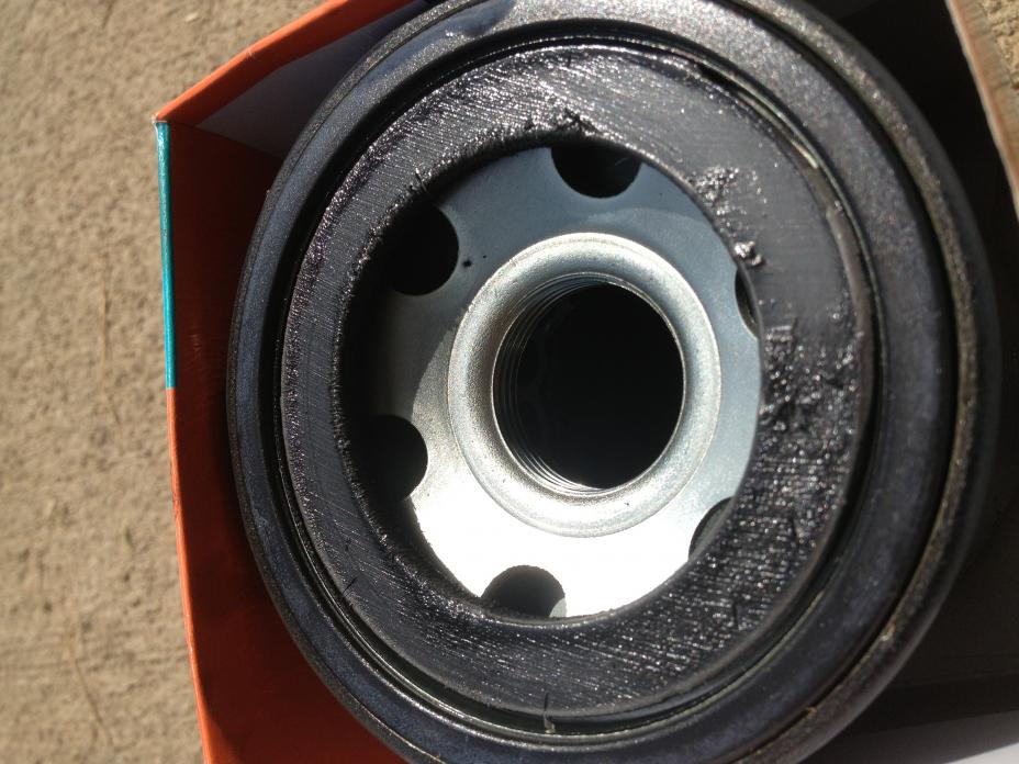

Done my service today at 49hr. Changed all fluids but the coolant and all the filters. I also added the second optional air filter. I went with the Super UDT2 fluid. Pretty straight forward and watching the L3400 50hr service video on Youtube helped a lot. The front axle takes FOREVER to drain.
Seeing this junk on the magnet of the filter made me glad I changed all the fluids at 50. Maybe there was none of this left floating around, but I sure feel better knowing I changed the fluid anyway.

Number9, I'm glad you posted those pictures. I hope everyone who thinks the full service at 50 hrs isn't neccessary takes a close look. That is exactly why I say the first service is the most important of the tractors life.
I guess your bota has a smile on the grill tonight.

Wow, I did my service yesterday too and I didn't have anything near that on my magnet.
I'll post a picture of mine after I get up and get into the garage.
Benhameen
2012 Kubota L3800 HST W/FEL and 1963 JD 2010 row crop utility
Jan 27, 2013
713
136
Southern IL.
Here is what came out of mine. Not near as much as I thought and I went past the 50 hr mark.

Just curious, what did your filter with the magnet look like? Anything like number 9's or more like mine and bluegills?

@Benhameen...I just changed all my filters yesterday and I had nothing like what #9 had. My filters looked like yours and Bluegill. Hardly anything on it. Granted all I'm doing is cutting grass with a finish mower and bush hogging so it may not be getting quite enough of a beating.
