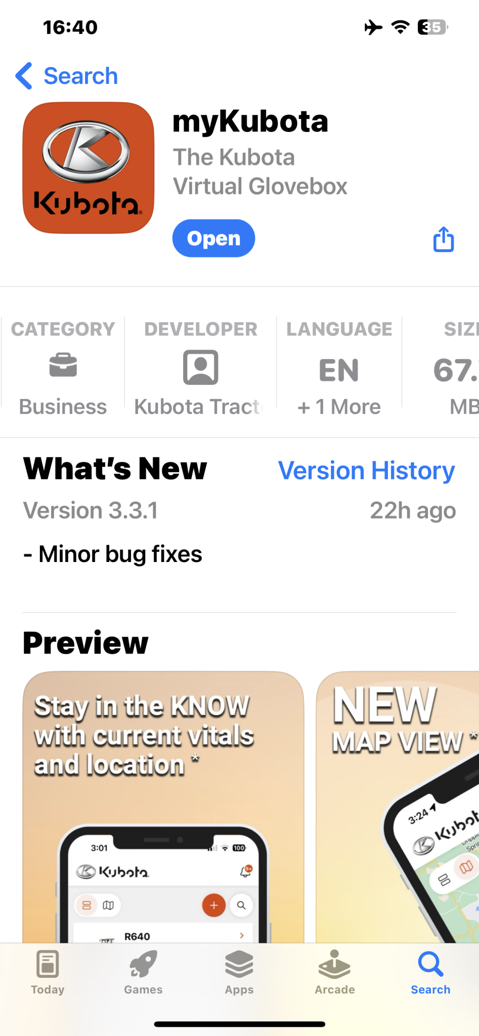

Check out the myKubota app for Android or iPhone in their respective stores. They have operating manuals for tractors and Kubota add-on’s like the fel, mowers, etc. I use it to track operating hours and log maintenance. 👍
