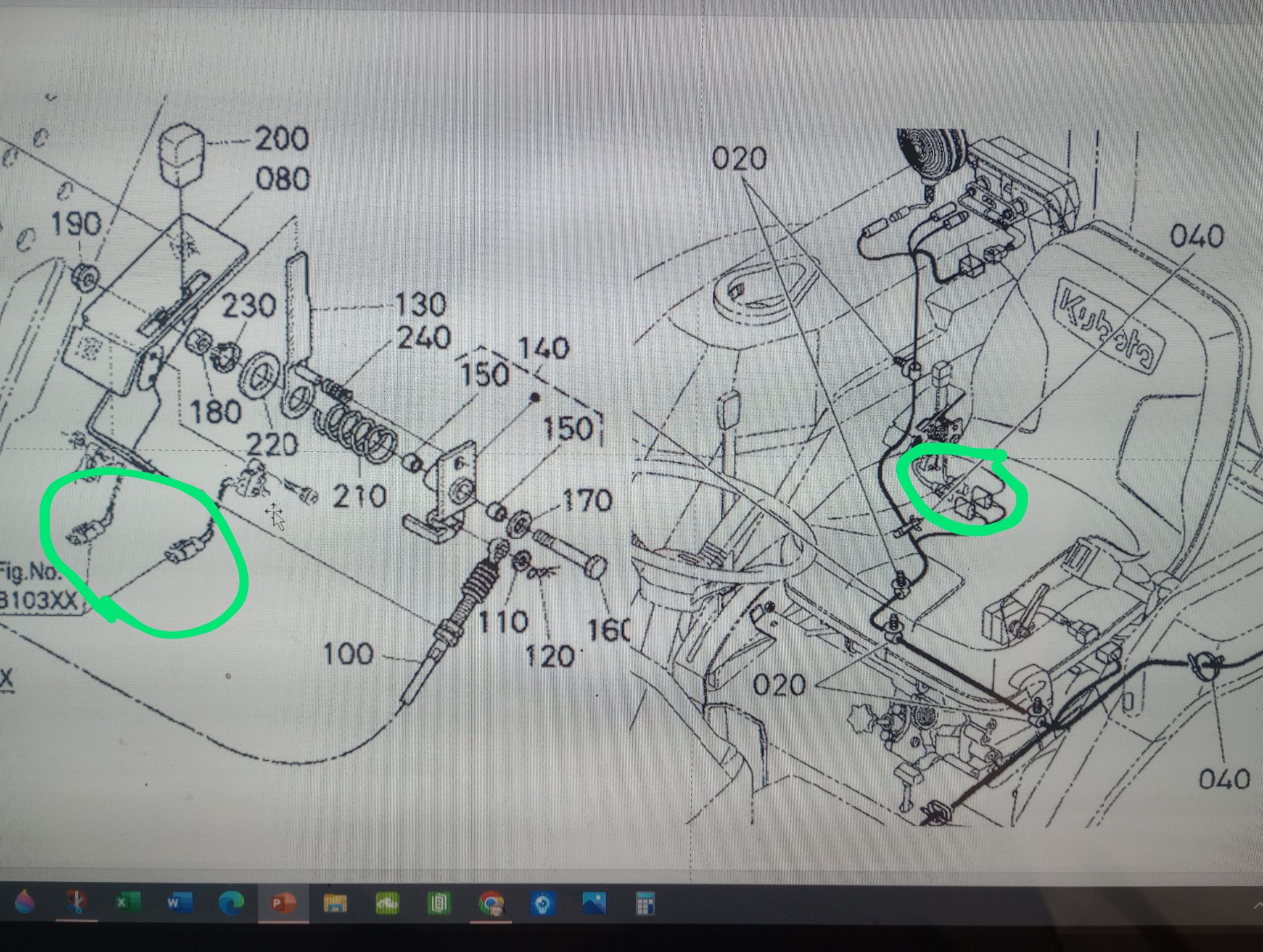

Okay so I think we've found the problem. We found that under the PTO lever there are two "switch levers" part number T1060-43900 and they are black mechanisms with blue wires with red dashes on them with white connectors. They depress a small button on each of them with a little metal flat s curved plate. And when looking at them there was mud dobber debris in them and they couldn't work proper like. If cleaning them doesn't do the trick I will order them for $30.54.

So we found out it was not the PTO switch levers that have harnesses that plug in just under the lever of the PTO. We are now thinking it's the OPC timer relay up under the bonnet on the L bracket.
We've been thinking it's partially grounded because it would show lots of resistance and then would show it was grounded because the reading kept changing.
It's like there is a partial ground up to the front heading towards the kill stop solenoid from the opc or the opc is what is killing the engine.
