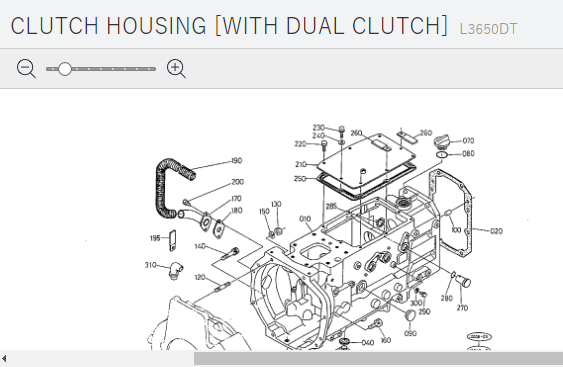

This is a photo of the page from the mechanics manual; we think the problem is around the area of 2 in the photo.
In one of the photos my finger is pointing to where it does not seem to be connected.
Our question is "what is the best way of getting into that area to see what is happening"?
Boyd my mechanic is very capable of completing this work once we know the route to take.
He thinks there may be two options, break the tractor in half and perhaps down through the steering column?
Do you think that 2 in the drawing might have broken between where it connects to 4 or the part that's held in place by the roll pin? Or the roll pin may have broken? Any other idea's about what this issue might be and how to access to fix?

Just pull the top cover of the clutch housing (#210), and if you still don't see what you need to see, pull the steering column.
