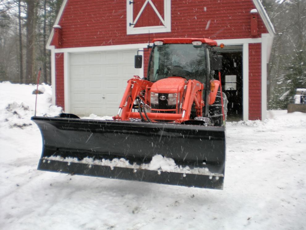

I have an L3560HSTC that just fits in my barn. The height is the main reason I went with the 3560. I have had open station for years and finally bit the bullet for the cab because I HATE cold and snow, also the bugs don't bother me now and not only is there heat, there is AC. I looked at the 4060 and the 4760, but the 3560 was the only one to fit my barn and that is by just under an inch.
