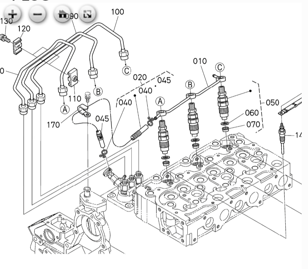

You should not see fuel come out of the screw, it is a vent and a hose routes any air or fuel that bleeds out back to the tank. The diagram below is similar to the L35, there should be short hoses running from the jet valve to point A, A to B, B to C, and C to the fuel tank.

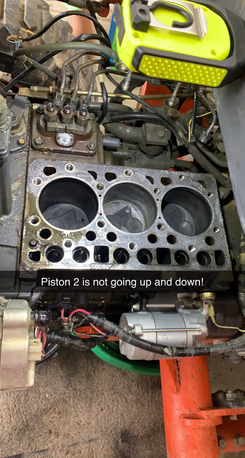

Thank you everyone for the comments. Cylinder 2 is dead. All signs showed it was making no compression, and that the piston was not moving. So we pulled the head. Turned the engine over and cylinder two piston does not move. Threw a rod!
Now our question is, can we access the rod and rod bearing from the pan? Or does this engine require you to split the tractor? Suggestions are warmly welcomed.

Yes you can pull the rod and piston from the pan, but if there is any damage to the crank that will require the engine to be pulled.
You would not need to pull the fuel cam, on that engine.
It's more than likely just the throttle control plate will be different.
