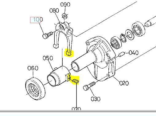

My two cents since I was just had an L apart, the TB slides onto the input shaft, then it has two clips on the fingers of the rod lever pivot, if you don't get the clips in the proper slot the TB will ride in front of the fingers not in correct position, and I surmise would make the clutch foot lever very tight since the TB would be jammed into the PP when the two halves were pushed back together.
28,820
5,188
That model has clips that keep the clutch fork aligned with the throw out bearing, if they popped the clips off then it is out of alignment.
